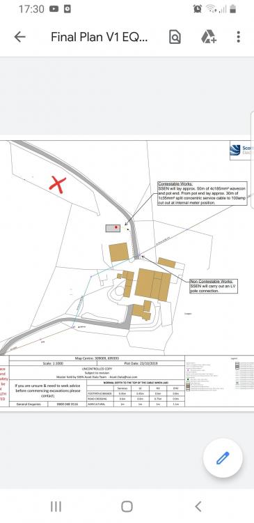

Jeremy Harris Posted October 8, 2019 Posted October 8, 2019 10 minutes ago, Amateur bob said: so its easy enough just to connect a new pipe and put it round property then rejoin? Pretty much, yes. You need to keep a fall on the pipe, but that's not usually much of a problem in a field. Field drains are designed to be "leaky", so there's nothing to seal up. 10 minutes ago, Amateur bob said: out of interest you wouldnt happen to know the cost per m of electric cable? i have a better site potential elsewhere but its 400m away from electric and id have to dig a trench through the middle of an arable field Depends very much on the size of the cable and the type of supply. Generally it's cheaper to go overhead than underground. Most of the cost will be digging the trench, laying the cable and making good, rather than the cost of the cable. The cable will be supplied and connected by your DNO, so they will be in control of that cost, although you should be able to get the trenching and making good done by any competent ground worker. You really need to ask your DNO for a quote, as sometimes there can be nasty surprises, like if the additional load from your connection is going to require the DNO to reinforce the local network. They will pass this reinforcement cost on to you, unfortunately.
Amateur bob Posted October 8, 2019 Author Posted October 8, 2019 5 minutes ago, JSHarris said: Pretty much, yes. You need to keep a fall on the pipe, but that's not usually much of a problem in a field. Field drains are designed to be "leaky", so there's nothing to seal up. Depends very much on the size of the cable and the type of supply. Generally it's cheaper to go overhead than underground. Most of the cost will be digging the trench, laying the cable and making good, rather than the cost of the cable. The cable will be supplied and connected by your DNO, so they will be in control of that cost, although you should be able to get the trenching and making good done by any competent ground worker. You really need to ask your DNO for a quote, as sometimes there can be nasty surprises, like if the additional load from your connection is going to require the DNO to reinforce the local network. They will pass this reinforcement cost on to you, unfortunately. ive a digger so could dig trench if that helps but wats a rough cost for cable?

Redoctober Posted October 9, 2019 Posted October 9, 2019 22 hours ago, Amateur bob said: i have a better site potential elsewhere but its 400m away from electric and id have to dig a trench through the middle of an arable field WOW - 400 Metres away from the pole! Not sure of the cost of cable but I do know that Scottish Power who dealt with our Electricity were happy to supply 50m of cable within their quote for us in order to get connected. The Engineer went on to say anything over and you are "talking big money"!! Also, there is a member or two on this site who has had expensive experiences with energy supply issues. Tread very carefully would be my advice.

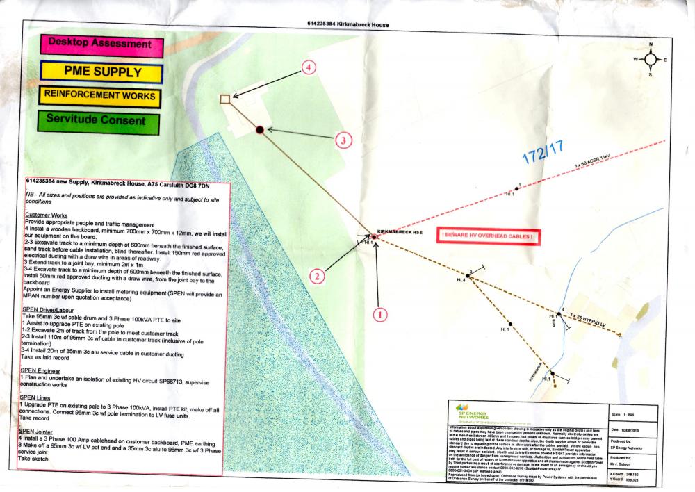

Bitpipe Posted October 9, 2019 Posted October 9, 2019 On 08/10/2019 at 14:14, Amateur bob said: ive a digger so could dig trench if that helps but wats a rough cost for cable? So, I'm no expert, but these people are https://www.elandcables.com/cables/spen-cable so call them and see what 400m would cost - they should be able to figure out what your DNO would use and the rating for a domestic supply etc. You'd also need 400m of approved ducting as the DNO cable is not armoured. Now, not sure if this is at all relevant but if you were running armoured cable (known as SWA) that distance then looking here https://www.clevelandcable.com/calculator.php and plugging in 100A for supply (typical domestic) and 3 core armoured underground requires 185mm2 cable. Over here https://www.superlecdirect.com 400m of 185mm2 cable would come to just under £18k ex VAT. So not cheap.
ProDave Posted October 9, 2019 Posted October 9, 2019 What supply infrastructure is in the area? If it's a typical rural 11KV overhead network it might be cheaper for the DNO to run an overhead spur from the nearest 11KV line and your own pole mounted transformer. Whatever, the best way to find out is ask them for a quote for a supply to the house site.
Amateur bob Posted October 9, 2019 Author Posted October 9, 2019 1 hour ago, ProDave said: What supply infrastructure is in the area? If it's a typical rural 11KV overhead network it might be cheaper for the DNO to run an overhead spur from the nearest 11KV line and your own pole mounted transformer. Whatever, the best way to find out is ask them for a quote for a supply to the house site. i was on sp energy networks there to get a quote but it looks like i could be charged just for the quote? i was under the impression quotes were free?
recoveringbuilder Posted October 9, 2019 Posted October 9, 2019 25 minutes ago, Amateur bob said: i was on sp energy networks there to get a quote but it looks like i could be charged just for the quote? i was under the impression quotes were free? Quotes are free, I don’t think they’ll do overhead now though, we had just under 400m if I remember correctly and they wouldn’t entertain going overhead, said it all had to go underground now
PeterW Posted October 9, 2019 Posted October 9, 2019 400m overhead will be 10 poles on 11kv plus a transformer. Budget for £2k per pole, £500/50m cabling and £10k for the transformer ... I’d be moving the house closer to the services.
