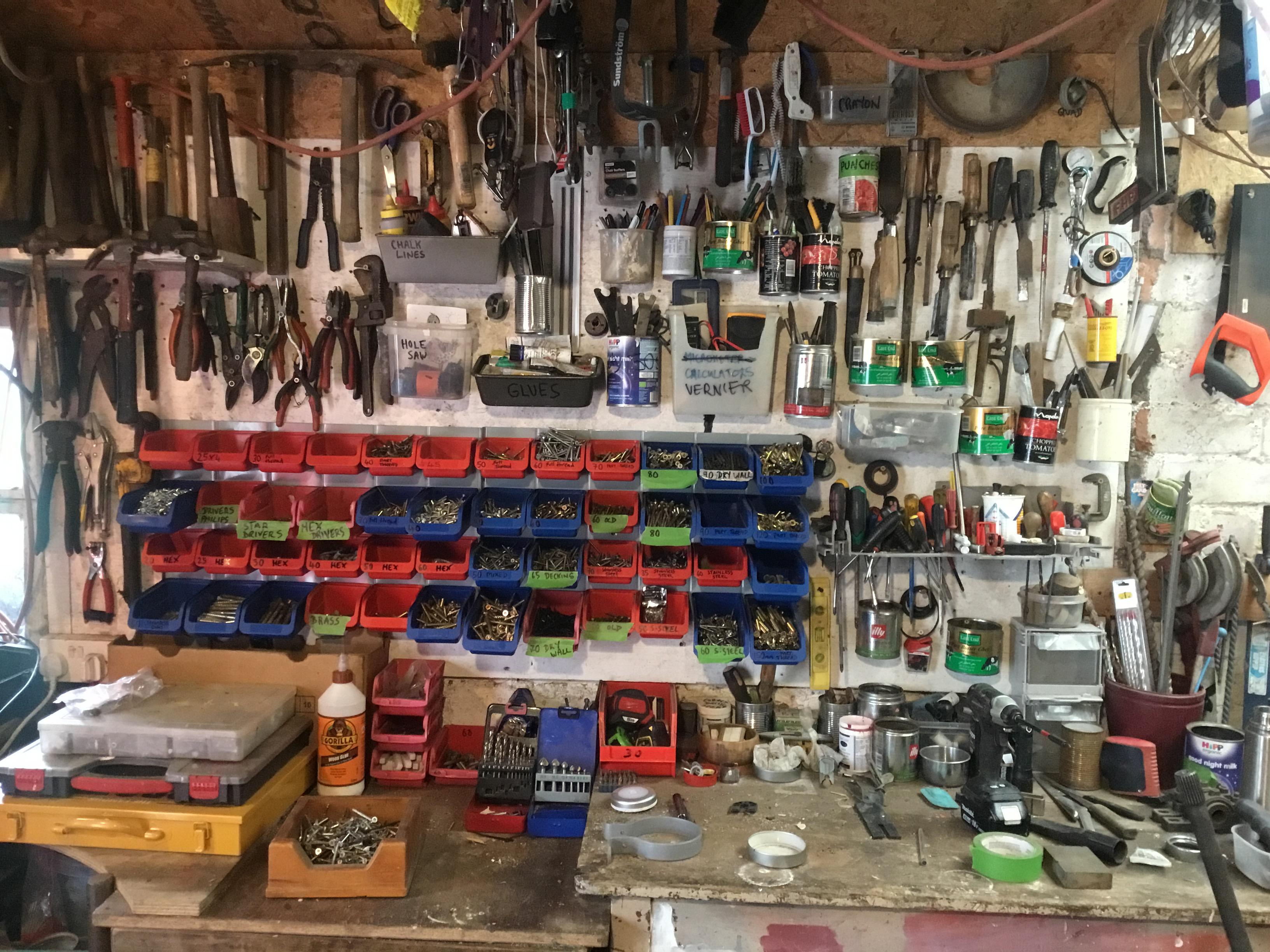

Cpd Posted October 6, 2019 Posted October 6, 2019 I have pretty much used / using 95% screws on my buildings, just used ss ring shank nails for the cladding and that was it. I constantly restock from 20mm all the way to 150mm as my project is ongoing and multi dimensional........ they are easy to access on the wall. 1

Redoctober Posted October 6, 2019 Posted October 6, 2019 17 minutes ago, Cpd said: I have pretty much used / using 95% screws on my buildings, just used ss ring shank nails for the cladding and that was it. I constantly restock from 20mm all the way to 150mm as my project is ongoing and multi dimensional........ they are easy to access on the wall. WOW - I have workshop envy. What a place!

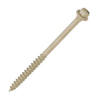

Hastings Posted October 7, 2019 Author Posted October 7, 2019 Just for the record regarding screws for framing, since nobody has mentioned them yet, I was looking at these kind made specifically for timber framing (Simpson do something similar) :
