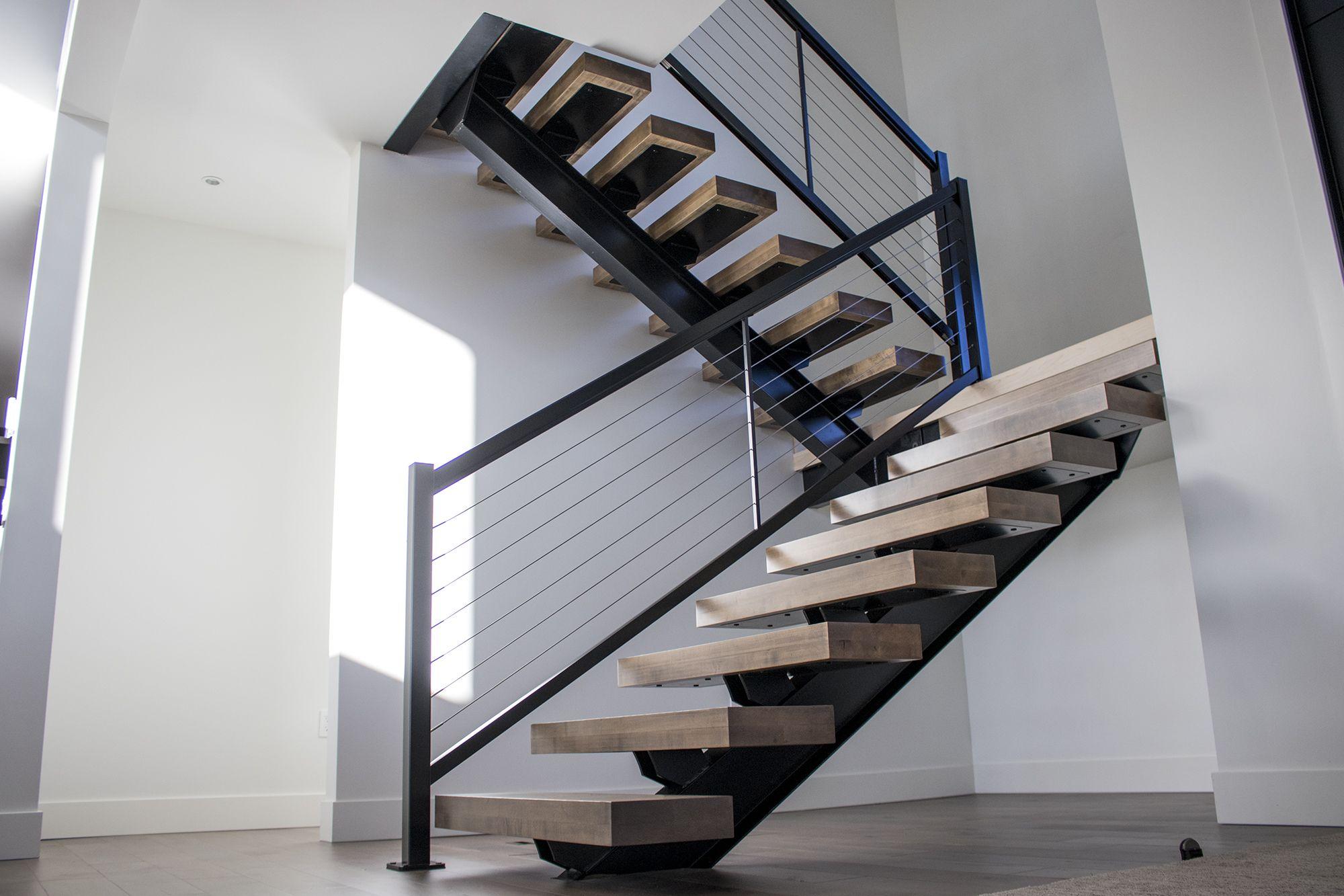

Triassic Posted October 5, 2019 Share Posted October 5, 2019 I'm starting to look at stairs for my new build, I need three sets, each with a half landing. Having measured the stairwell I find it larger than necessary, given I need to comply with Building Regs (rise and go). This means that for in every case I'll have to extend the landings to meet up with the top of the stairs. (You'd have thought the architect would have considered the staircases when doing the design! But lets not get lost down that rabbit hole !!). Can anyone recommend any online staircase design calculator / visualization software I could input my dimensions, as a starter for ten! At some point I then need to get someone to fabricate the steel work needed, I'm thinking of something like this....... Link to comment Share on other sites More sharing options...

Triassic Posted October 6, 2019 Author Share Posted October 6, 2019 (edited) Drawing the stairs out, I have a 170mm rise and a 315mm going (tread), at an angle is 30 degrees. We've decided that a single metal spine could be too bulky, so we're now looking at something like this... Can anyone suggest a supplier? Edited October 6, 2019 by Triassic Link to comment Share on other sites More sharing options...

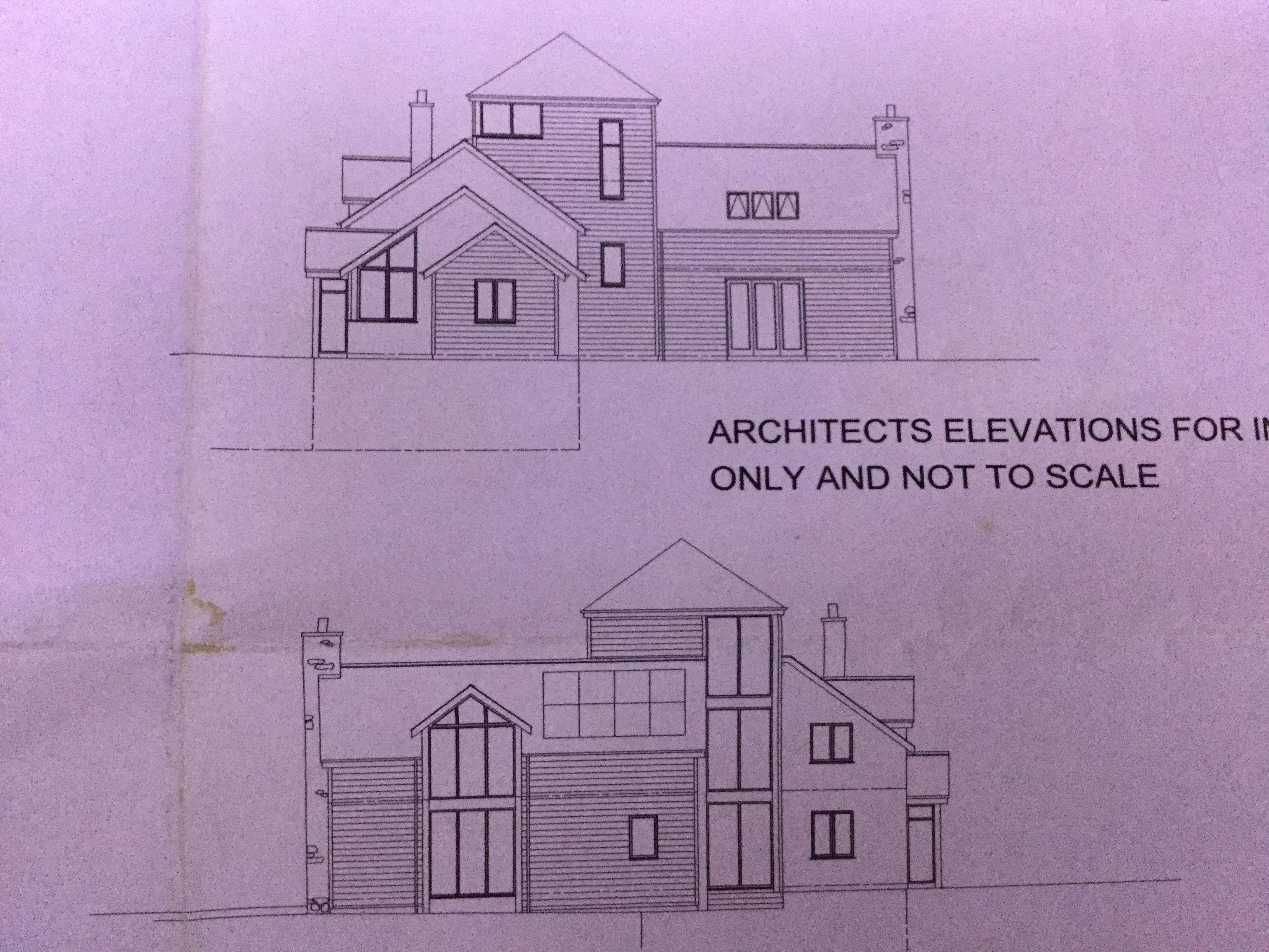

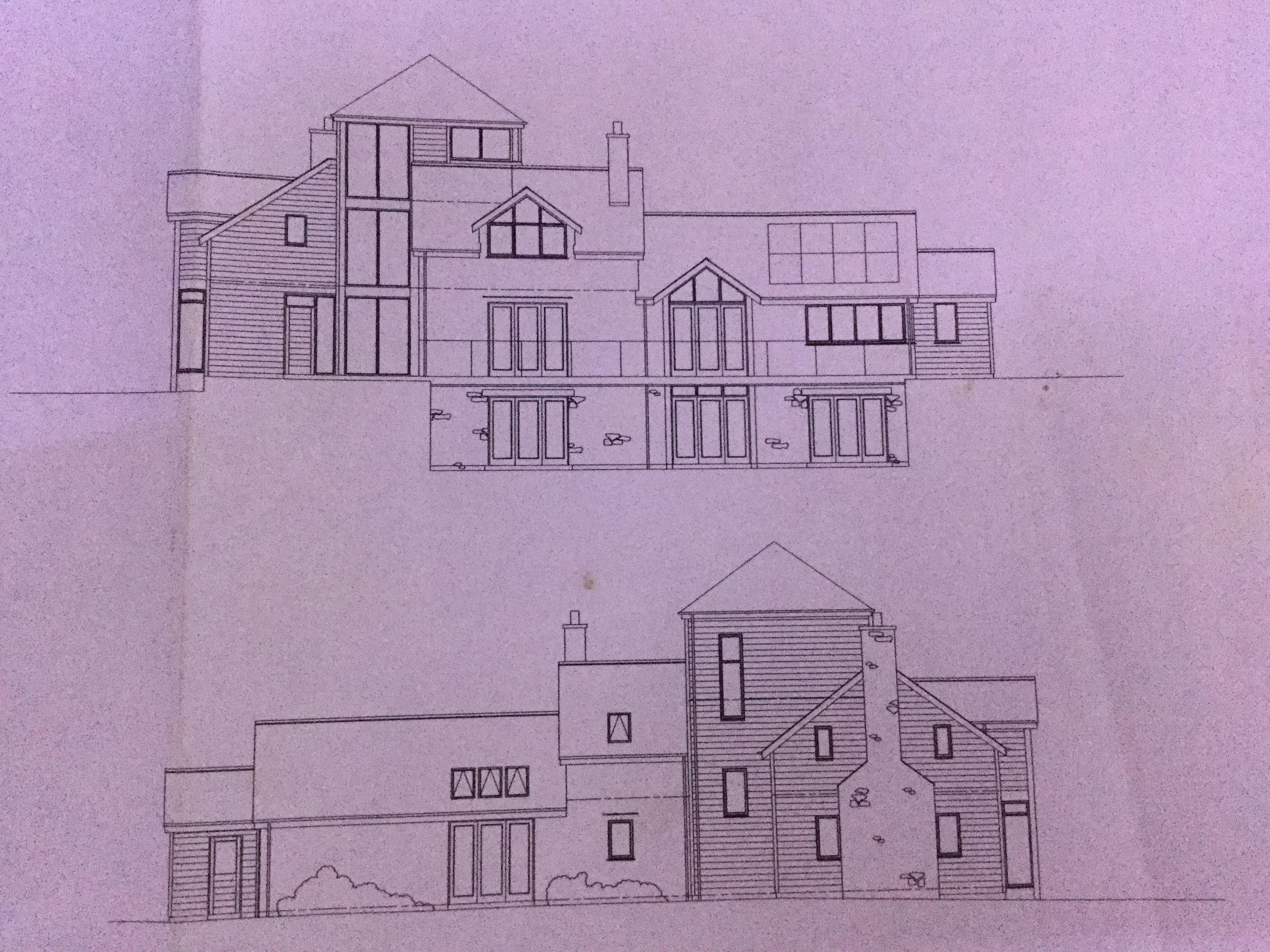

Ferdinand Posted October 7, 2019 Share Posted October 7, 2019 (edited) TBH I think I need to see a plan to say more that is useful, and that is not needed if you now have the info you need, @Triassic. From the elevation you have a 4 floor house. One of which is basement, and three more to the top of the ‘tower’. I am not currently clear whether it is a single staircase all the way up etc. Edited October 7, 2019 by Ferdinand Link to comment Share on other sites More sharing options...
