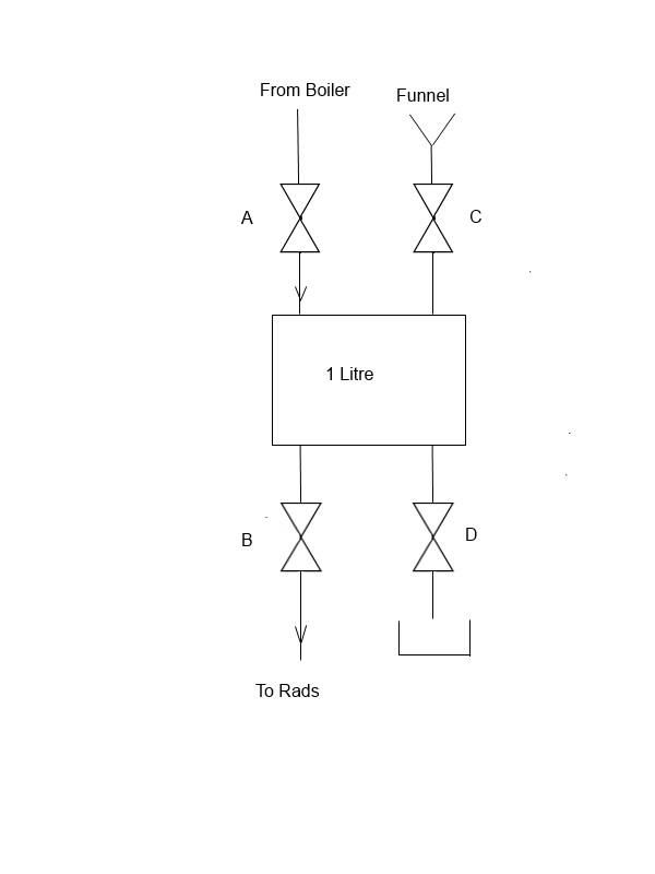

Temp Posted October 4, 2019 Share Posted October 4, 2019 7. Make it easy to put corrosion inhibitor in the system ! I seem to be banging on about corrosion inhibitor at the moment. Must be the time of year. I'm sceptical of annual maintenance contracts. They cover servicing but most do NOT include checking or topping up the corrosion inhibitor. Yet this is the most important thing you can do to keep your system reliable. Without it over time sludge builds up and can block pipes and pumps and cause leaks in the boiler and rads. The first you know about it is the system fails to work when you switch on the heating in September/October. The sludge has settled out over summer and blocked a pipe. When the service man rocks up he tells you the contract doesn't cover the first power flush. You are faced with a bill of £300-£800. Sometimes they tell you its mandatory to have one or they won't cover you any more. You can shop around and get a power flush done by another company but there are quite a few sharks out there. Adding corrosion inhibitor like Fernox F1 can help prevent the problem... If your system is vented you can just tip a bottle or three into the header tank but this can mean a climb into the loft. If your system is pressurised you have to lower the pressure and use a kit to inject the stuff into a radiator bleed valve or similar. Then repressurise the system. This would be a lot easier if there was a "filling port". See my next post in a moment. Link to comment Share on other sites More sharing options...
PeterW Posted October 4, 2019 Share Posted October 4, 2019 2 minutes ago, Temp said: This would be a lot easier if there was a "filling port". See my next post in a moment. Mine has one - called the Mag Filter. Can empty it, then it takes 500ml bottles of inhibitor. 1 Link to comment Share on other sites More sharing options...

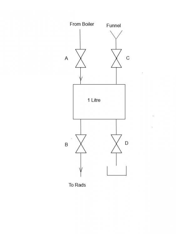

Temp Posted October 4, 2019 Share Posted October 4, 2019 There might be an easier way but here is my idea for a filling port for pressurised systems. To add inhibitor you would switch off the system and close valves A and B. Then open C and D to drain the 1L tank. Then close D and pour inhibitor into the tank via the funnel. Then close C and reopen A and B. Switch system back on. Link to comment Share on other sites More sharing options...
Jeremy Harris Posted October 4, 2019 Share Posted October 4, 2019 Our old system was dead easy to top up the inhibitor, via the mag filter. I used to just fill the filter chamber up with neat inhibitor after cleaning it. Not sure what the concentration was, but as it was a closed and pressurised system I reckoned a filter full should have been enough to keep it working OK. The mag filter was dead easy to clean, too, just close the two isolating valves, stick a bowl underneath to catch any spillage and whip it off for a clean. 1 Link to comment Share on other sites More sharing options...
