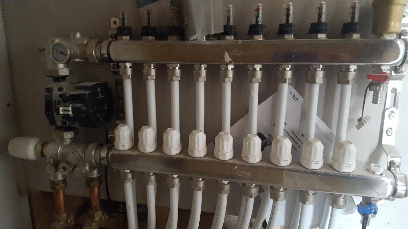

ProDave Posted October 3, 2019 Posted October 3, 2019 Can you post a picture? Do you even have actuators on the manifold yet? What do you want to achieve? That will determine what controller(s) I opted for the simplest system (I like simple) I have a simple and cheap manifold controller. Each room just has a room thermostat, and the whole thing is under the control of one conventional central heating programmer to determine when the heating is on and off. You can be more clever if you want to and have programmable thermostats so you can set different rooms at different temperatures at different times. Without a controller, what powers the UFH manifolds pump? This is the only picture I have to hand of mine, showing the bargain basement controller, but before I had attached and wired the individual actuators (in fact before I had connected any pipes!!!)
vivienz Posted October 3, 2019 Author Posted October 3, 2019 Apologies, Dave. What I meant to say was room thermostats that will control the call for heat. Currently, the full ground floor heating can be on or off but no control over the temperature. Everything that is down the line from the room thermostat is in place. I should add that I won't be installing these myself but will have an electrician put them in. Thanks.
ProDave Posted October 3, 2019 Posted October 3, 2019 Post a picture of what you have as that will influence what will work with it or not.

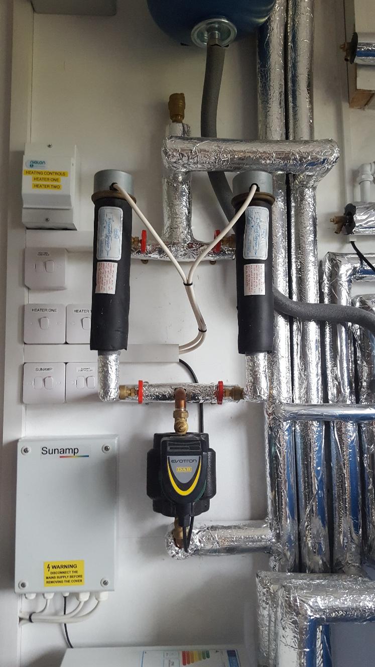

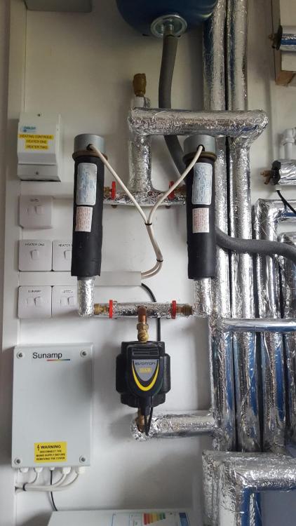

vivienz Posted October 7, 2019 Author Posted October 7, 2019 Sorry for the delay in posting pics here, Sunday lunch for the outlaws gets longer every time; it will extend into a candlelit supper before long (on Royal Doulton china with hand-painted periwinkles, of course). Anyhow, these are photos of the ground floor UFH manifold and the gubbins in the garage, including the willis heaters. I believe that the UFH circuit isn't commissioned yet, in so far as the pump isn't wired up and the pipes need bleeding, so it's just the ground floor for now. I'm not sure how much longer the house will remain at a comfortable temperature so I need to get the room stats sorted asap.
Jeremy Harris Posted October 7, 2019 Posted October 7, 2019 The UFH is configured to all be a single zone (no actuators on the lower, return, manifold) so all you need to control the UFH is a programmable room stat. Plenty of choices, depending very much on what features you want. At the most basic I'd go for a programmable stat that automatically changes the clock, as @Temp, suggests (although it does seem possible that we might do away with the BST/GMT change twice a year). You could go for something "smart", that can be controlled by an app, although there's always the risk that any app-based control system could fall over as devices get upgraded, cloud-based infrastructure falls over, etc. If you want to consider zoning the UFH, then the white caps on the return manifold need to be swapped for actuators, and the actuators need connecting to a wiring centre, that then allows individual loops, or groups of loops, to be independently controlled. This means more thermostats, to set the temperature for each zone, and may or may not also need a programmer that can control the overall timing of when things are on or off. This is potentially a fair bit more complex, and needs a bit of thought as to whether it will be a benefit. That really depends on how well heat can move around the house. For example, we have no heating upstairs, other than towel rails in the bathrooms. Despite that we sometimes find that the bedrooms get a bit warm. If we had zoned heating that would still happen. It might be an idea to have the bathrooms separately controlled, though, as being able to warm the bathroom floor slightly morning and evening is a nice feature to have. You might want to think about having maybe three zones, one for the bedrooms, one for the bathrooms and one for the rest of the living areas. It depends very much on how you like things. We like the bedrooms to be cooler than everywhere else, so are happy with only heating the ground floor living areas, but we're all different!
Jeremy Harris Posted October 7, 2019 Posted October 7, 2019 4 minutes ago, dpmiller said: how will you bleed the air out of the Willis? Looks like there's an AAV above the Willis heaters, on the flow side. 1
dpmiller Posted October 7, 2019 Posted October 7, 2019 1 minute ago, JSHarris said: Looks like there's an AAV above the Willis heaters, on the flow side. which leaves a big air pocket above the side tapping. They're normally fitted the other way up round these parts...
vivienz Posted October 7, 2019 Author Posted October 7, 2019 Thanks, chaps. The bathrooms aren't in the wet UFH loop, I have electric UFH mats and heated towel rails, although there are no elements in the towel rails yet, so the bathrooms will be okay once this is done. I don't mind not having the downstairs heating zoned - there's not much point as far as I can see, but I would prefer the upstairs to be zoned as one of the rooms is my office/sewing room and I don't want to get chilly in there. For the downstairs, then, I'm okay to get hold of some programmable thermostats (not interested in smart ones) and get them wired in, from the sound of things, and that will at least sort out the ground floor.
