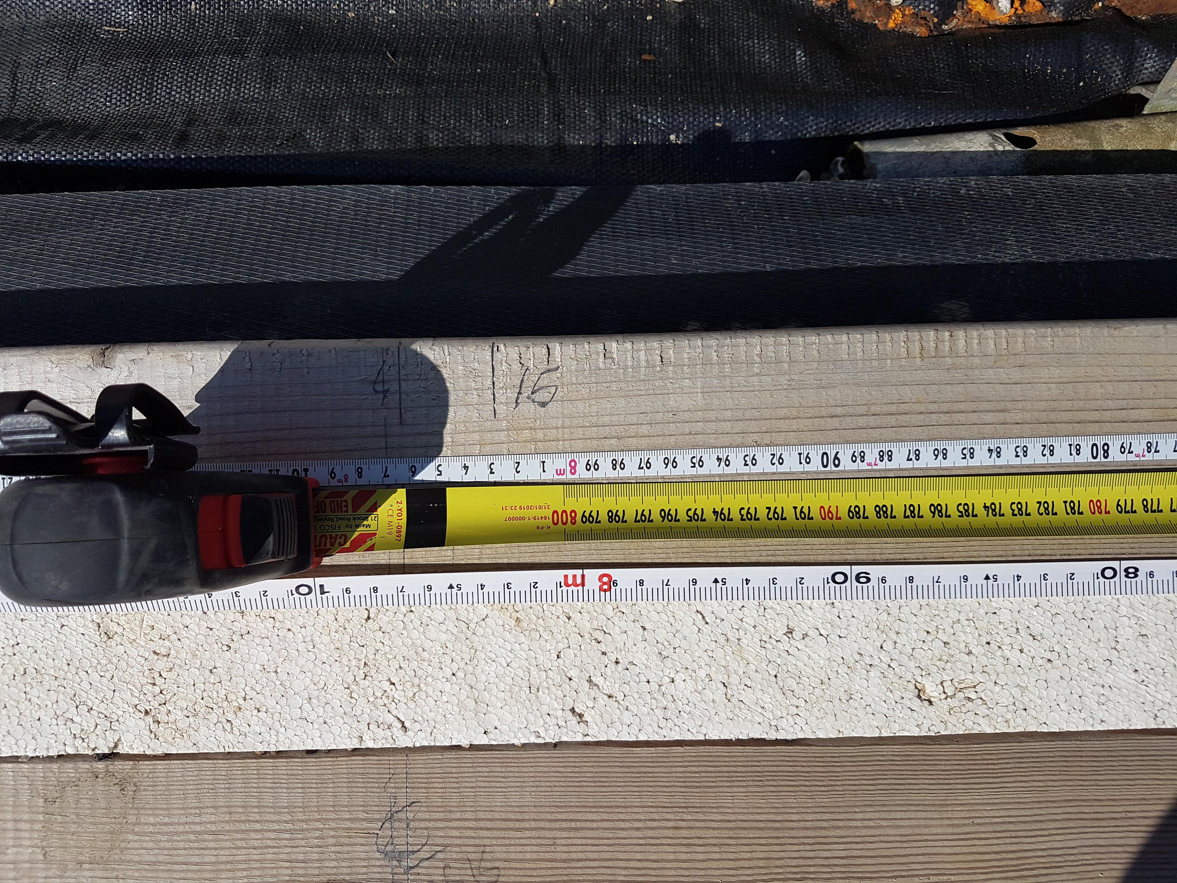

MikeSharp01 Posted September 19, 2019 Posted September 19, 2019 I wish I had paid more attention in Metrology lectures way back in the 70s! So which of these is a class 1 tape then? Actually 2 of them are class one yet they do not agree over 8m at any rate. The third is a cheap plastic tape and it clearly under reads the other two - the essential question is which one is correct? The yellow one is my everyday tape but only 8m long as you can see. The thin white one is 20m but still class 1. The other cost me £7 in wicks a fews years back. So as a rule they are pretty useless when measuring is shared across different tapes. Conclusion - using 1 tape for everything so that all the errors will be consistent at least.
ToughButterCup Posted September 19, 2019 Posted September 19, 2019 On 19/09/2019 at 11:52, MikeSharp01 said: I wish I had paid more attention in Metrology lectures way back in the 70s! So which of these is a class 1 tape then? [...] Conclusion - using 1 tape for everything so that all the errors will be consistent at least. Expand I measure with a tape and a laser (where possible), and halve the difference ( 1 or 2 mm sometimes). But I always trust a steel rule - especially over a laser.
Mr Punter Posted September 19, 2019 Posted September 19, 2019 I just looked up what these mean. The top 2 are about 1mm out and class 1 allows +-0.9mm over 8m, so they may be OK. The third one is way out but may be kept for [other reasons]
MikeSharp01 Posted September 19, 2019 Author Posted September 19, 2019 On 19/09/2019 at 12:04, Mr Punter said: The third one is way out but may be kept for [other reasons] Expand Yes its normally used for setting out the croquet lawm at millstone manor. I have it here because its 50m amd allows me to do quick and, as you can see, dirty measurements over the full depth of the site.

MikeSharp01 Posted September 19, 2019 Author Posted September 19, 2019 (edited) On 19/09/2019 at 13:28, SteamyTea said: Our old mate Joiner used to have a metre rule on the wall, he told everyone to check their own rules and tape against it. Expand Trouble is 1m is not really enough @jack has the right idea with the outside length - but how did they know their length was correct, However the issue is not an absolute one as unless you have access to lab conditions you are unlikely to be able to get good enough conditions to reference measure within 0.5 mm over distances greater than several meters. Edited September 19, 2019 by MikeSharp01

jack Posted September 19, 2019 Posted September 19, 2019 On 19/09/2019 at 15:00, MikeSharp01 said: Trouble is 1m is not really enough @jack has the right idea with the outside length - but how did they know their length was correct Expand They didn't. I suspect it was more to make people aware of the potential issue than to act as a calibrating standard. The main issue with typical metal tapes for me is that bit on the end that slides slightly to account for whether the end of the tape is being pushed into, or pulled away from, whatever's being measured. I just always assume there's a couple of mm error and try to make sure that an error of that magnitude doesn't impact what I'm doing. One example is where the absolute measurement isn't as critical as making sure it's replicated properly (ie, precision is more important than accuracy). An example would be making legs for a workbench. Best to cut all legs at once, or at least use the same physical template for each of them. Doesn't matter if they're all 5mm shorter or longer than the design (which is slightly arbitrary), as long as they're the same. There's something called a "story stick" in woodworking that's a nice development of this idea. 1
MikeSharp01 Posted September 19, 2019 Author Posted September 19, 2019 On 19/09/2019 at 15:18, Conor said: Temperature can be a significant factor when it comes to metal tapes. Do that again in 3 months time when it's -5c and you'll find the metal tape will be shorter. Expand Agreed but both were at the same temperature here and they should expand and shrink almost the same as they are the same material and from the same manufacturer! I will of course have the slight challenge of what to check them against that is not itself affected by the heat.
