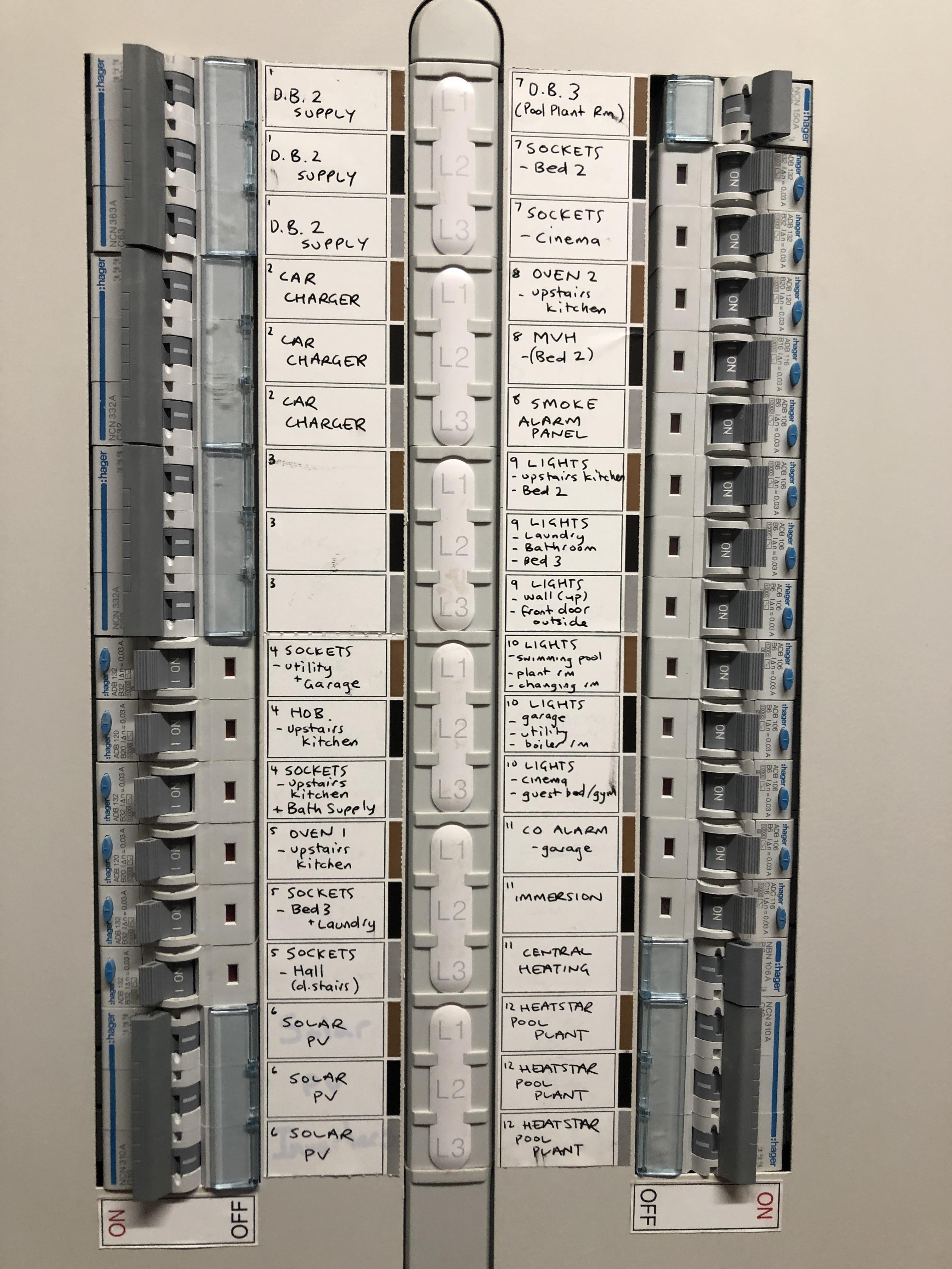

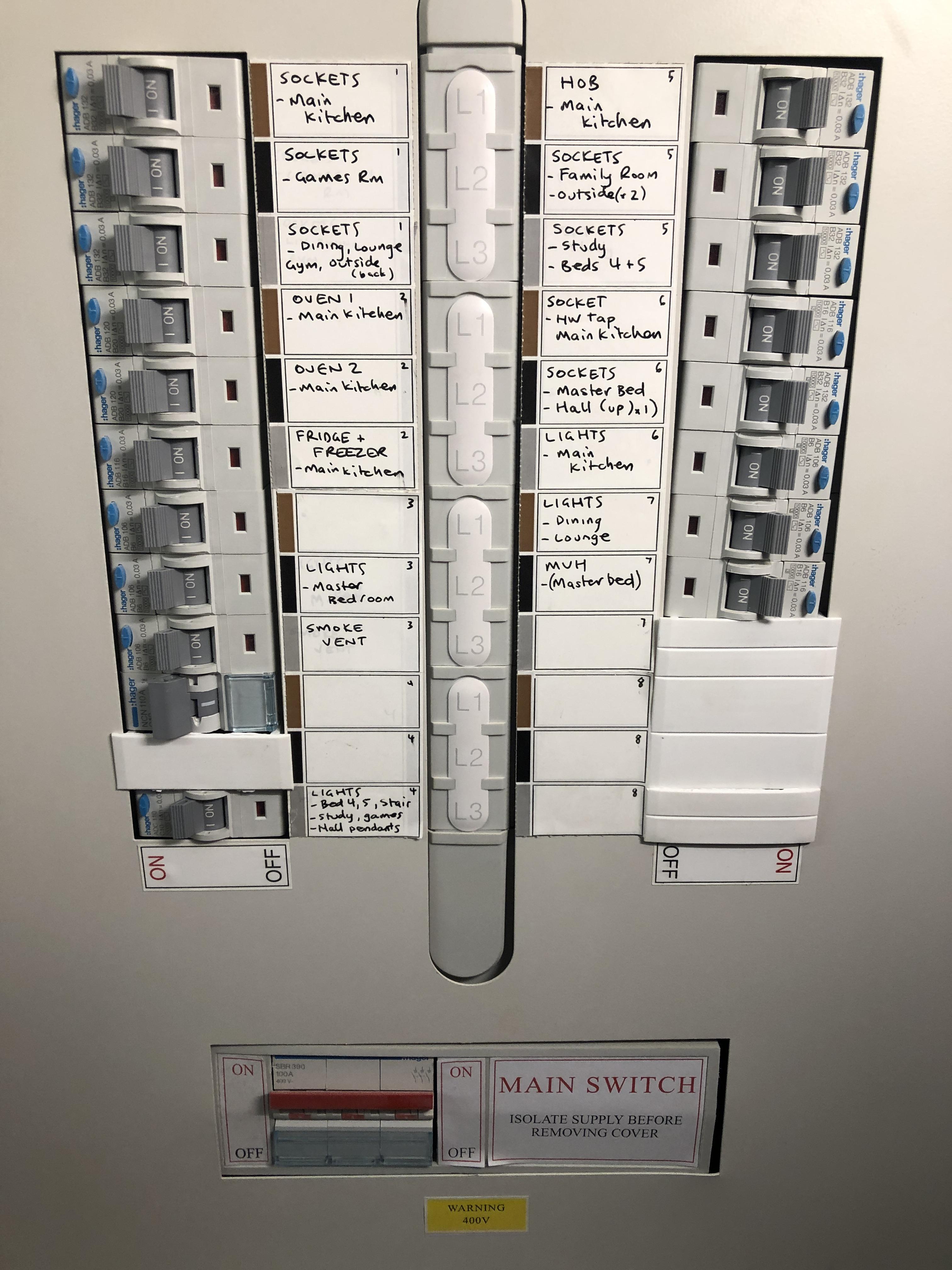

AliG Posted September 15, 2019 Posted September 15, 2019 (edited) I went and checked his after a previous discussion. We have 5kw of PV split equally across 3 phases. Our electricians have split the circuits across the phases, but we have a 3 phase car charger and the pool dehumidifier which is probably the biggest user of electricity in the house is also 3 phase. I have taken some pictures to show how this works. We also have an Elster meter, an A1140 which measures kWh across all three phases so basically works like any other meter. Currently you cannot have a three phase smart meter, none have been approved yet. Edited September 15, 2019 by AliG

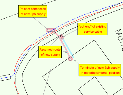

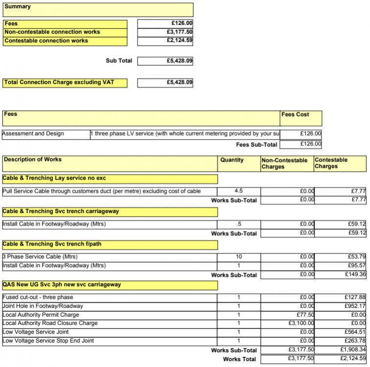

SuperPav Posted January 21, 2022 Posted January 21, 2022 On 30/11/2021 at 00:15, acormack said: Slightly off topic here but what are they quoting for fitting a three phase supply dnb?? I take it is reasonable to install with you? Just in case people are searching for this, attached is the quote to upgrade our current supply to 3ph (but essentially they treat it as a new connection) If it wasn't for the road closure, it's pretty reasonable.... Unfortunately no real way around the road closure. The most annoying thing is that the road was closed for 2 weeks in 2020 for drainage works, if we'd known/thought to do it back then, would've been a bargain.
