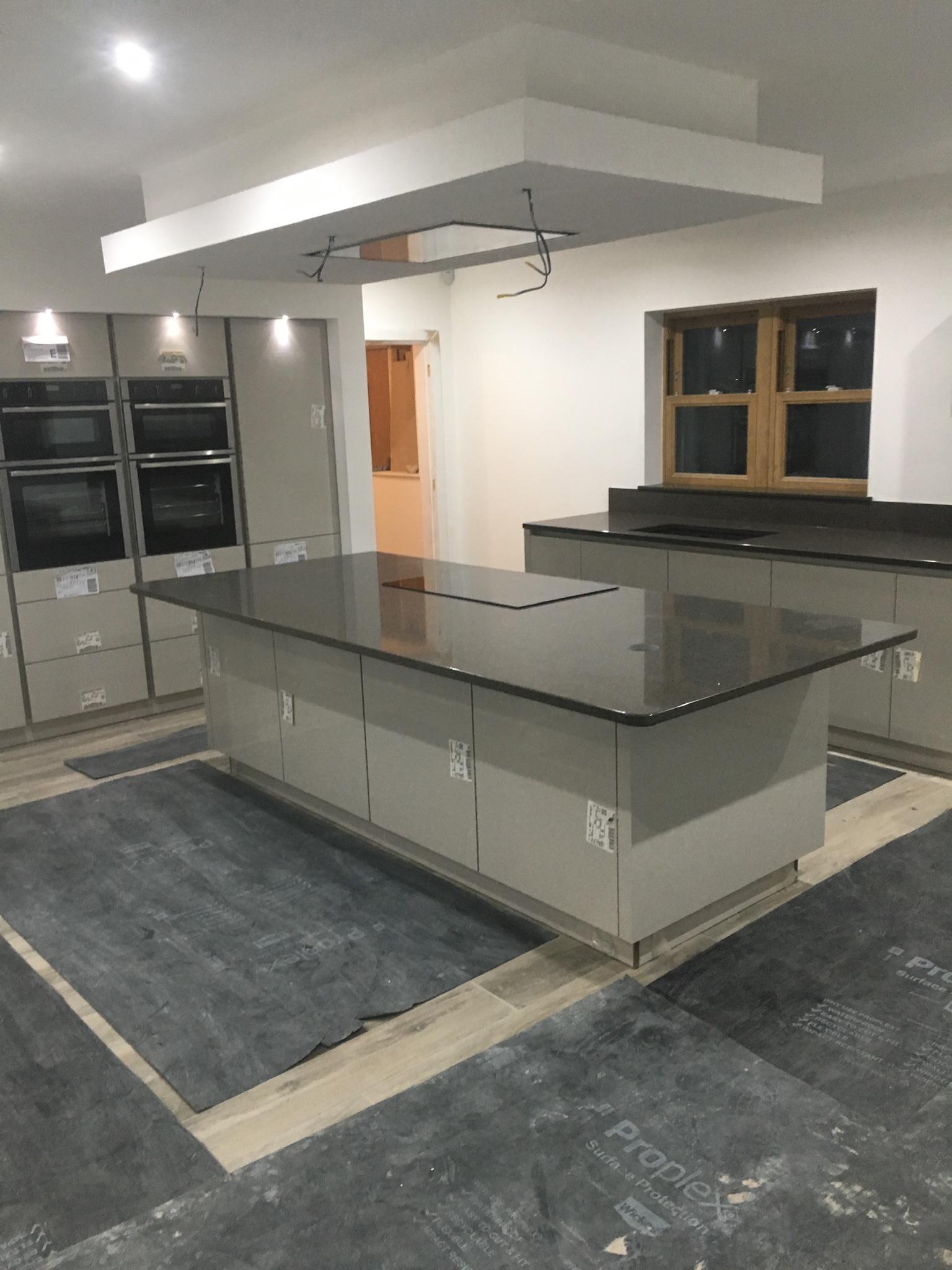

I splashed out an outrageous amount of money on a Novy panorama.  Whether the price tag is justified is a very subjective question, but it was for me. Fabulous functionality on the hob. The controls are sliders but highly responsive and accurate. You can have a super-power option on one spot to bring pans of water to the boil quickly, you can set it to maintain 3 different temperature levels and the bridging function works well. The recirculating extractor is quiet and powerful; even searing steak on a hot skillet doesn't let grease vapour escape. Cleaning is a breeze; including the extractor, I can have the whole thing wiped down and cleaned in about 2 minutes. A squirt of kitchen spray, wipe with  wet cloth then wipe with a microfibre glass cloth.
I'm not a fan of the bora - I did try one out in a kitchen studio but the novy is in a separate class (with a price tag to match, it must be said).

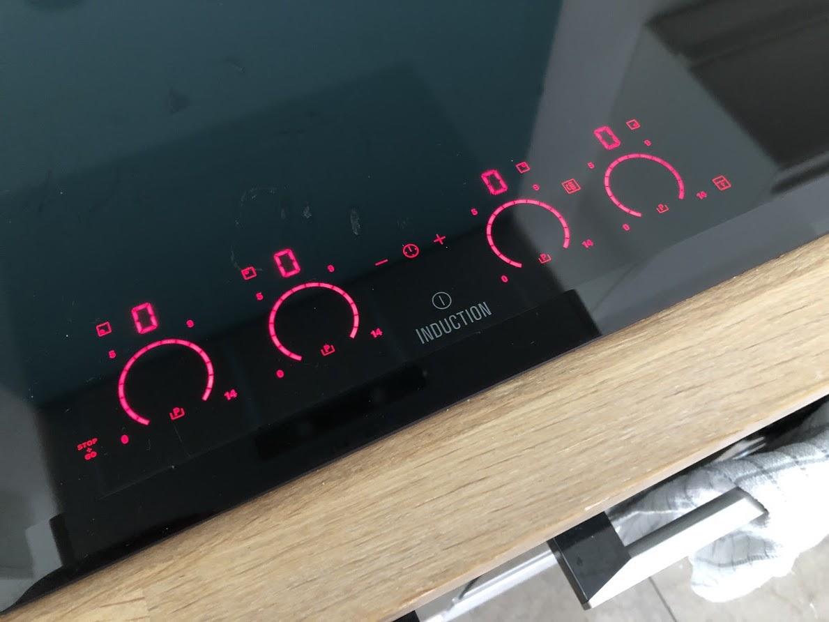

We've got an Electrolux induction hob - absolutely love it. We don't seem to get any of the on/off that you're talking about.... simmers perfectly (it's obviously pulsing somehow but there no noticable changes to the pan/boiling/simmering etc)... it maintains a consistent temperature.
For us the key decision points were -
Size - wanted a wide hob
Controls - we wanted individual controls for each 'ring', quite a lot of them seem to have a single control and a selector to choose the 'ring' which when something is boiling over is a PITA
Power - Ours can do all the power boiling etc, think it's rated at about 7Kw all in
Sadly, no longer made - https://www.appliancesdirect.co.uk/p/ehl8740fok/electrolux-ehl8740fok-0-induction-hob-hob
Controls when turned on...

Second vote for Neff with magnetic disc control. Cannot notice any pulsing, when I want controlled low heat I simply dial in the number and it works without fail (porridge is no 3, Moka pot is no 4.5).
Super easy to operate with rotary knob, cleaning surface is flat after knob removed, has power boost mode and flexible zones.
Came from gas and also have used ceramic hob. I only miss gas when cooking in a wok.

I'm also going to be coy on price, just in case OH should stumble across this thread, but the German price will need all extraction kit and accessories added on, in true German car purchasing style.
I came within an ace of buying a Gutmann and looked at Bora but was seduced by the Novy.
Cleaning- just the hob is a 30 second effort but novelty value is still present having had gas hobs all my life. I will get bored with cleaning very soon. Guaranteed.
Distance of pans from the extractor - the zones are in a line parallel to the extractor and so are equidistant. The extractor has 3 height settings and I opt for whichever one matches the highest pan.
Not sure I understand, here's my artist impression:
1296703889_Screenshot2019-09-12at14_34_45.thumb.png.3a639793360ee5d61bd806a249b12ca7.png
Clearly (...) if you want the pan to be close to you, it will have to be far away from the extractor, no?
