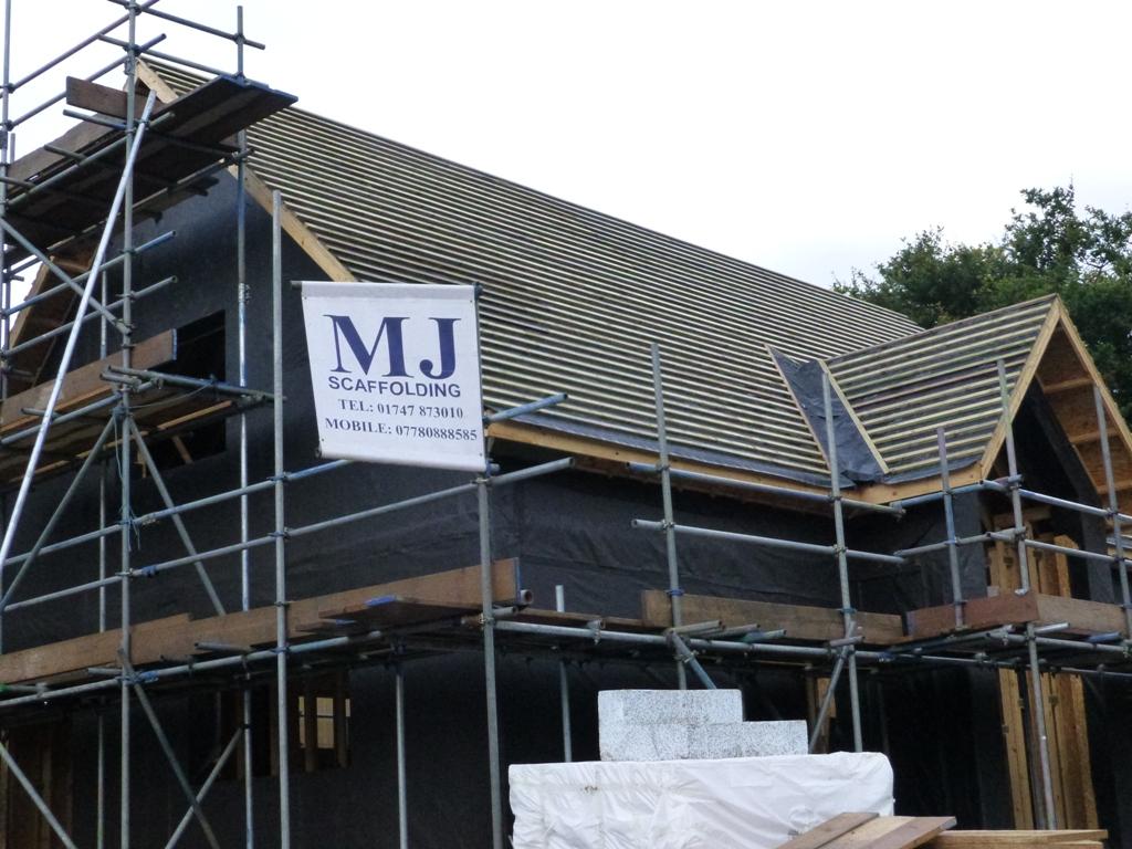

Andrew Posted September 8, 2019 Share Posted September 8, 2019 We're just about to start soliciting quotes for the roofing on our build. We are going to have solar PV on the roof of the house and the detached garage and really like the look of the in-roof systems like GSE. However there are a couple of things we're not sure on :- 1) Who is the lead trade for the installation of the GSE system. I presume the mounting system and flashing is installed by the roofers but who would normally place the panels in. Obviously an electrician is also required at this stage to wire things up? 2) With the in-roof system we'd need to install the panels earlier in the build to get the roof watertight. At this stage the grid electrical connection may not be in place and the 1st fix electrics certainly won't be done. Is this an issue - the panels will presumably generating whilst on the roof and the sun is shining - would they need to be covered up? Would be interested in anyone's experience in these areas. Many thanks, Andrew Link to comment Share on other sites More sharing options...

Jeremy Harris Posted September 9, 2019 Share Posted September 9, 2019 The sequence we used for installing our in-roof PV, using the GSE mounts, was to have the mounts fitted first, with all the wiring put in place for each panel. We then had the roofers in to fit the slates, and once the roofers had finished we had the PV people back in to install the panels on to the mounts and wire them up. I'm glad we opted to do it this way, as I wouldn't like to have roofers mucking about up there with the panels in place. Link to comment Share on other sites More sharing options...

Jeremy Harris Posted September 9, 2019 Share Posted September 9, 2019 3 hours ago, the_r_sole said: what is the lifespan of these in roof panels? I always worry about making a roof structure to accommodate these when a roof covering is likely to outlast the panels on it... Probably unknown beyond about 25 years. There's no real change to the roof structure needed to fit in-roof PV, though. Our roof was just battened at the pitch needed for the slates: and then the GSE frames were fitted to the battens (with a few extra battens added where needed): The roof was then slated and when that was completed the PV panels were installed. 2 Link to comment Share on other sites More sharing options...
