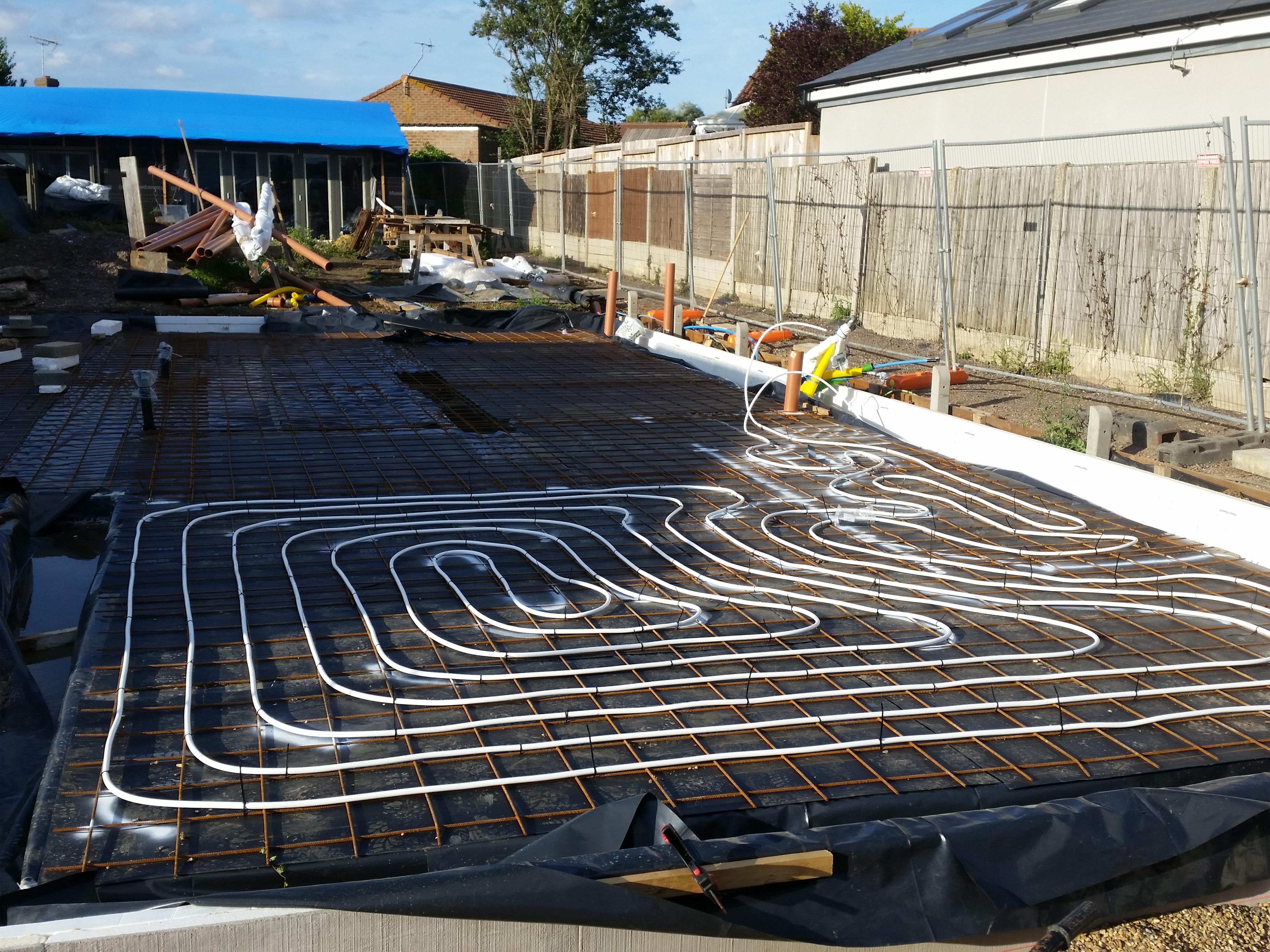

Jeremy Harris Posted August 30, 2019 Posted August 30, 2019 On 30/08/2019 at 14:58, albert said: Hi I have 150m2 GF of UFH to install and I' d like to install it in the slab (125mm ) (100 mm PIR below) I have seen pipes cable tied to mesh on commercial jobs and wondered if there were any pit falls. The UFH company are after crazy money to install. We have done it ourselves before but in flow screed and not to mesh. Any advice welcome. A Expand Our UFH pipes are just cable tied to the reinforcing fabric:

mvincentd Posted September 2, 2019 Posted September 2, 2019 @albert maybe worth noting from the example images given above that Onoff has the advantage of the supportive red tray so his ufh pipes not following the line of the mesh is unimportant, whereas the others do as far as possible stick to the mesh lines. The more instances of pipe spanning the middle of a 200mm square unsupported, the more vulnerability to a clumsy wellie etc' you have.

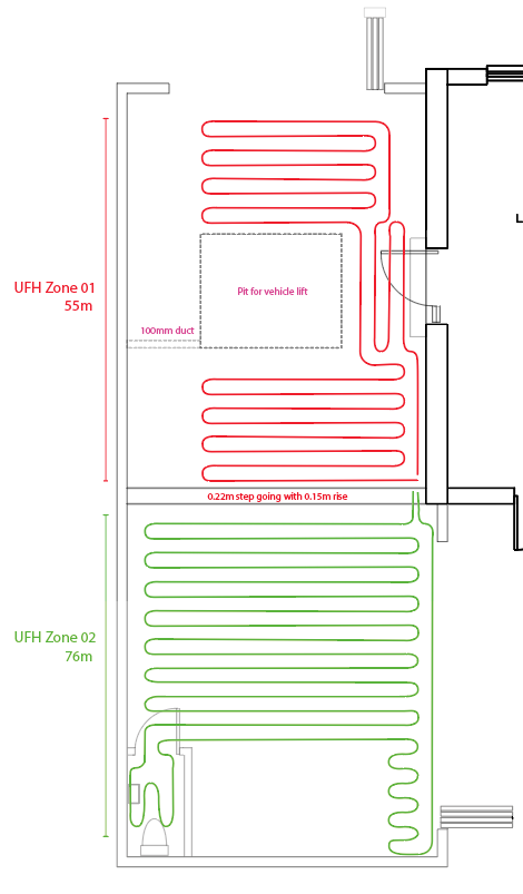

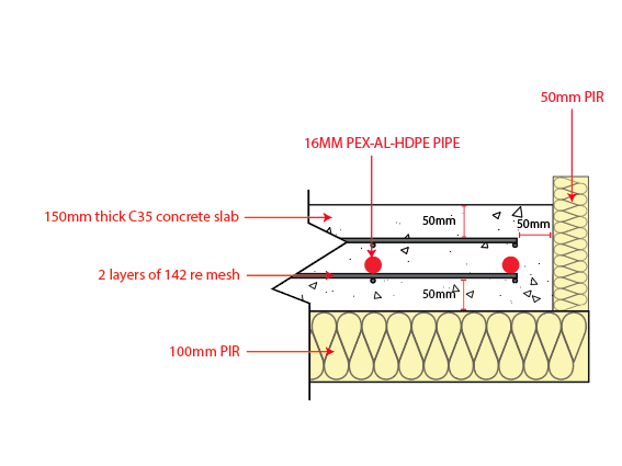

SeanDean Posted March 26, 2021 Posted March 26, 2021 Sorry to highjack the thread guys but I want to check my last min plan for UFH is ok before I start laying the pipe. I might not even use the UFH but thought it best to get it into the slab as I might regret not doing it down the line. Zone 01 is a workshop area and then a step up into zone 2 which is a bar/chill area. The entire space is open plan. So I plan to zip tie 16mm PEX-AL-HDPE pipe to my lower layer of 142 mesh @ 200mm spacing, the base is 150mm thick. I have a couple of questions below, if anyone can help me with them that would be greatly appreciated. - Does anyone see any major issues with my design? - What is the difference between PEX-AL-HDPE and PEX-AL-PEX and is one better than the other? - Am I correct in not running UFH where I might have units/bar or machinery bolted into the ground? - The pipes will not be hooked up to a manifold until later down the line but should I put water in the pipes when pouring the concrete base? Any help with be greatly appreciated.
Temp Posted March 26, 2021 Posted March 26, 2021 I have 80mm PIR in some rooms and if building again I would fit more. I assume your screed is 150mm thick in the workshop because you will be driving a car on it? Need not be that thick elsewhere.
TonyT Posted March 27, 2021 Posted March 27, 2021 I would be concerned that the second layer of mesh during installation would damage the pipework?
PeterW Posted March 27, 2021 Posted March 27, 2021 On 27/03/2021 at 08:15, TonyT said: I would be concerned that the second layer of mesh during installation would damage the pipework? Expand I hadn’t even clocked that ..!! @SeanDean who has specified two layers of mesh in that slab ..? One is more than adequate, you’re building a garage slab not a motorway bridge ...
SeanDean Posted March 27, 2021 Posted March 27, 2021 On 26/03/2021 at 23:39, Temp said: I have 80mm PIR in some rooms and if building again I would fit more. I assume your screed is 150mm thick in the workshop because you will be driving a car on it? Need not be that thick elsewhere. Expand Yes, that is correct but also heavy workshop machinery might go in zone 2 as well so thought it best to over-spec the thickness there as well for future-proofing. I guess I could reduce it to 100mm thick but other than saving a little bit of money I'm not sure what I would need to.
SeanDean Posted March 27, 2021 Posted March 27, 2021 On 27/03/2021 at 08:15, TonyT said: I would be concerned that the second layer of mesh during installation would damage the pipework? Expand I guess I could add bits of conduit over the points where the top layer of mesh comes into contact with the pipe like @Onoff has done in the images above.
SeanDean Posted March 27, 2021 Posted March 27, 2021 On 27/03/2021 at 08:30, PeterW said: I hadn’t even clocked that ..!! @SeanDean who has specified two layers of mesh in that slab ..? One is more than adequate, you’re building a garage slab not a motorway bridge ... Expand The original architect spec'ed it with two layers, if it's 100% not needed it could save us fathing about trying to protect the pipe from the top layer of mesh. Is it possible the architect meant layered directly on top of each other rather than spaced apart? (long story short the architect is no longer working on the project) If I was to remove the top layer of mesh am I correct in assuming I would move the single layer of mesh as close to the centre of the slab as possible while keeping the UFH pipe 50mm below the surface?
PeterW Posted March 27, 2021 Posted March 27, 2021 Half way through is ideal. If you want belt and braces ask the concrete company to put fibres in the mix and it will be bombproof. 1 1
