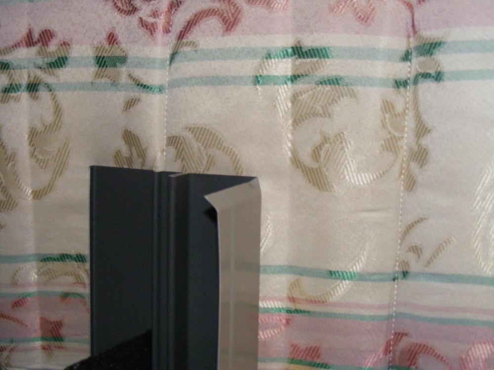

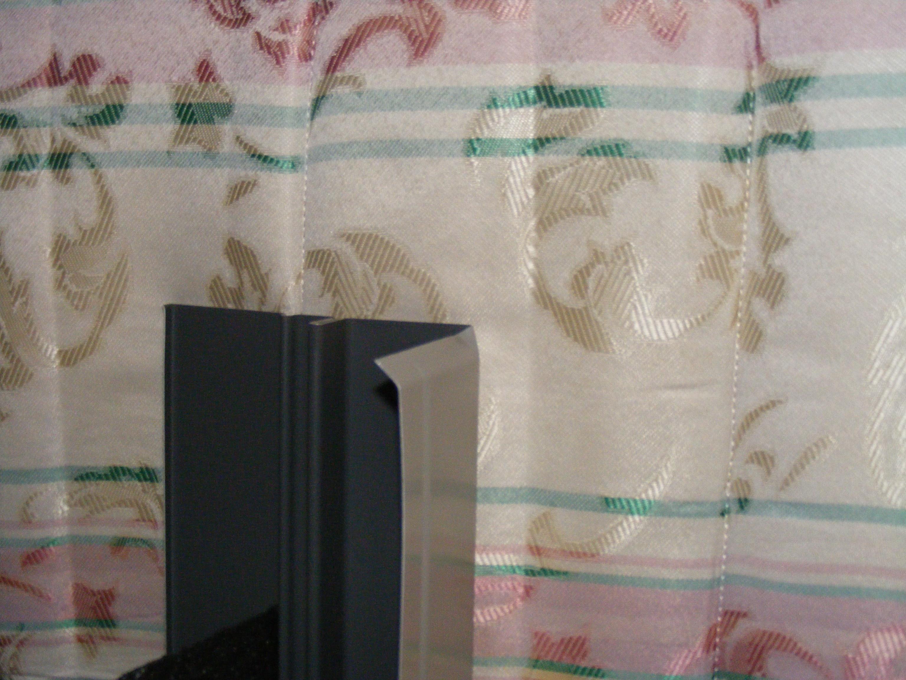

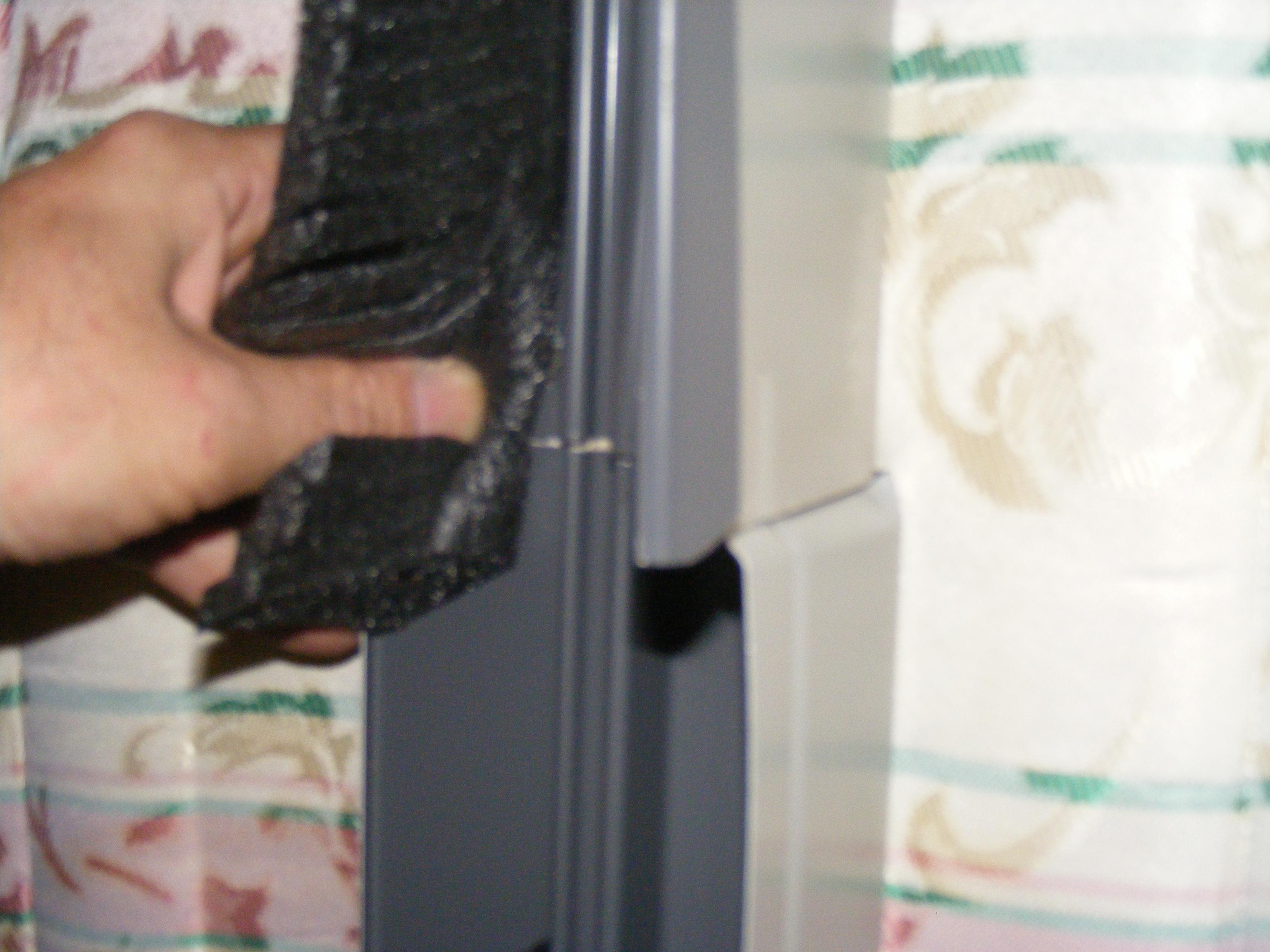

ProDave Posted September 20, 2019 Author Posted September 20, 2019 Some help with my flashings please. This is the Velux EDW flashing for a standard GGL roof window. The bottom piece of the flashing joins to the two sides correctly and easily. However I cannot get the top piece to join to the sides. First picture shows the top of the left hand side piece of the flashing. It clearly has the top of the bit facing you deliberately bent over. This is the same on both side pieces. It must be bent over for a reason. But if you try and slot the top piece onto the sides pieces, it simply won't go, because this bent over piece is in the way: I could make it fit together by using a pair of pliers and straightening out that bent over piece. But I should not have to do that, it is bent over for a reason. What am I doing wrong? The instructions are useless, just a few pictures with little details.
Cpd Posted September 20, 2019 Posted September 20, 2019 Have you got it right way up, could it be for the far side ? It’s hard to remember as I put mine in over a year ago but I do remember that there was the potential for mixing bits up... maybe it’s the top bit not the lower bit, I’m sure I had something similar, the flexible foam might help you with the correct placement I think.... as it’s designed to go one way. Sorry to be so vague but I do remember some small glitch and when I moved things round it became evident. I can go on my roof tomorrow if required and have a look, but don’t go bending it !
ProDave Posted September 20, 2019 Author Posted September 20, 2019 I am 99.9% sure I have them the right way. The bits of foam all line up properly. If I tried to swap the two sides over, and in doing so put them the other way up, then at the bottom the two bits of foam would not meet, leaving a gap, and at the top, the bits of foam would try to overlap. Of course Velux could make it simple and foolproof by printing "left" on one of them and "right" on the other, but that would just take all the fun out of it and reduce the calls to their help line. If you have one accessible (i.e. not tiled) then please have a look I am planning to fit the first one tomorrow, I have all the tiles removed and ready to go in the morning.
Ed Davies Posted September 20, 2019 Posted September 20, 2019 Does this video help? Youtube is excellent for working out most Velux stuff (compared with the Velux instructions which are not very helpful as a checklist once you know what to do and give no clue at all if you don't). 1
