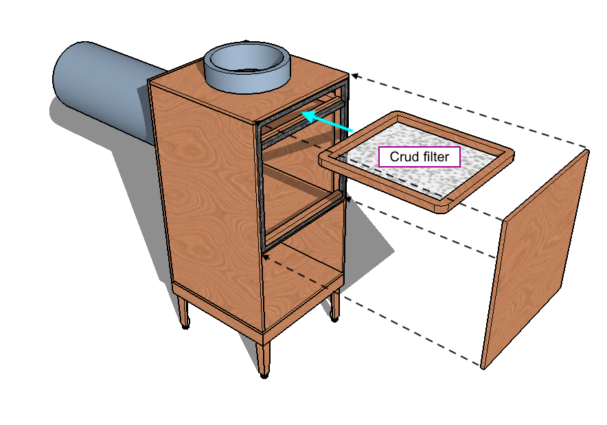

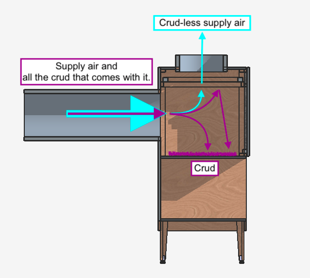

Russdl Posted November 15, 2020 Author Share Posted November 15, 2020 So, a year and a bit on from my initial thoughts on this I've been at it on SketchUp again. The plan is to make these boxes out of ply or MDF, any suggestions as to which would be best, and why? Sealed with airtight tape and closed cell foam for the removable door. My filter material will be, in the first place, unladdered stockings (if I can get them off without snagging them). The design will allow me to rip the box out and replace it with a standard Ubbink 180mm 90° bend if it all goes a bit Pete Tong. I welcome your comments and advice. 1 Link to comment Share on other sites More sharing options...
PeterW Posted November 15, 2020 Share Posted November 15, 2020 How about one of these with some G3 in it to start with ..?? https://www.ducting-express.co.uk/product/ducting-fittings/inline-filter-box/inline-filter-box-200mm Link to comment Share on other sites More sharing options...
Russdl Posted November 15, 2020 Author Share Posted November 15, 2020 ? Thanks @PeterW I always like to find complicated solutions to simple problems so that is way too straight forward for me, aside from that, it doesn't seem to do the 90° turn that I'll need. And no little shelve underneath for spare filters - or something. 1 Link to comment Share on other sites More sharing options...
PeterW Posted November 15, 2020 Share Posted November 15, 2020 @Russdl - I’ll step out at this point and let the master of over engineering comment as I’m sure he could knock you something up or do something for you in CAD to far exceed the requirements ... @Onoff are you there ..?? 2 Link to comment Share on other sites More sharing options...
