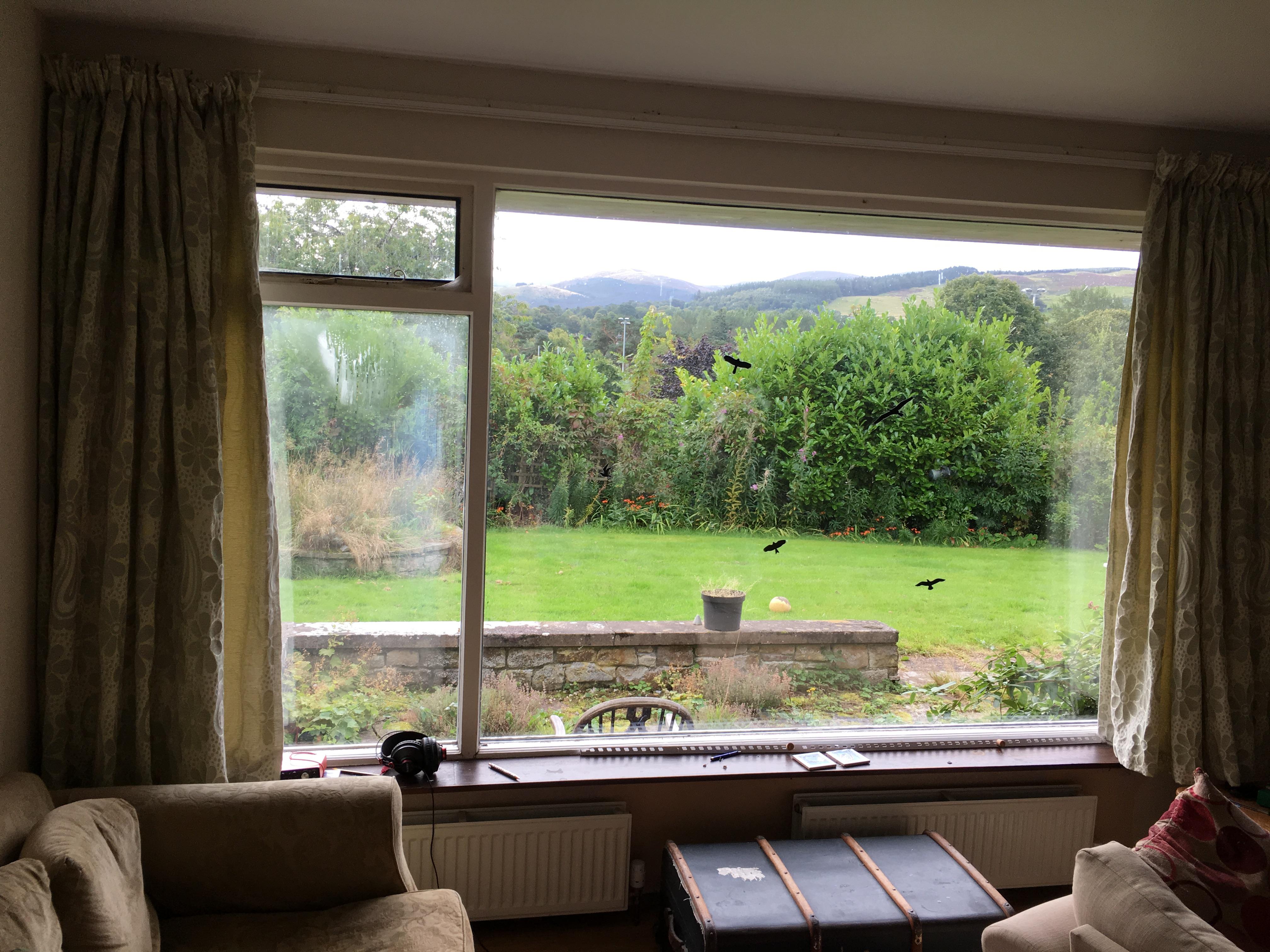

ruthn Posted September 28, 2019 Posted September 28, 2019 Hi I’ve just been reading this thread. Still on a quest for windows. Nobody answered my post about Norwood so I’m assuming nobody’s heard of them? I can only track down one installer of them in any case (can’t buy direct) Mitchell’s in Galashiels want to charge £10-11 k for supply and fit 2 very large windows. Does this seem reasonable? Could I also ask which rationel supplier you are using (where is ‘ali’)? We had a quote from ADW in Cumbernauld. Pic shows one of the windows. We want to take it down to floor level. May split into 2 or more equal panes, can’t decide if this would spoil the view? Thanks for any info.
Russell griffiths Posted September 28, 2019 Posted September 28, 2019 We had to drop rationel as they couldn’t supply our large windows in one piece, they started to split them into 3 separate components which was not what I wanted. 1
ruthn Posted September 28, 2019 Posted September 28, 2019 4 minutes ago, Russell griffiths said: We had to drop rationel as they couldn’t supply our large windows in one piece, they started to split them into 3 separate components which was not what I wanted. Who did you use in the end?
Russell griffiths Posted September 28, 2019 Posted September 28, 2019 1 hour ago, ruthn said: Who did you use in the end? Norrsken, a bit pricey. 1
ruthn Posted October 14, 2019 Posted October 14, 2019 On 28/09/2019 at 09:21, Russell griffiths said: We had to drop rationel as they couldn’t supply our large windows in one piece, they started to split them into 3 separate components which was not what I wanted. On 28/09/2019 at 09:21, Russell griffiths said: We had to drop rationel as they couldn’t supply our large windows in one piece, they started to split them into 3 separate components which was not what I wanted. Yes, that's what they're doing with us.
Russell griffiths Posted October 14, 2019 Posted October 14, 2019 (edited) Our price from norrsken was cheaper than rationel, for a product 10 times better IMHO, give them a call talk to Marju tell her I sent you, That window in your pic doesn’t look far from the sizes we have, off the top of my head there about £1700-2000 each plus fitting. Edited October 14, 2019 by Russell griffiths
