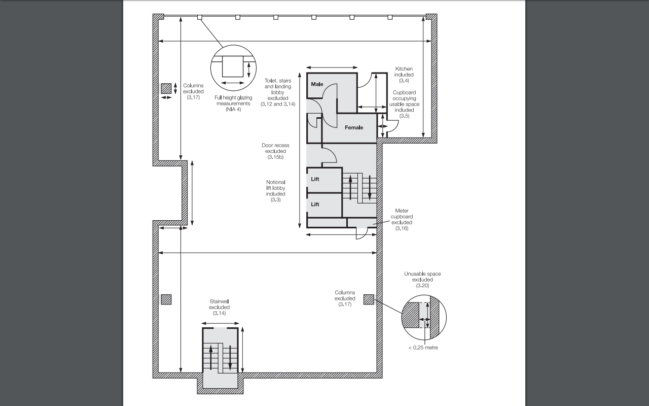

ToughButterCup Posted August 25, 2019 Share Posted August 25, 2019 4 hours ago, PeterStarck said: I've decided it's pointless trying to use cost/m2 as a comparison.[...] Exactly. The issue is somewhat similar to - and related to - calculating the 'area' of a house. Hence the RICS Code of Practice on area measurement. (2018) Our house has two areas which will never be used by anyone - tucked under the lowest part of the roof (not part of the Net Internal Area) annotated in their diagram as 'Unusable Space' I hear @SteamyTea's voice in my head saying "Whats that supposed to mean?" Here reproduced without permission the RICS definition of Nett Internal Area https://www.rics.org/uk/upholding-professional-standards/sector-standards/real-estate/code-of-measuring-practice/ August 2019 1 Link to comment Share on other sites More sharing options...

Patrick Posted August 25, 2019 Share Posted August 25, 2019 10 minutes ago, AnonymousBosch said: Exactly. The issue is somewhat similar to - and related to - calculating the 'area' of a house. Hence the RICS Code of Practice on area measurement. (2018) Our house has two areas which will never be used by anyone - tucked under the lowest part of the roof (not part of the Net Internal Area) annotated in their diagram as 'Unusable Space' I hear @SteamyTea's voice in my head saying "Whats that supposed to mean?" I would be already thankfull if the UK would adapt sqm into the property game in general. No matter how. It seems to be a quite exotic thing to give sqm or price/sqm with built houses/flats , which is ridiculous . Pricing on basis of Bedrooms is a system i can not wrap my head around . It just doesnt make any sense to me why anyone would ever accept this (i can perfectly see the point when selling stuff) In terms of how to measure sqm in houses, i always was under the general impression that it s a widespread acceptable method to measure living space (excluding utility, garages ) by simply multiplying wall lengths, and taking sloping ceiling into account as : everything between 1.5m-2m counts 1/2 , everything under 1.5m is 0 . This works quite well , but the main point is that everybody needs to stick to 1 system , cause the confusion arises with separate systems of calculting and/or measuring are used. Link to comment Share on other sites More sharing options...

Ferdinand Posted August 25, 2019 Share Posted August 25, 2019 2 hours ago, AnonymousBosch said: Exactly. The issue is somewhat similar to - and related to - calculating the 'area' of a house. Hence the RICS Code of Practice on area measurement. (2018) Our house has two areas which will never be used by anyone - tucked under the lowest part of the roof (not part of the Net Internal Area) annotated in their diagram as 'Unusable Space' I hear @SteamyTea's voice in my head saying "Whats that supposed to mean?" Here reproduced without permission the RICS definition of Nett Internal Area https://www.rics.org/uk/upholding-professional-standards/sector-standards/real-estate/code-of-measuring-practice/ August 2019 Exempt under critique and review. ? Link to comment Share on other sites More sharing options...

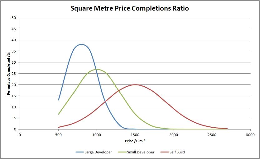

SteamyTea Posted August 25, 2019 Share Posted August 25, 2019 I think I have cracked it. Link to comment Share on other sites More sharing options...
