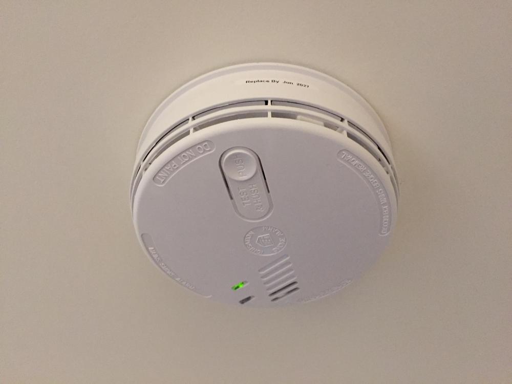

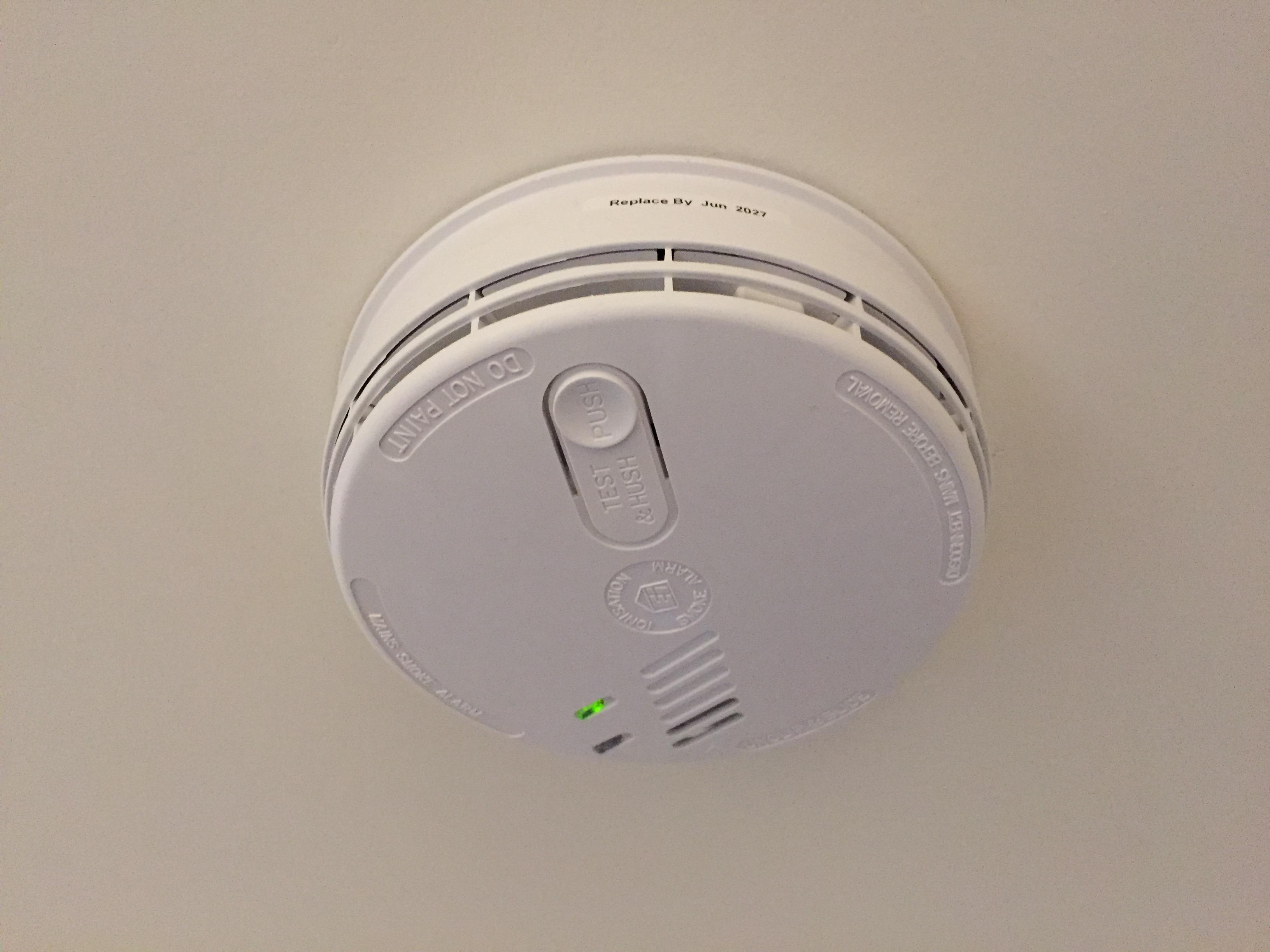

H F Posted August 22, 2019 Posted August 22, 2019 We've been in our house now for a year and we have 8-10 of these smoke alarms throughout the house. This morning we were rudely woken up when all the alarms went off. We rushed from room to room, and there was no fire, semblance of smoke or anything that might have triggered it. Within 2 minutes, the alarms went off. Do we need to have them inspected and checked out? They were installed about 3 years ago, and it says replace by 2027 on the lids. Any advice would be greatly appreciated.
PeterW Posted August 22, 2019 Posted August 22, 2019 Check one isn’t a CO sensor and that has set them off. Not a lot you can really check on an ionization smoke alarm.
daiking Posted August 22, 2019 Posted August 22, 2019 2 minutes ago, PeterW said: Check one isn’t a CO sensor and that has set them off. Not a lot you can really check on an ionization smoke alarm. But are they all ionisation alarms? If theres 8-10 alarms (?) I’d guess some are optical? I’m which case I’d blame spiders not smoke.

ProDave Posted August 22, 2019 Posted August 22, 2019 First thing, they are Aico alarms, imho the best you can get. Don't discount that there may have been an issue, did you have any heating on, anything that could be smouldering? They will trigger long before a room is full of smoke. You should really have a heat alarm in the kitchen, not a smoke alarm. Being Aico you can swap the kitchen ionisation alarm for a heat alarm just by sliding one off it's base and sliding the replacement on. No need for an electrician. Aico sell a clever switch that you can link into the system that when pressed will identify which alarm has triggered, it might be worth getting one of those fitted. 2

H F Posted August 22, 2019 Author Posted August 22, 2019 (edited) 9 minutes ago, ProDave said: Being Aico you can swap the kitchen ionisation alarm for a heat alarm just by sliding one off it's base and sliding the replacement on. No need for an electrician. That's really interesting. I will definitely look into it. We were still in bed when they went off, and no signs of anything untoward anywhere in the house. I will also look into the switch you mentioned, because running around the house was a bit comical this morning. Edited August 22, 2019 by Home Farm
H F Posted August 22, 2019 Author Posted August 22, 2019 4 minutes ago, ProDave said: Aico sell a clever switch that you can link into the system that when pressed will identify which alarm has triggered, it might be worth getting one of those fitted. I assume that we will need an electrician to fit this?
ProDave Posted August 22, 2019 Posted August 22, 2019 6 minutes ago, Home Farm said: I assume that we will need an electrician to fit this? This is the device https://www.ebay.co.uk/itm/Aico-Ei1529rc-Ei1529-Alarm-Remote-Test-Hush-Locator-Switch/293030933347?epid=2254772143&hash=item443a013363:g:hNIAAOSw4oFcoikA You don't legally need an electrician, it depends on your competence. It will need to connect with a bit of 1mm 3 core and earth cable to any one of the existing smoke alarms, and that usually boils down to which is easiest to get access to. Usually an upstairs one with access from a loft above.

Ferdinand Posted August 22, 2019 Posted August 22, 2019 (edited) 55 minutes ago, Home Farm said: The noise that comes out these things is piercing - really gives the nervous system a jolt. Not a great way to get woken up and the poor cats got the fright of their lives. (Updated - spotted that they are hard wired). It is the case that fire alarms sometimes go off for spurious reasons. Usually test and no need to worry. Aico are a good recoognised brand, and it sounds as if you have the 10 year rechargeable battery wired interlinked type. I would check that your system has what is needed - especially CO by any gas appliances and a Heat (toast proof) alarm in the kitchen (use the one from there somewhere else if appropriate). Who knows, by 2027 you may want to do sprinklers instead. I can see an argument for sprinklers in a house like yours - relatively isolated and old, and by 2027 Wales may have made the general market price lower. You recently expressed wallet-pain, and a full set of kit could be (guestimating) about £500 or more, depending what level of features you go for. When I did AICO wired in my mst recent refurb (5-6 rooms plus hall), the bits were the best part of £250 or a little more. Ferdinand Edited August 22, 2019 by Ferdinand

Nickfromwales Posted August 22, 2019 Posted August 22, 2019 I routinely fit those switches as there is just no way of determining where a detection has occurred otherwise. They hush, and you can test with them too, great when you have vaulted ceilings. 2 minutes ago, Home Farm said: always willing to give it a go with my burgeoning DIY skills. It's a tight fit getting 2 sets of cables into a smoke base, so try and find the last one to connect the cables for the switch as it'll only have a single cable at the moment. Be very careful that all 3 wires are in and tight if you go for one that has 2 wires in it already, and normal practice would be to tug on each individual cable after you're done tightening up to see if any of them just 'pop out' Just remember if you interfere with the smoke detection cabling along the rout through the house, and you bugger it up, you may have inadvertently removed the trigger wire from a lot of downstream detectors, so beware. Test everything thoroughly afterwards ! 1
ProDave Posted August 22, 2019 Posted August 22, 2019 Good point about multiple wires. The junction boxes are not big, and if the existing are wired in 1.5mm cable, you may struggle to get a third one in. I can never understand why people use 1.5, in most cases 1mm is fine and a lot easier. And good point about CO alarms. As well as it should be a heat alarm in a kitchen, you should also have a CO alarm in any room with a combustion appliance, and a room that a flue pipe passes through. Aico do a handy combined heat and CO alarm, but they don't do a matching combined smoke and CO alarm (when I asked them recently they said they are thinking about it) Which irritated a recent customer who now has separate smoke and CO alarms on his living room ceiling.
