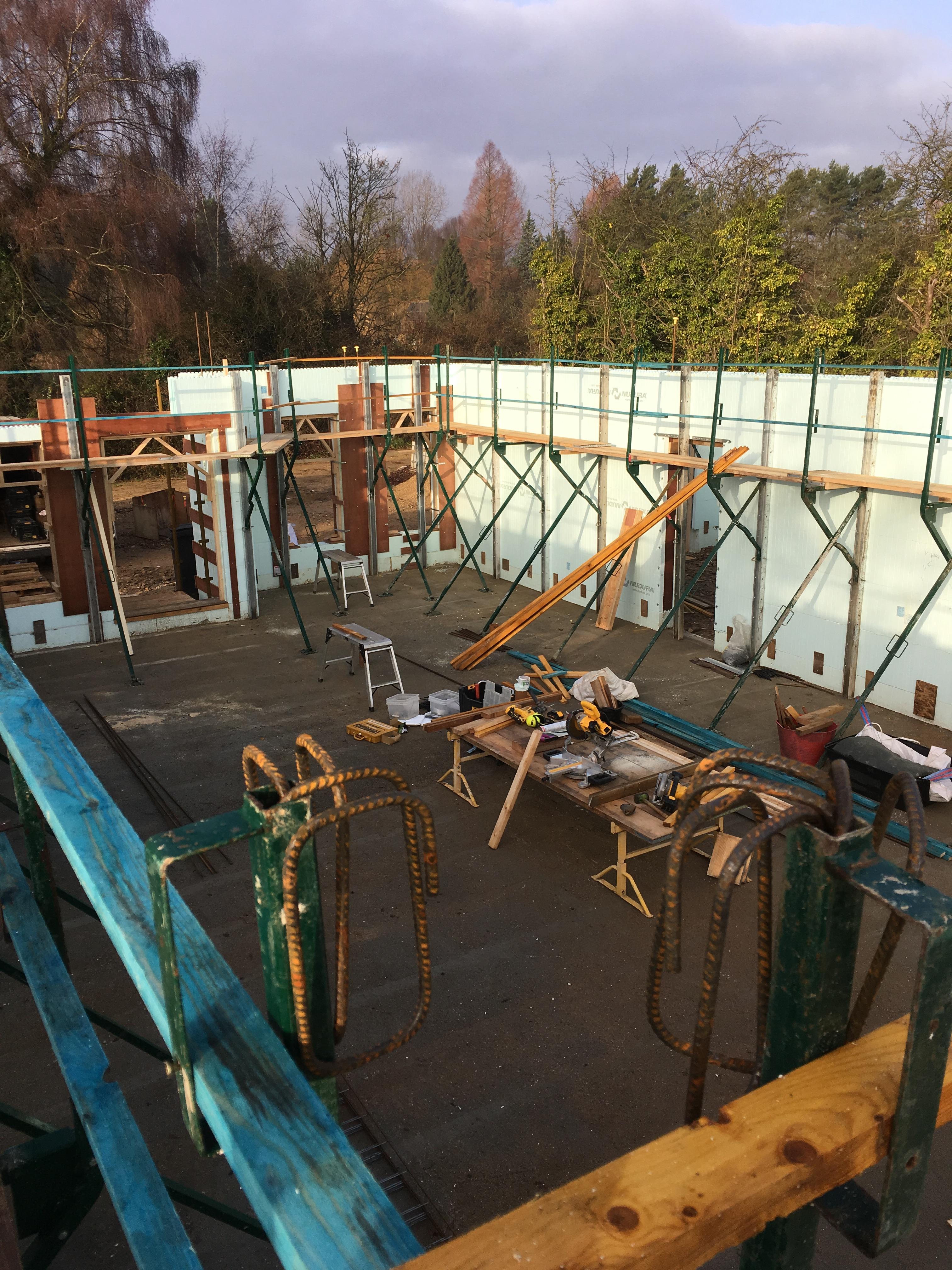

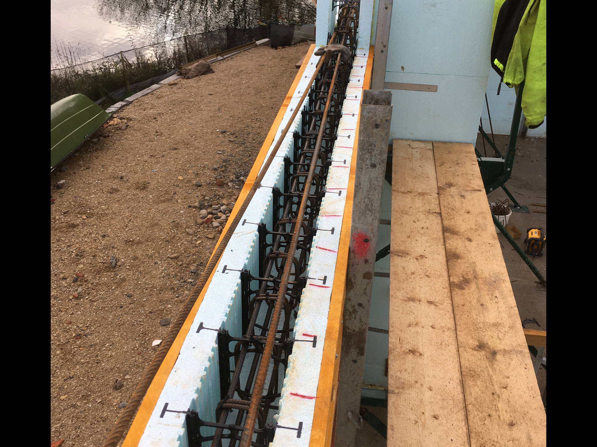

Russell griffiths Posted August 21, 2019 Share Posted August 21, 2019 dont buy a tool you will never manoeuvre it in the wall it is a major pain in the arse, what you use are cable ties, you thread your links onto the bottom two bars and lift up as high as you can, insert a couple of chunks of 4x2 to keep it lifted high, then tie all your bottom links with the cable ties, when done remove the 4x2 and lower the cage into the wall, then slide in the top 2 bars and tie them. My longest lintel we made on site was just over 9m long with 16mm bars top and bottom, you would never lift it without mechanical assistance. Give me a call if you need a better explanation. Link to comment Share on other sites More sharing options...
Russell griffiths Posted August 21, 2019 Share Posted August 21, 2019 Poor picture Link to comment Share on other sites More sharing options...

Russell griffiths Posted August 21, 2019 Share Posted August 21, 2019 7 minutes ago, PeterW said: I thought a lot of the ICF has plastic or metal webs so you only need horizontal rebar..?? Your rebar in icf is dependant on span, openings upto 900mm require just a couple of bits of 16mm bar straight across opening, larger spans get a bit more detailed. My 4m openings had 4x12mm straight bar, with links every150mm but my cantilevered sections had 16mm bar top and bottom the links are the smallest my rebar supplier could bend on their machine. Link to comment Share on other sites More sharing options...
Vijay Posted August 21, 2019 Author Share Posted August 21, 2019 1 hour ago, Russell griffiths said: dont buy a tool you will never manoeuvre it in the wall it is a major pain in the arse, what you use are cable ties, you thread your links onto the bottom two bars and lift up as high as you can, insert a couple of chunks of 4x2 to keep it lifted high, then tie all your bottom links with the cable ties, when done remove the 4x2 and lower the cage into the wall, then slide in the top 2 bars and tie them. My longest lintel we made on site was just over 9m long with 16mm bars top and bottom, you would never lift it without mechanical assistance. Give me a call if you need a better explanation. Never though of cable ties, but access isn't really a problem with Polarwall as I can fit the ICF panels as I go Link to comment Share on other sites More sharing options...

Russell griffiths Posted August 21, 2019 Share Posted August 21, 2019 If access isn’t a problem, you just need a pair of nippers and a roll of tie wire. Simple job to tie it all up and then add your panels mine had to be threaded through the internal webs. Link to comment Share on other sites More sharing options...

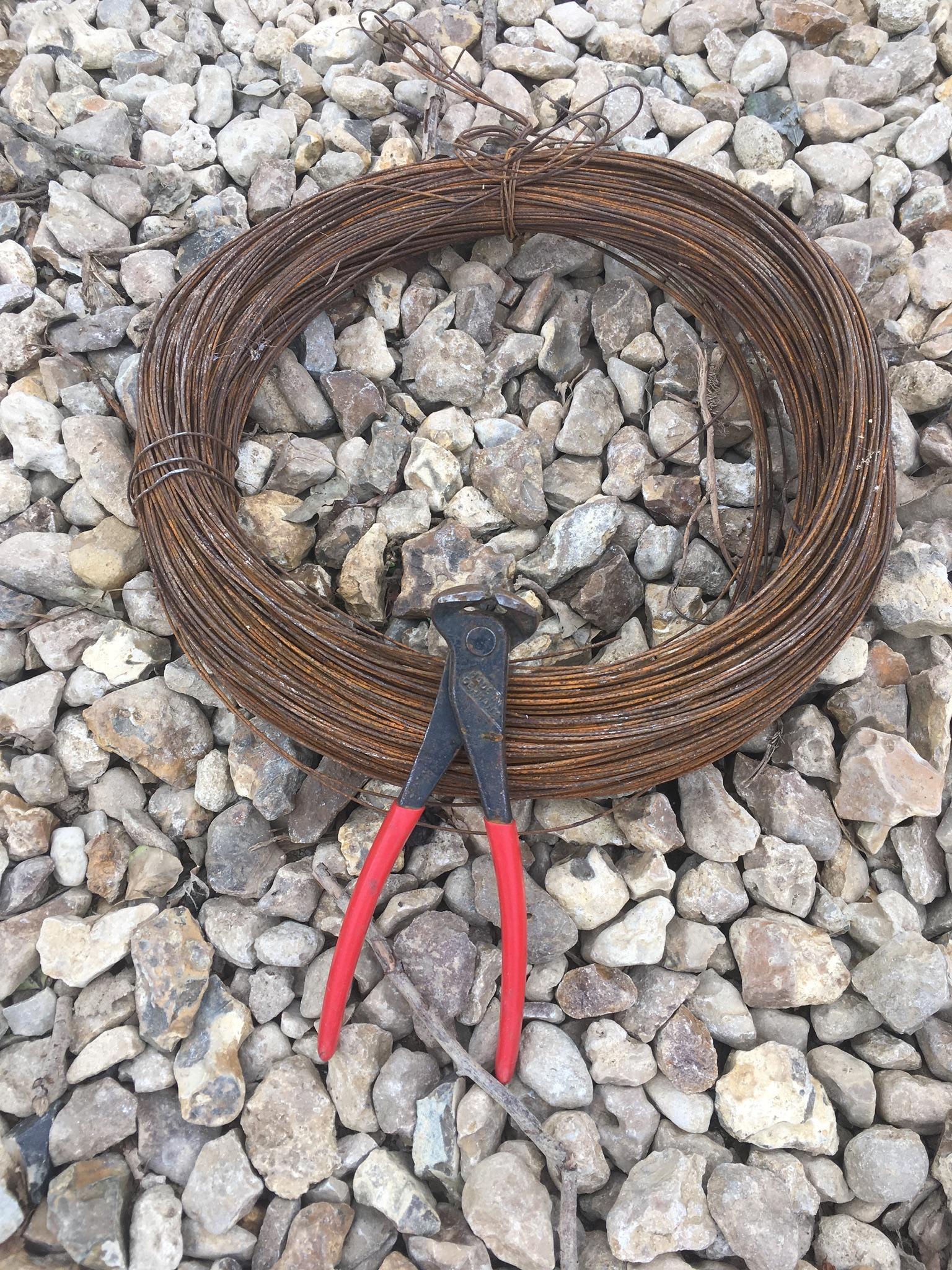

Vijay Posted August 23, 2019 Author Share Posted August 23, 2019 Thanks everyone. Ordered some rolls or wire and a manual twist tool and I'll see how I get on. Onoff, will knock up one of those drill twist hooks too Link to comment Share on other sites More sharing options...
Russell griffiths Posted August 23, 2019 Share Posted August 23, 2019 roll of wire and a pair of nippers also. Link to comment Share on other sites More sharing options...
