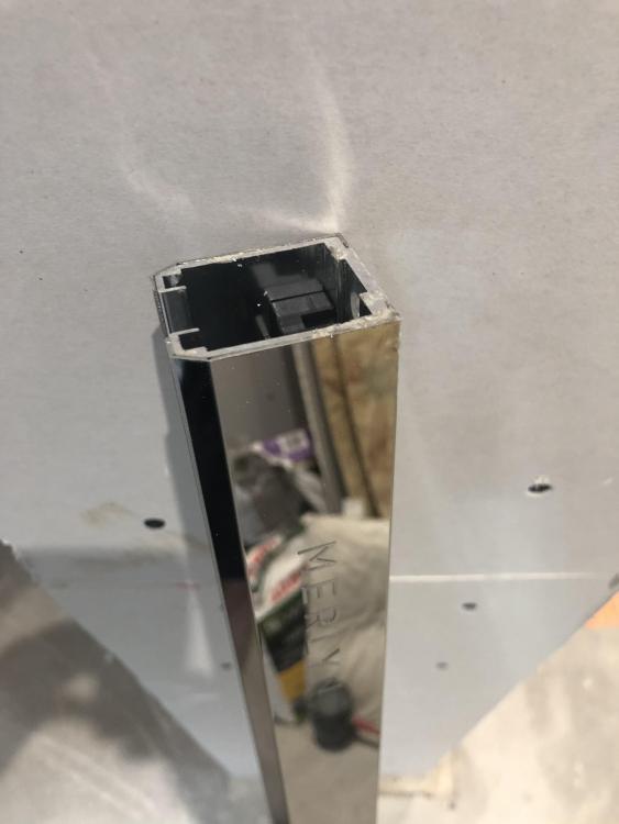

Pocster Posted April 14, 2021 Author Share Posted April 14, 2021 Can’t ct1 another bit as it has a spring clip that would get stuffed !! Link to comment Share on other sites More sharing options...
Pocster Posted April 14, 2021 Author Share Posted April 14, 2021 These are hard to install on your own ! Also I’m about 1mm out and it causes issues !!! . No one will notice of course ! apart from you gits because I’ve said so ? Link to comment Share on other sites More sharing options...

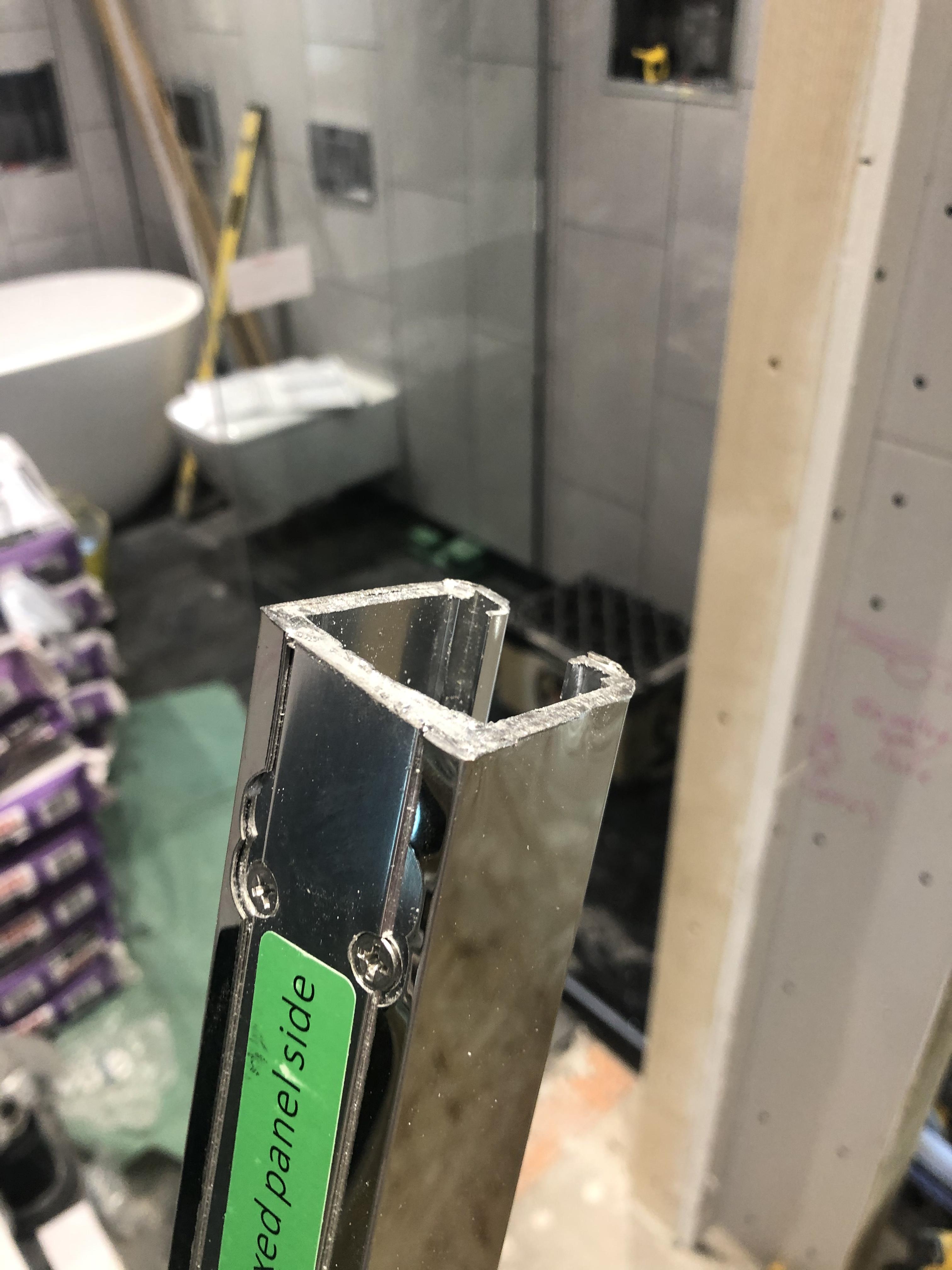

Pocster Posted April 14, 2021 Author Share Posted April 14, 2021 Confused ! The sliding door stops are in the rail - their position can’t be adjusted . Closing the door causes this gap due to the top door stop ? Link to comment Share on other sites More sharing options...

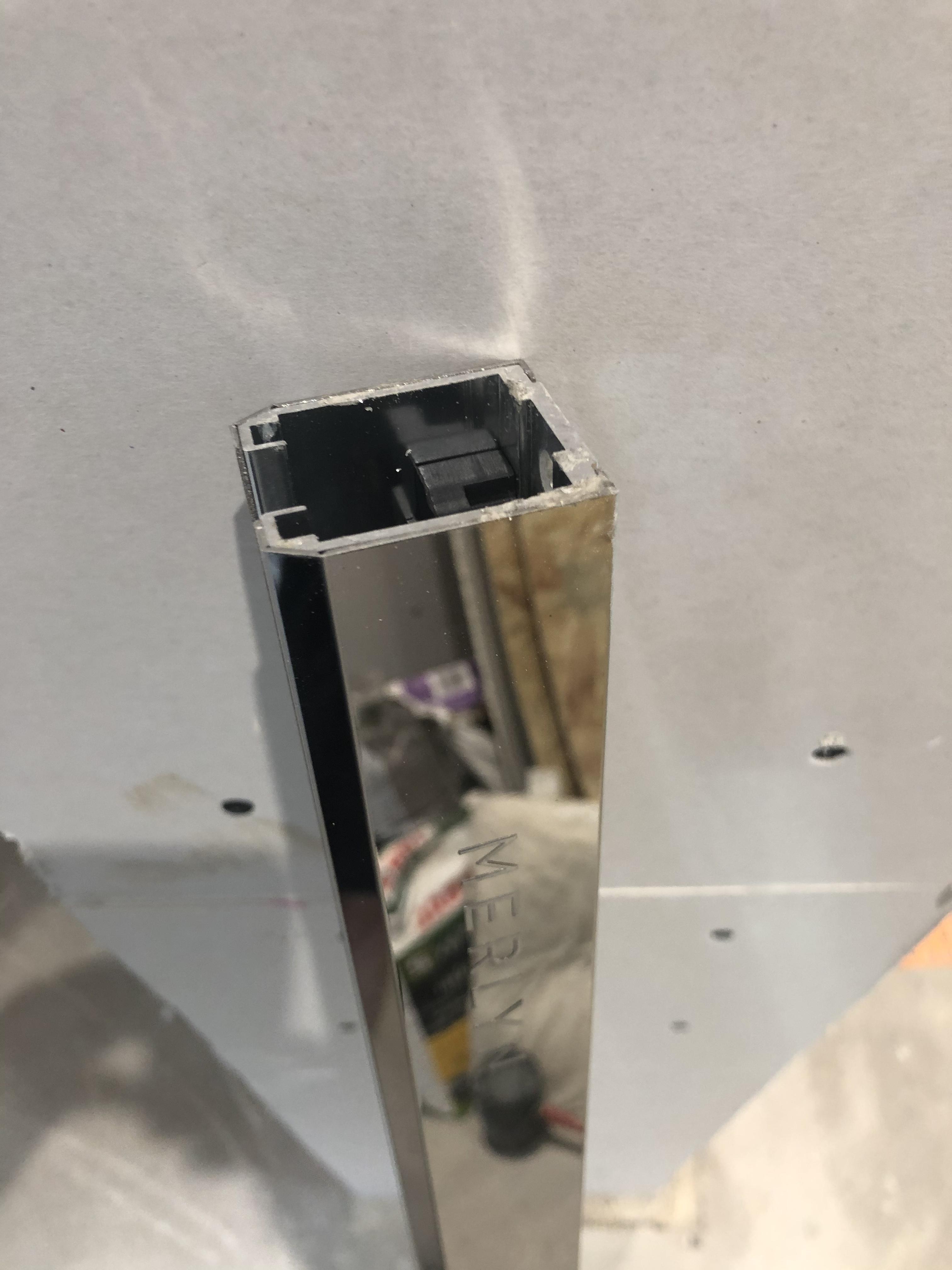

Pocster Posted April 14, 2021 Author Share Posted April 14, 2021 Quick phone call to Merlyn ; apparently the seal is around 15mm for the edge ! . Guess I’d better find it !! ? Link to comment Share on other sites More sharing options...
Pocster Posted April 14, 2021 Author Share Posted April 14, 2021 5 hours ago, pocster said: The top piece Nice edge and other end , cut by blind left handed man . Bear in mind I filed it a bit better ! Supplied like that I should add !! Link to comment Share on other sites More sharing options...

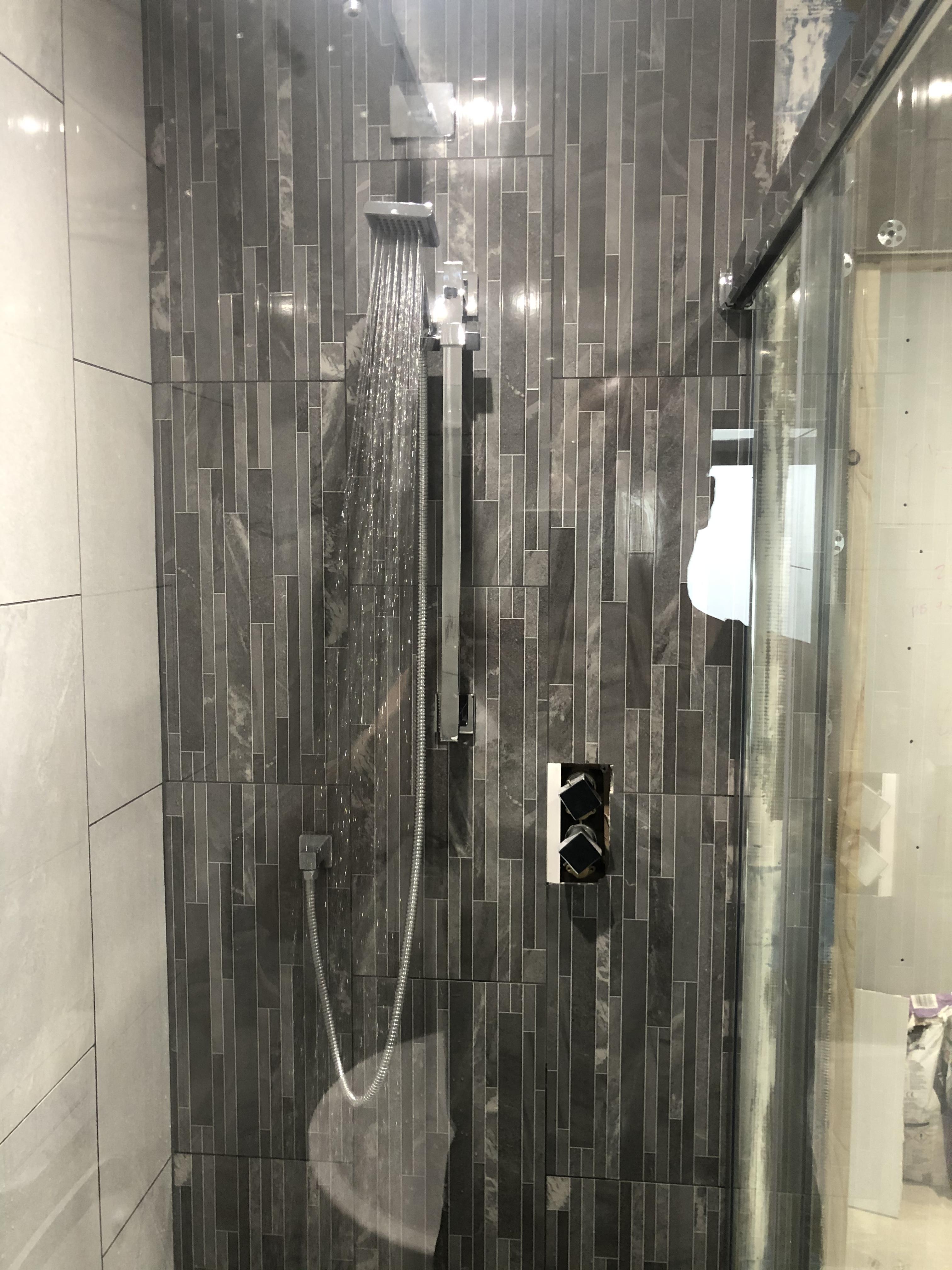

Pocster Posted April 20, 2021 Author Share Posted April 20, 2021 Preliminary test of ensuite shower seems good . Just the shower waste to connect up Link to comment Share on other sites More sharing options...
Pocster Posted May 10, 2021 Author Share Posted May 10, 2021 After numerous leaks ? Ensuite and shower constantly running seem leak free now ..... 1 Link to comment Share on other sites More sharing options...
Pocster Posted May 10, 2021 Author Share Posted May 10, 2021 For now .... ? Link to comment Share on other sites More sharing options...

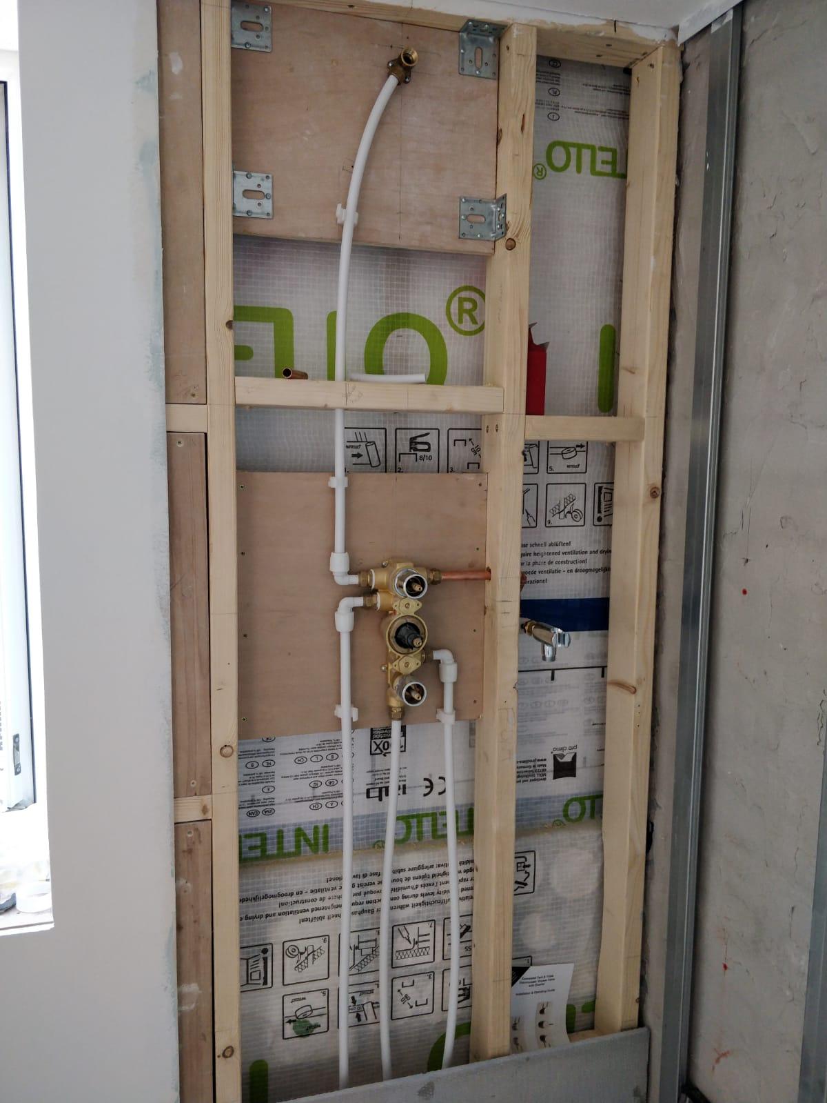

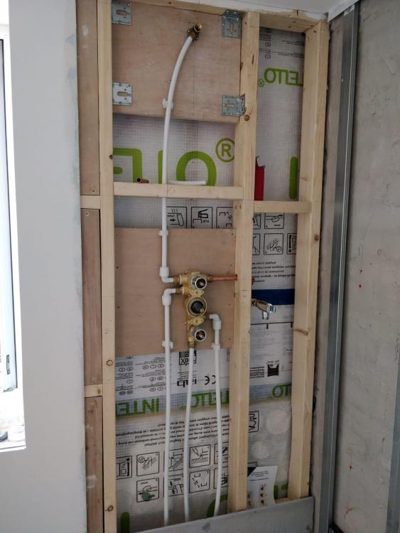

AdamSee Posted February 23, 2023 Share Posted February 23, 2023 On 28/02/2020 at 13:08, AdamSee said: Yes I can access it from the front by pulling off the panel. Previously I've plaster boarded the framework up. But you could easily cut through it to fix it. Just how inaccessible will yours be? I would guess that the worst case would be tiles on cement board in front of it. I always try to make things accessible, but in reality its not always possible. Second best option would be to be able to see it via a endoscope/camera. I've yet to have a leak from a hep2o, I would be more worried about having a brass connector in there. This is my shower setup. consisting of several compression fittings on to hep2o pipe and 4no. 3/4" to 1/2" bsp reducers. This is 100% inaccessible or visible. I do wonder a lot of the time as to whether its dripping away behind there or something. All I can do it try to take comfort in the fact that I left it pressurised for 24h without a sign of leaking. But at the end of the day, if it does leak, I have the ability to fix it and finally get rid of the bloody P-Bath. Sweet looking bathroom pocster. Hopefully it remains leek free. Funny story relating to my post about my shower build....it eventually leaked. Not from a fitting, but from the diverter valve. Getting the faceplate off was a pain in the ass due to vast quantity of silicone use. Tried dental floss, rubbish. Got it off using two wall paper scrapers in the end. Had to replace the diverter in the end, and resealed it using minimal silicone this time. Best of luck! 1 Link to comment Share on other sites More sharing options...
Pocster Posted February 23, 2023 Author Share Posted February 23, 2023 (edited) 2 hours ago, AdamSee said: Sweet looking bathroom pocster. Hopefully it remains leek free. Well it’s been around 15 months - no leaks ( from the shower or bathroom ) . Regarding the face plate I didn’t put any silicone under the bottom part . Logic being I should be able to slip a razor blade under there and cut the silicone around the other 3 sides . How practical that is remains to be seen 🙄 Edited February 23, 2023 by pocster Link to comment Share on other sites More sharing options...
