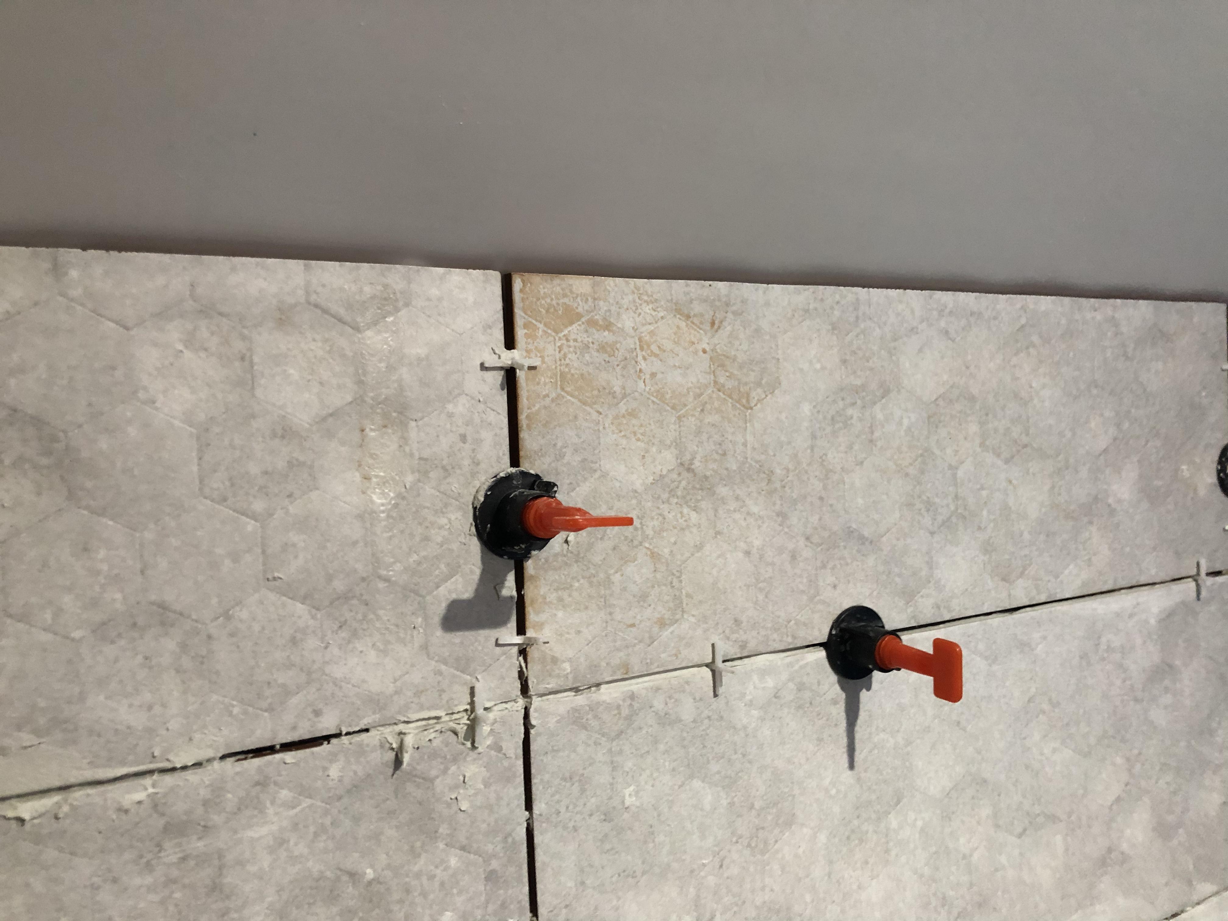

Pocster Posted September 1, 2020 Author Posted September 1, 2020 2 minutes ago, Big Jimbo said: I hate tiling.....When ever i have seen pro tilers, they always use the little plastic wedges, rather than spacers. I asked one fella why, and he said that no matter how much you pay for tiles, they are never exactly the same size. Bloody tiling..... That’s true . I can actually see the difference in size and even thickness in my tiles . (expletive deleted)ing expensive rubbish . So stick a nice metal trim as tight to the ceiling as I can get ( whilst being level ! ) then tile upto it with my pro skills 1
Big Jimbo Posted September 1, 2020 Posted September 1, 2020 8 minutes ago, pocster said: That’s true . I can actually see the difference in size and even thickness in my tiles . (expletive deleted)ing expensive rubbish . So stick a nice metal trim as tight to the ceiling as I can get ( whilst being level ! ) then tile upto it with my pro skills Sounds like a plan.

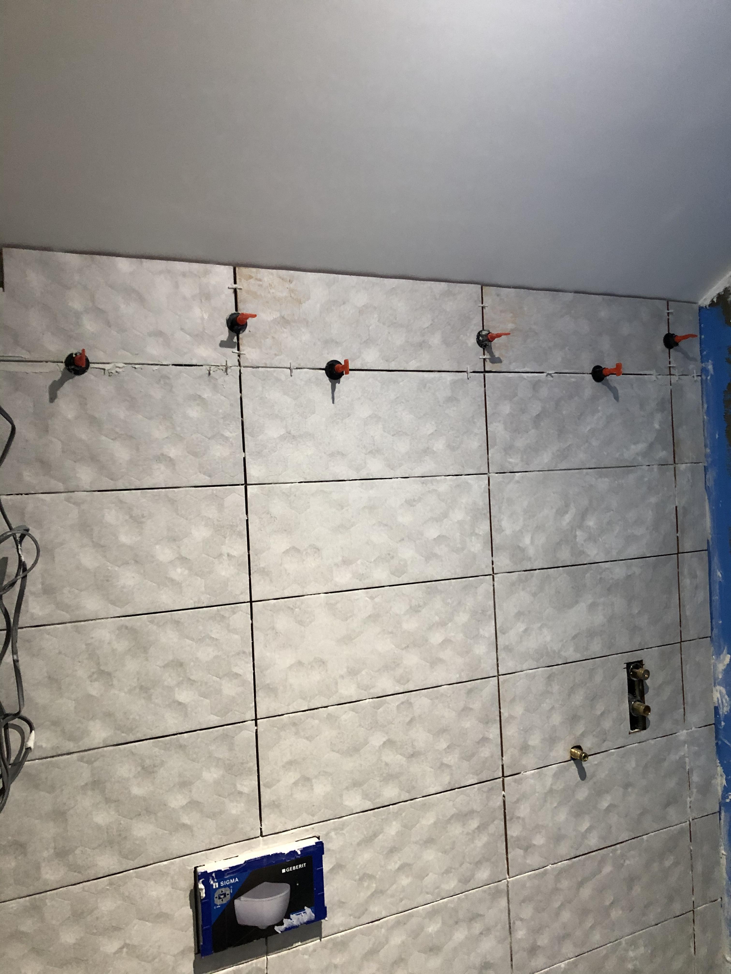

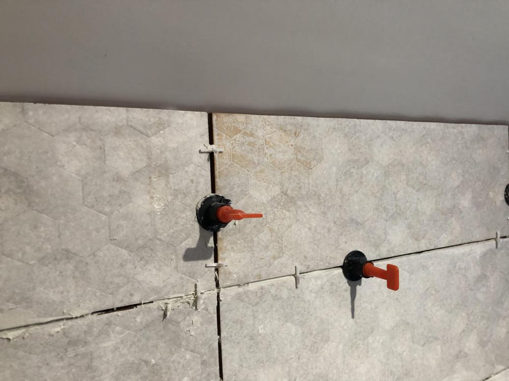

Pocster Posted September 1, 2020 Author Posted September 1, 2020 It will surprise none of you that the levellers come out much easier on the same day they went in ? I Hope @Mr Punter likes his ensuite I’m doing for him

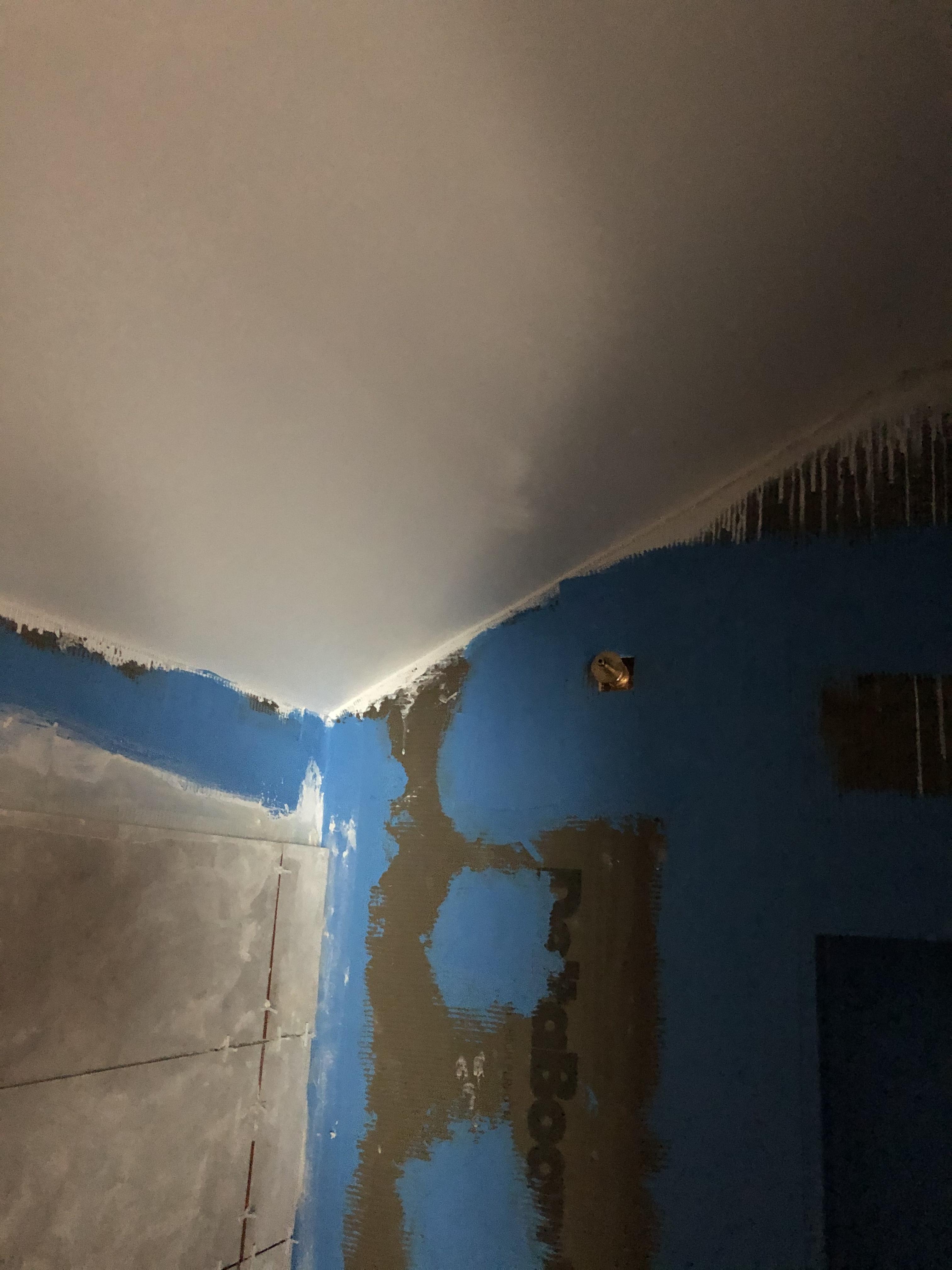

Pocster Posted September 1, 2020 Author Posted September 1, 2020 (edited) But If I use trim on that wall won’t it look odd it doesn’t continue up the angled ceiling edge ?? Edited September 1, 2020 by pocster
Gav_P Posted September 1, 2020 Posted September 1, 2020 9 minutes ago, pocster said: It will surprise none of you that the levellers come out much easier on the same day they went in ? I Hope @Mr Punter likes his ensuite I’m doing for him I expect the adhesive comes off the tile face a lot easier too! 2
Big Jimbo Posted September 1, 2020 Posted September 1, 2020 Yes it will. skip the trim, and cut them as tight to the ceiling as you can. Mitre off the back top edge to make sure they don't kick out. 2 1
Gav_P Posted September 1, 2020 Posted September 1, 2020 (edited) 4 minutes ago, pocster said: But If I use trim on that wall won’t it look odd it doesn’t continue up the angled ceiling edge ?? If it were me, I would tile up to the ceiling, then either grout or silicone between tile and ceiling. silicone will hide the cut edges too Edited September 1, 2020 by Gav_P 1

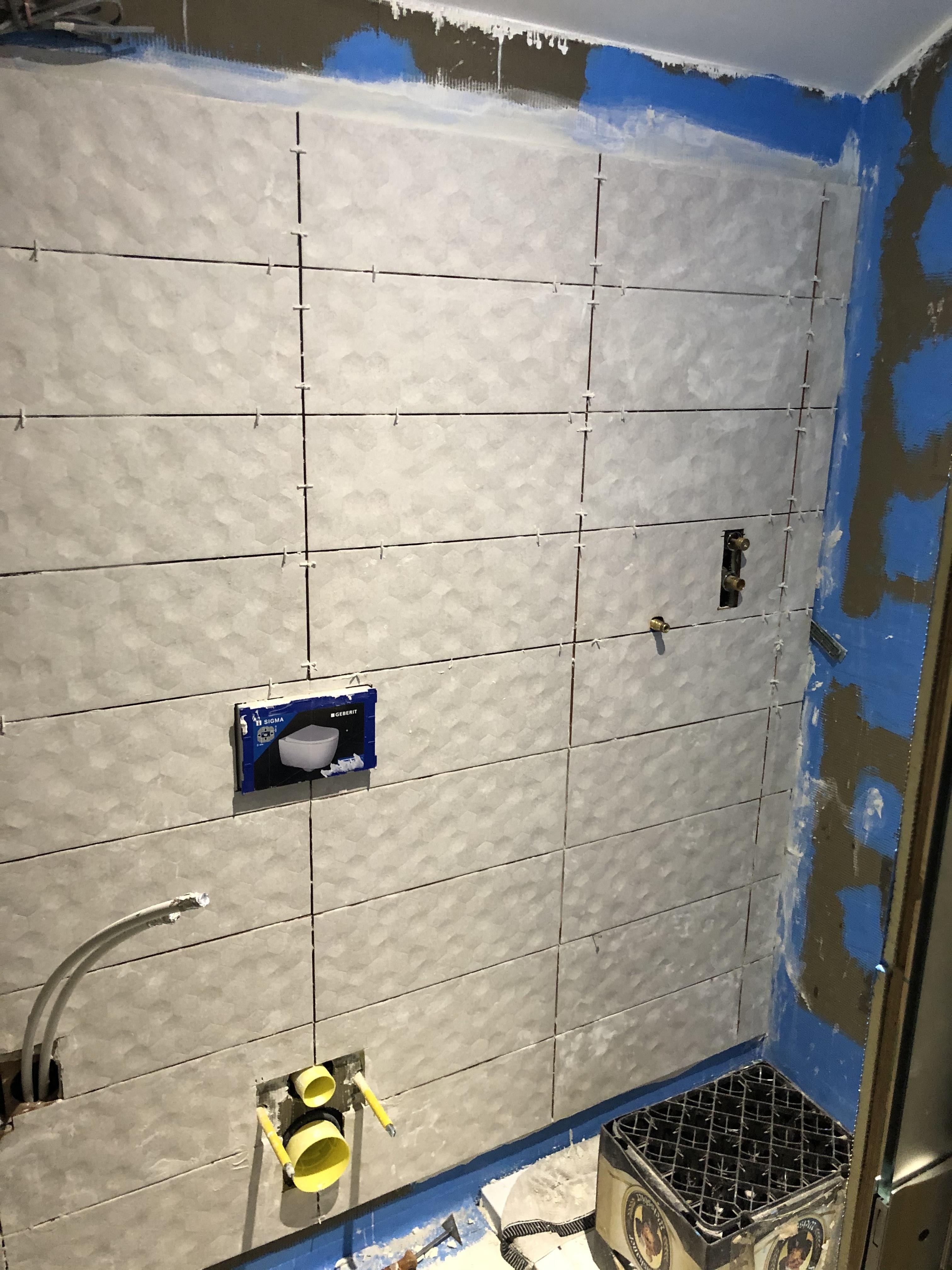

Pocster Posted September 2, 2020 Author Posted September 2, 2020 That wall done . As tight to the ceiling as I can get . It’s going to be a dog to Mastik . Might find a simple white plastic bead to stick on instead . 1
Onoff Posted September 2, 2020 Posted September 2, 2020 Chrome / silver quadrant? https://www.floorstowalls.co.uk/products/quadrant?
Pocster Posted September 2, 2020 Author Posted September 2, 2020 55 minutes ago, Onoff said: Chrome / silver quadrant? https://www.floorstowalls.co.uk/products/quadrant? Not sure . I think the beading there shouldn’t say ‘ look at me ‘ unlike the profile edging . So perhaps plain white

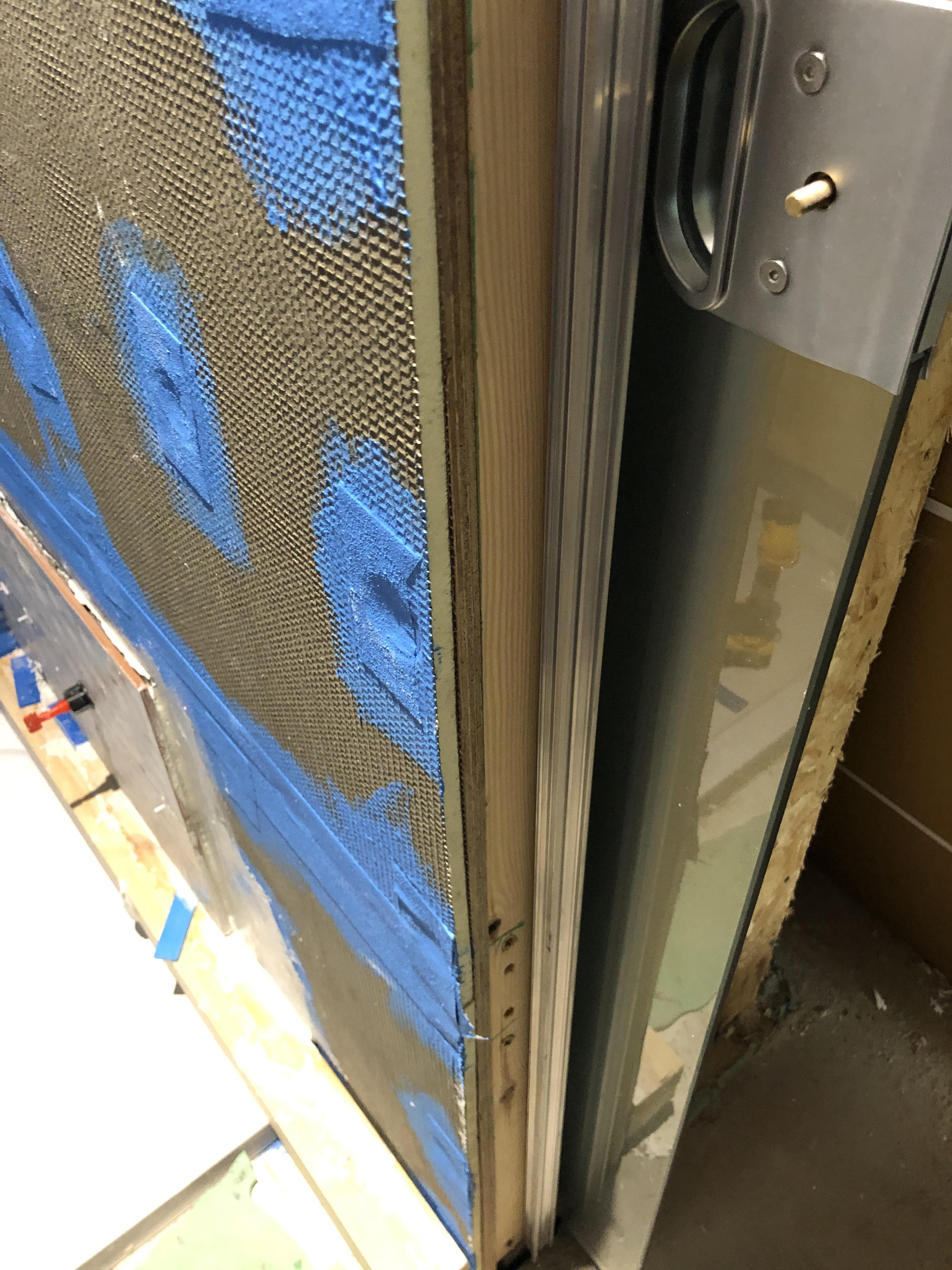

Pocster Posted September 2, 2020 Author Posted September 2, 2020 So on this wall return to the metal door surround . Just ct1 tiles to the timber ? . Assume that’s more than enough to hold them ( not very wide as you can see )

Onoff Posted September 2, 2020 Posted September 2, 2020 10 minutes ago, pocster said: So on this wall return to the metal door surround . Just ct1 tiles to the timber ? . Assume that’s more than enough to hold them ( not very wide as you can see ) I used CT1 Grab n Bond to stick tiles to marine ply.
Pocster Posted September 2, 2020 Author Posted September 2, 2020 (edited) 2 minutes ago, Onoff said: Normal ct1 not good enough ? So any tubed adhesive would be ok . Only mention ct1 as that’s whats to hand . Edited September 2, 2020 by pocster
Onoff Posted September 2, 2020 Posted September 2, 2020 10 minutes ago, pocster said: Normal ct1 not good enough ? So any tuned adhesive would be ok . Only mention ct1 as that’s whats to hand . Tbh I ran out of Grab n Bond so when it came to doing the tile reveal which was lined with 27mm Gyproc insulated pb, I used CT1, Sticks Like Sh!t, The Dogs B@llocks...whatever.

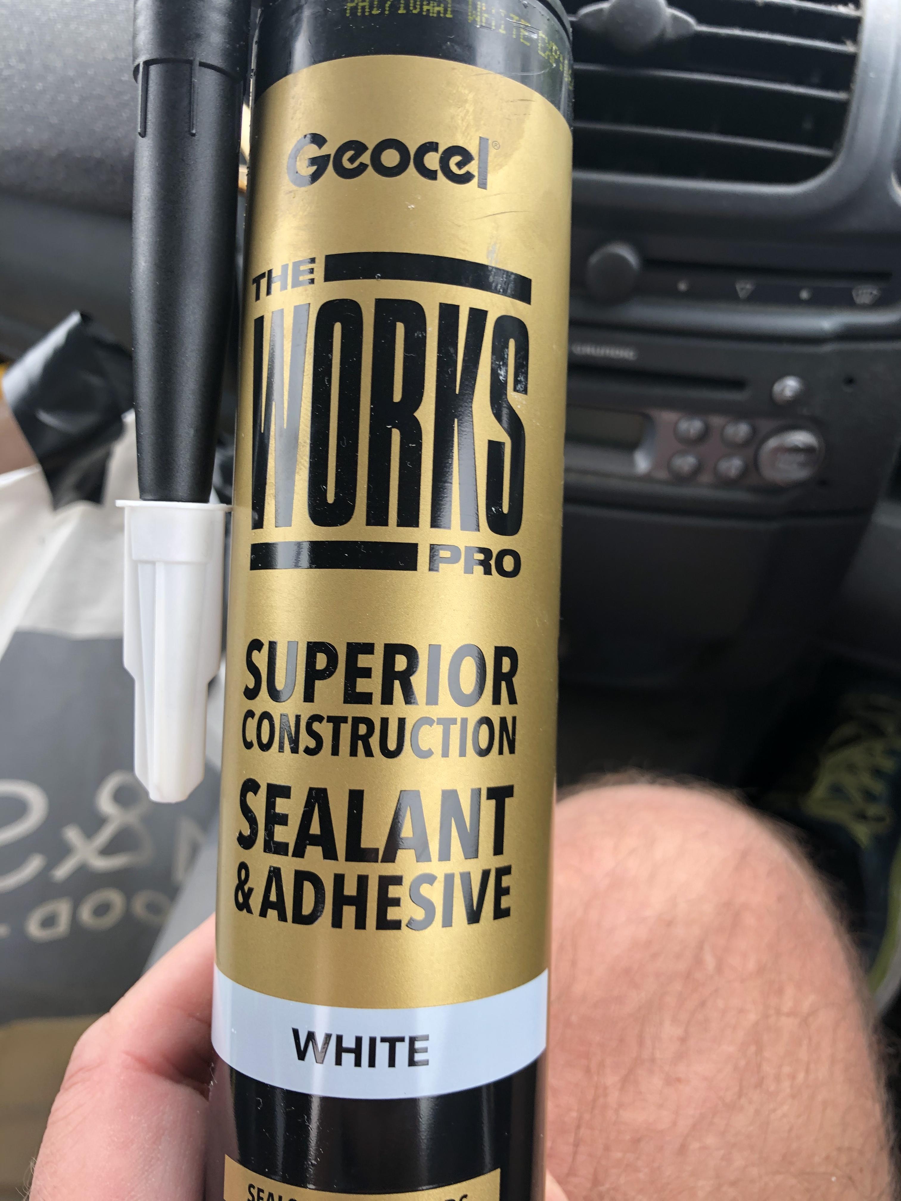

Pocster Posted September 2, 2020 Author Posted September 2, 2020 BM said this stuff will apparently stick anything to anything. I did ask if I could use it on SWMBO mouth . He said it wasn’t that good !
Onoff Posted September 2, 2020 Posted September 2, 2020 7 minutes ago, pocster said: BM said this stuff will apparently stick anything to anything. I did ask if I could use it on SWMBO mouth . He said it wasn’t that good ! Why not stick half on with this and the rest with CT1. Like the Head n Shoulders advert! 1
PeterW Posted September 2, 2020 Posted September 2, 2020 17 minutes ago, pocster said: BM said this stuff will apparently stick anything to anything. I did ask if I could use it on SWMBO mouth . He said it wasn’t that good ! He would as he sells it ... How much a tube has he taken you for ..??
Pocster Posted September 2, 2020 Author Posted September 2, 2020 6 minutes ago, PeterW said: He would as he sells it ... How much a tube has he taken you for ..?? Yeah it was expensive! I did frown . On the shelf price was some like £14.50 I’ll get it for less on account by maybe 10% To make up for the extortion I’ll nick a tube next time . Put it down the front of my trousers . No one would notice the difference ? 1 1
Pocster Posted September 2, 2020 Author Posted September 2, 2020 (edited) The thing is my BM is local so obviously if I need it ASAP it's convenient . Also they usually only sell high markup brands like schulter ,Geocel entire range. So *choice* is limited. Edited September 2, 2020 by pocster
Pocster Posted September 2, 2020 Author Posted September 2, 2020 2 hours ago, pocster said: BM said this stuff will apparently stick anything to anything. I did ask if I could use it on SWMBO mouth . He said it wasn’t that good ! BTW that large pink hairy mass to the lower right is my knee ?
