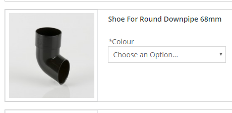

I'm planning a shoe over the gully.

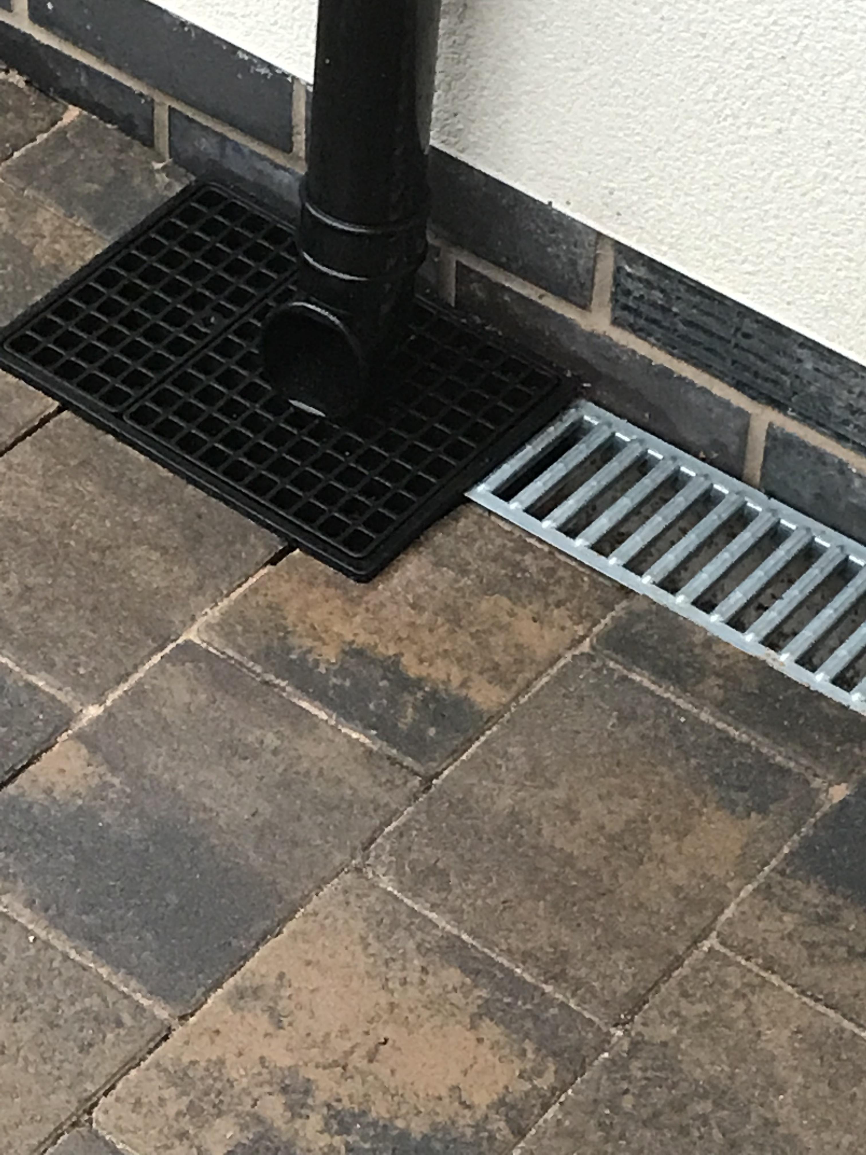

Same here. I noticed that one of my temporary downpipes which is sitting on the grate quite tight as it's not fixed to the wall, was not draining so wiggled a brick tie underneath and the water came out with a lot of pressure. Was just full of crud, having a shoe and gully will allow me to keep the water flowing.

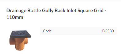

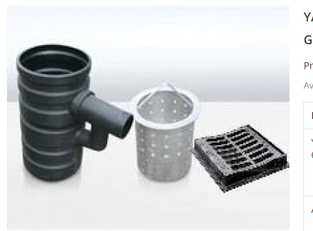

We are surrounded by trees too so crud is a definite (got plenty already, dripping of the edges of the roof, as no gutters yet!).  So a shoe over a gully?  Like this?
Over this sort of thing?
with a silt bucket thing in which presumably needs emptying regularly.

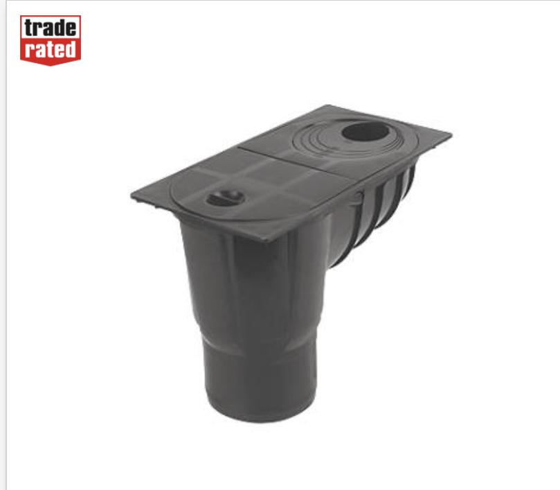

Or this (below)?  A simpler (cheaper) gully.  Both options (if I use a spout) seem to require the grid on the top to catch the crud and with pine needles and small debris being most of my crud I am not sure whether this is sufficient?
Do I then need to open up the gully top regularly to clean it out?  Was trying to be low maintenance but accept that direct access may result in increased crud (even with a hedgehog in the gutter).  Will either of these options filter out sufficient crud?

Use  a hopper with integral leaf filter
https://www.screwfix.com/p/floplast-d94-debris-gully/

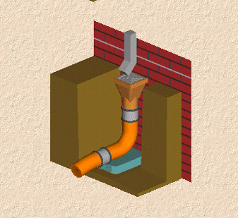

What does this look like underground?  90 degree bend going into what?  A gully before it?  Like this (courtesy of pavingexpert.com)

7 hours ago, Weebles said:
Sounds like we will have the same problem with the trees.

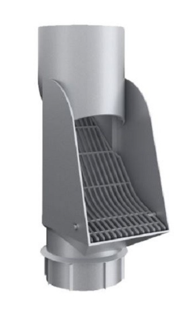

Out of interest, why not one of these, and then straight in? (I will have the same problem with trees.)
https://guttercentre.co.uk/Lindab-Self-Cleaning-Leaf-Trap-For-Downpipes-SLS
I’ve used these on a commercial build and they are good but in heavy rain they will splash a lot and can throw water and leaves quite a distance.

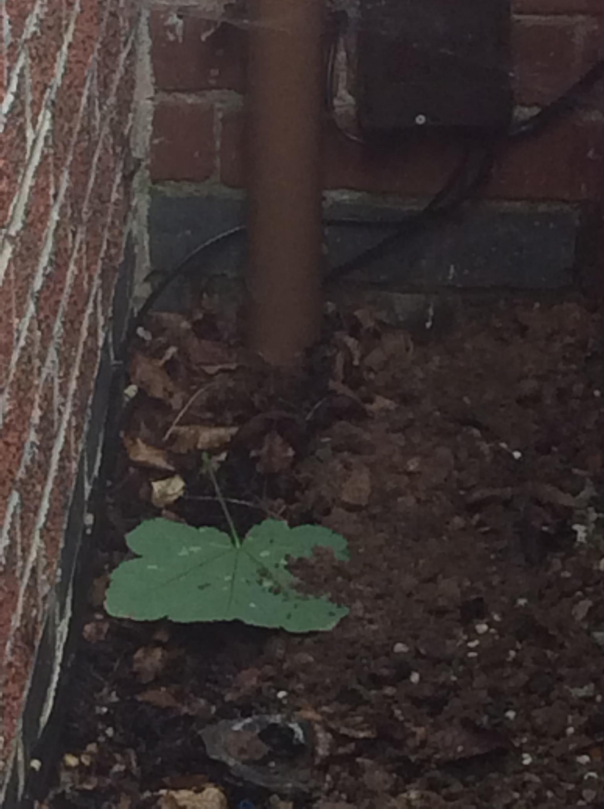

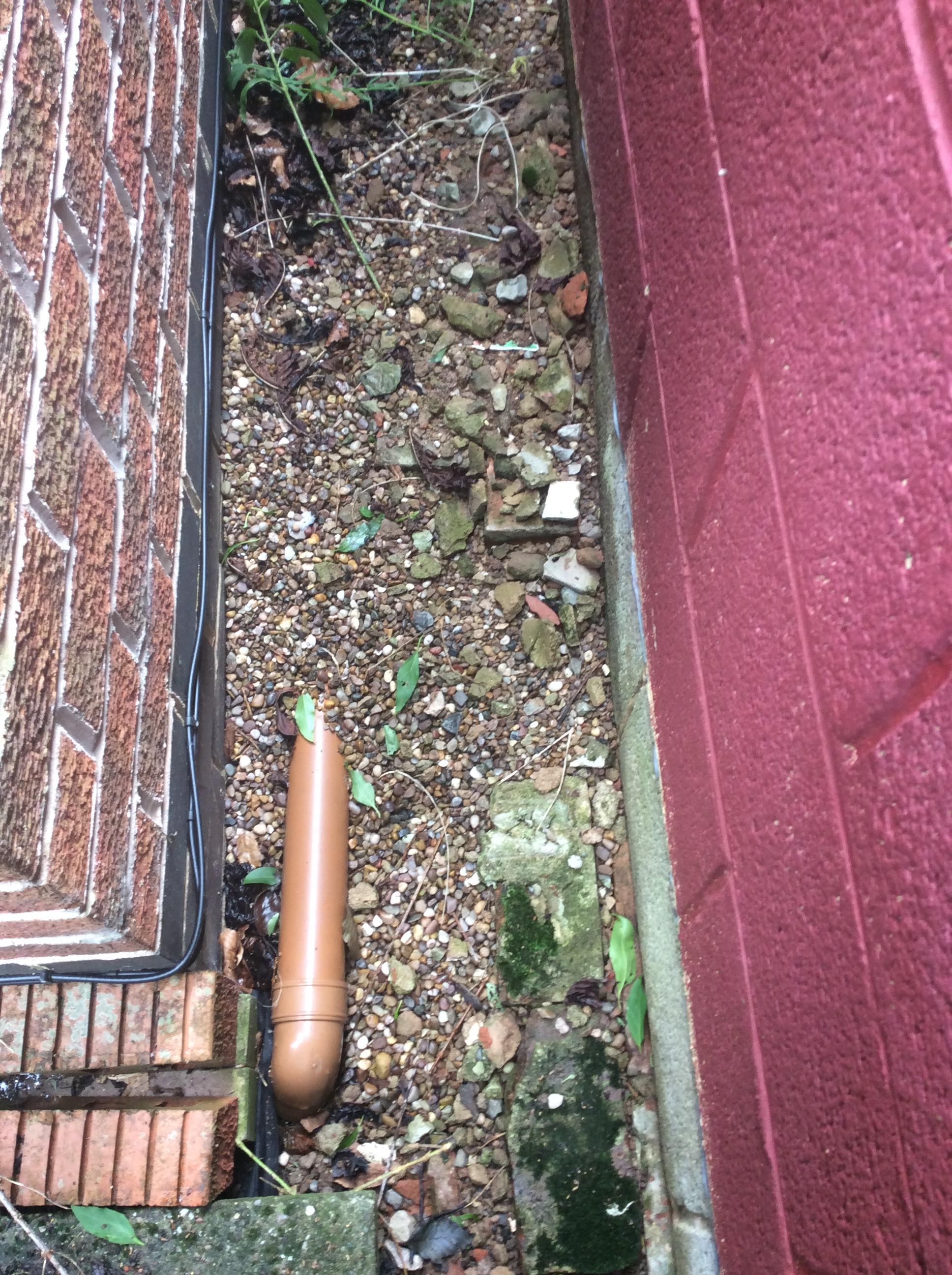

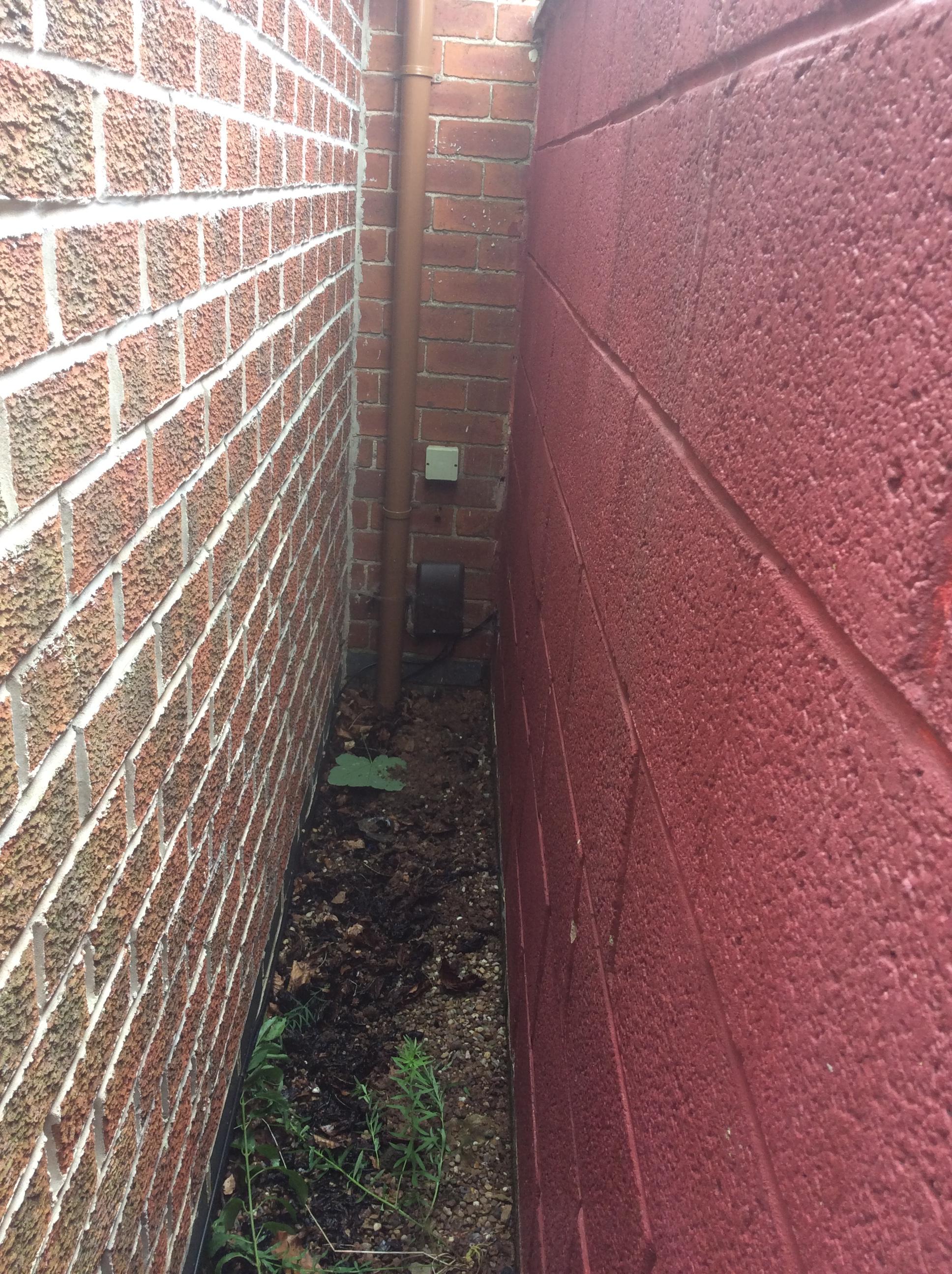

These are the two with which I have to deal.
The easy one which was wedged on the grill. Now propped up a couple of inches. May just need a pipe trim or one of those chute things.
Difficult one. pipe runs down the wall, and along under the gravel, round the corner and on to the drains 6m away. That wall also has to have my split aircon going through it.

We have trees almost overhanging our flat roof. A lot of leaves shed in autumn.  Blockage risk seems pretty high so the bottle gully with a grid and a spouted downpipe seems like the way to go. Maybe not as neat but infinitely less risky with the leaves and will all be at the rarely visited rear of the house.

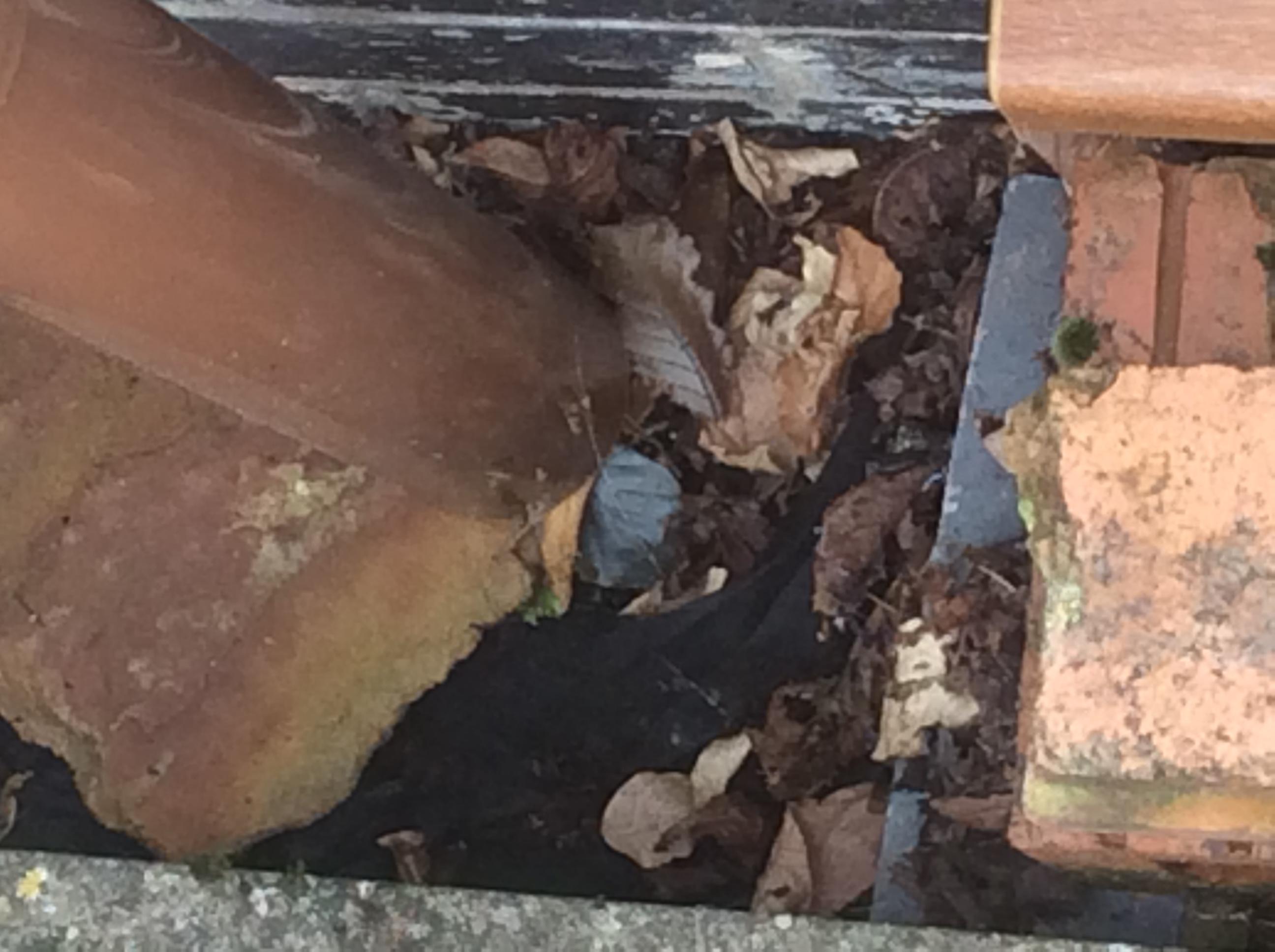

I have hedgehogs everywhere, from perhaps 2-3 years ago, and huge overhanging trees - though now fewer.
Hedgehogs are great in maintaining a flow even under a pile of leaves, but some leaf matter will still get through. This year is the first time I have blockages inside drainpipes, which is why I am trying to fix it permanently.
