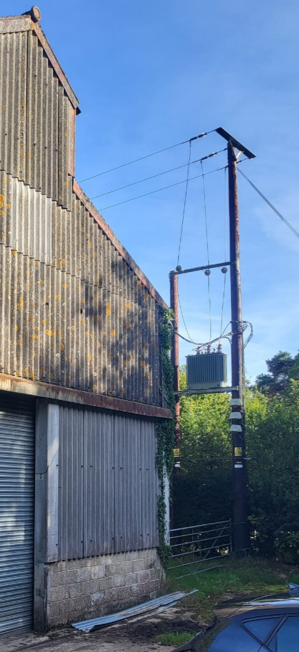

Darcy Holding Posted March 21 Share Posted March 21 Good morning all, Appreciate this an old thread/post. I have recently completed a sale on a barn with planning to turn into a house. Due to start work in April.......until UKPN stepped in. There is a high voltage cable and transformer near the barn as shown in the picture. There is a wayleave which is due to be completed/signed in the near future but this states that it could take up to 18 months to move the high voltage lines (11kv) to a new location. With the nature of the build I can't afford to potentially wait around for 18 months as I need to start work asap. UKPN have suggested that the cables are to high voltage to shroud, but are apparently 'searching' for alternatives to protect the cables to allow work to commence. Questions for anyone that can help: Has anyone ever come across this, if so did you have any genius solutions? Are 11kv lines to dangerous to shroud or is it just UKPN being difficult? Is it illegal to take a chance and work with scaffold or a MEWP down that elevation of the building? Is there any laws around this? Hope someone could help as this project has hit a dead end and starting to take a toll monetary wise. Many thanks Link to comment Share on other sites More sharing options...
joe90 Posted March 21 Share Posted March 21 I did find this on the internet…. Overhead line shrouding manufactured from yellow U.V. resistant material to EA43-103 standard and suitable for up to 1000 volts protection. Link to comment Share on other sites More sharing options...
markc Posted March 21 Share Posted March 21 LV cables are often shrouded but at 11kv, plus the transformer etc. shrouding is not practical (if it was further away you could erect a crash fence but again not possible in this case). It comes down to - how will you protect your employees and how will you protect the pole, cables, transformer etc. Link to comment Share on other sites More sharing options...
saveasteading Posted March 21 Share Posted March 21 (edited) 28 minutes ago, Darcy Holding said: scaffold or a MEWP down that elevation of the building? Electricity jumps a long way. How far away is it? Had to use fibreglass ladders on one project. Had interesting occurrences involving cranes a couple of times. I'm sure the rules will be very clear. But there is usually a solution, albeit slower or more expensive. Does the barn include steel? Are you reusing the structure? Edited March 21 by saveasteading Link to comment Share on other sites More sharing options...
ProDave Posted March 21 Share Posted March 21 When I was doing our build I looked into the law on this as there are 11KV overhead lines across the road from us. You will often find a statement "no building within 10 metres of overhead power lines" When I looked into it, it turns out the 10 metres is the point where you need to start taking notice, serious notice of the lines and the actual restrictions only start at 6 metres from the lines. We also had more than one delivery refused to use a HIAB as they deemed it too close to the lines, others just took more care knowing they would be slewing away from the lines. Nobody is going to install insulation on a live 11KV line (like they to on a live 240V line) so even if some insulation was available it would be a shutdown of that section of line Link to comment Share on other sites More sharing options...
saveasteading Posted March 21 Share Posted March 21 https://www.hse.gov.uk/pubns/gs6.htm 1 Link to comment Share on other sites More sharing options...
saveasteading Posted March 21 Share Posted March 21 From memory....there is a distance at which there can be an airborne spark, depending on voltage. Find that and draw a vertical line for no-go. on site erect a marker tape there. Inside that, nothing must be able to fall towards the power. Mewps must be very stable. Scaffold must be tied to the structure. Lifting zones must be worked out. Safe handling of metal parts must be studied and controlled. Your contractors will need supervision. I'd get them to write their own risk assesments. Right now get reading. 1 Link to comment Share on other sites More sharing options...
Alan Ambrose Posted March 21 Share Posted March 21 >>> There is a wayleave which is due to be completed/signed in the near future but this states that it could take up to 18 months to move the high voltage lines (11kv) to a new location. Well you don't have to sign the wayleave unless you're very happy with it. I'm curious how UKPN 'stepped in' - did you not initiate the contact? The DNOs often play the 'will take a lot of time unless you want to pay for it' game. I suggest a call or two to their wayleaves department and you should be able to (a) initiate the removal (that might take forever, but it puts them on notice, and fires the starting gun) and (b) see if you can negotiate something that suits you better. They are experienced at this game though, so you might want to 'prepare the ground' carefully and maybe consult a lawyer experienced in wayleaves and figure out how much it's worth to you. Have you completed the sale already, as this should have been flagged by your lawyer a clear risk going in? Link to comment Share on other sites More sharing options...
