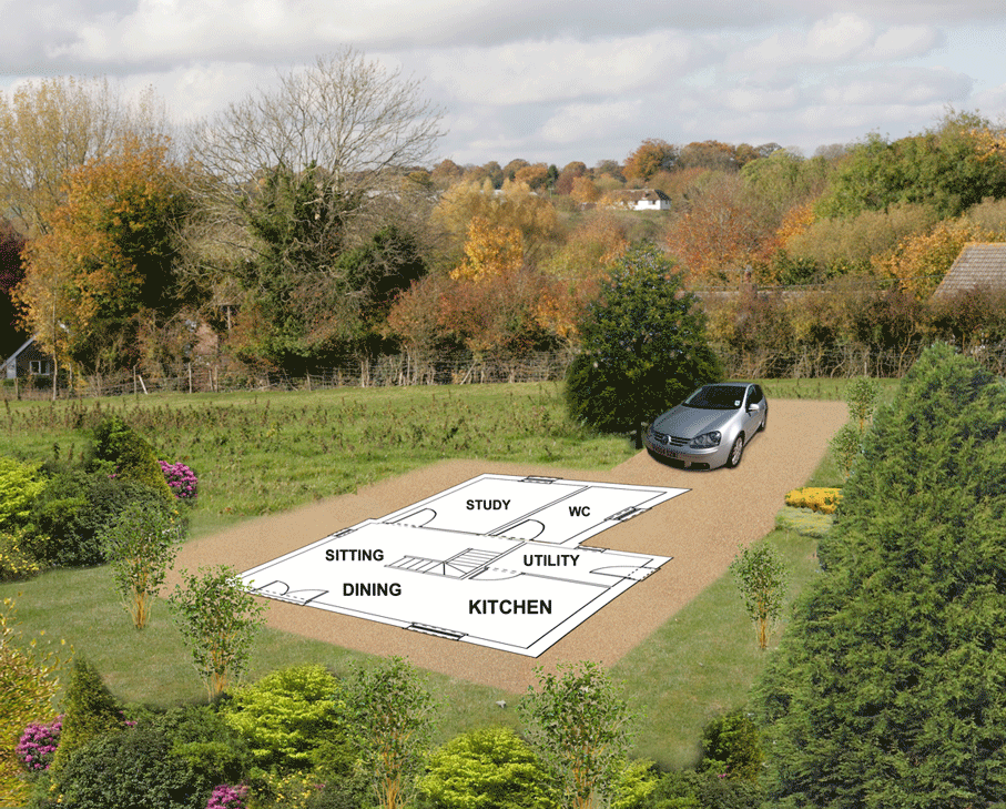

Adrian Walker Posted August 7, 2019 Posted August 7, 2019 I have been asked if my Eco designed passive house could be converted into 4 self contained Minimalist Apartments. I'm happy to share my thoughts and designs with you all in exchange for comments and ideas. 2

Redoctober Posted August 7, 2019 Posted August 7, 2019 (edited) No idea as to the question but loving the graphic - great bit of software. Not seen that before. ?? Edited August 7, 2019 by Redoctober typo
Moonshine Posted August 7, 2019 Posted August 7, 2019 (edited) Party walls and floors thickness - these will have to be considered / beefed up to meet the minimum requirements of Approved Document E for airborne and impact (floors) isolation. Also factor in that come near completion you will likely have to have sound tests done, unless you go down a Robust Detail route. Edited August 7, 2019 by Moonshine
Adrian Walker Posted August 7, 2019 Author Posted August 7, 2019 1 minute ago, Redoctober said: No idea as to the question but loving the graphic - great bit of software. Not seen that before. ?? It's just an animated gif - put the image on a separate lay in photoshop and bingo
Moonshine Posted August 7, 2019 Posted August 7, 2019 8 minutes ago, the_r_sole said: when you say "minimalist" do you just mean tiny? What area is your floorplate? Round this way, minimum GIA's for 1 bed 2 person flats are about 50m2. unless that house has a GIA of ~200m2, which it doesn't look like it has, four flats as you indicate, would be a squash.

Adrian Walker Posted August 7, 2019 Author Posted August 7, 2019 9 hours ago, the_r_sole said: when you say "minimalist" do you just mean tiny? What area is your floorplate? Yes, small or tiny ~ 40sqm for each apartment
Adrian Walker Posted August 7, 2019 Author Posted August 7, 2019 8 hours ago, Moonshine said: Round this way, minimum GIA's for 1 bed 2 person flats are about 50m2. unless that house has a GIA of ~200m2, which it doesn't look like it has, four flats as you indicate, would be a squash. 40sqm is more than enough for a minimalist apartment

Ferdinand Posted August 8, 2019 Posted August 8, 2019 (edited) I think we need more info here as to the proposal. eg are these self-contained flats or bedsits? Main homes or pied-a-terres? One beds or studios? Owned or rented? Do you plan to meet national space standards? https://www.designingbuildings.co.uk/wiki/Technical_housing_standards_-_nationally_described_space_standard F Edited August 8, 2019 by Ferdinand
Adrian Walker Posted August 8, 2019 Author Posted August 8, 2019 16 hours ago, Moonshine said: Party walls and floors thickness - these will have to be considered / beefed up to meet the minimum requirements of Approved Document E for airborne and impact (floors) isolation. Also factor in that come near completion you will likely have to have sound tests done, unless you go down a Robust Detail route. Yes, Party walls and floors thickness will need to be considerable beefed up
