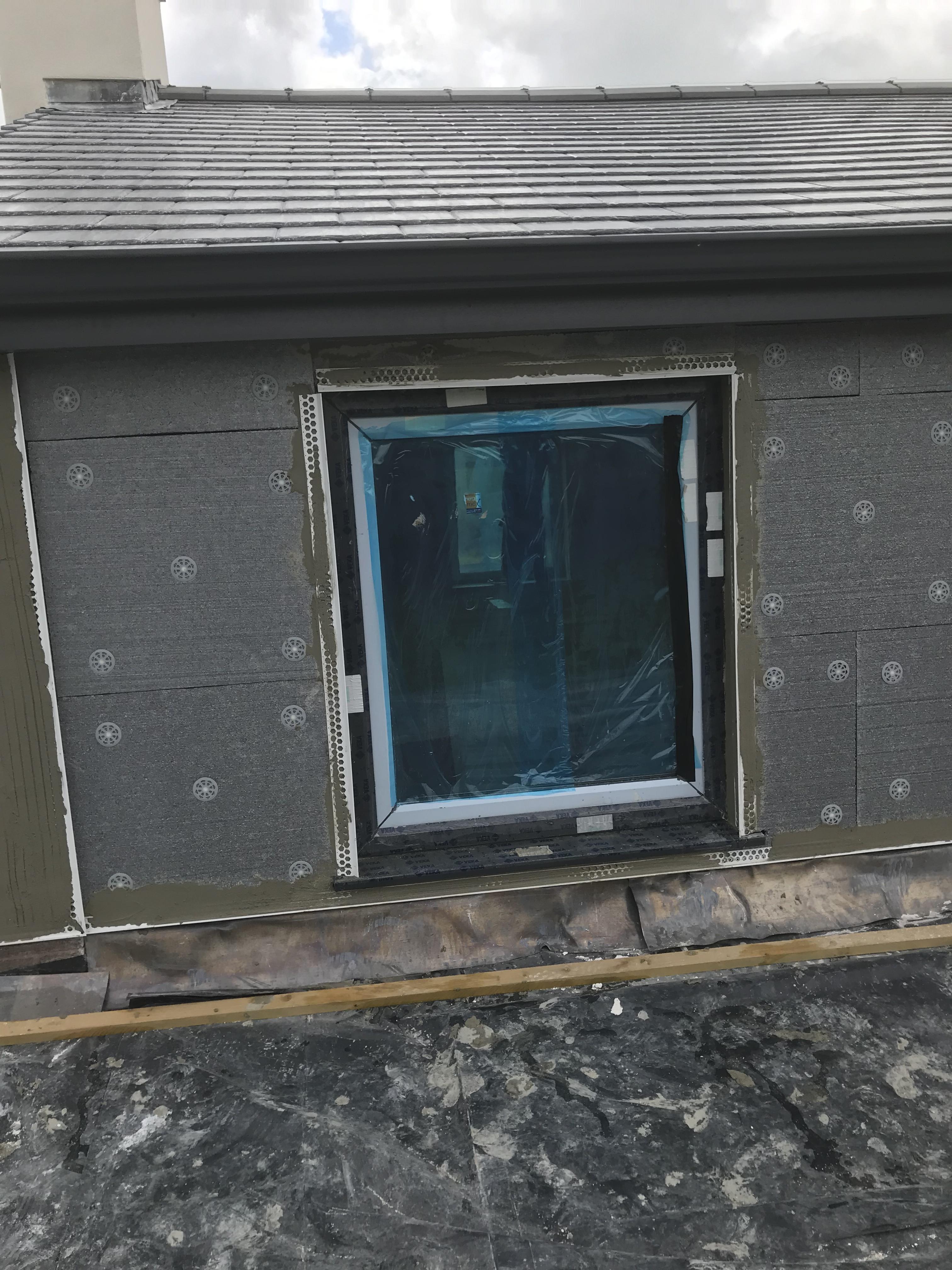

nod Posted August 7, 2019 Posted August 7, 2019 32 minutes ago, jack said: You're right to be concerned, and I'm surprised anyone is suggesting rendering directly onto an outer layer of OSB. First, OSB isn't ideal as an outer cladding. You want to have a think about vapour openness from interior to exterior. For example, we have a twin stud construction, which (from inside to out) is airtightness membrane > OSB > warmcell-filled twin stud > panelvent (I think that's the brand - vapour permeable board, in any event) > breather membrane > vertical battens > cement board > brick slips. You definitely don't want to be rendering directly onto whatever is used to close the twin stud wall. It needs a ventilated cavity. I agree with the above I wouldn’t render directly onto any timber surface Even with a mesh A vapour barrier with batons on top then a cement board is normal Or insulation Like this one I’m trying to do this morning If it ever stops raining in sunny Garstang 1
