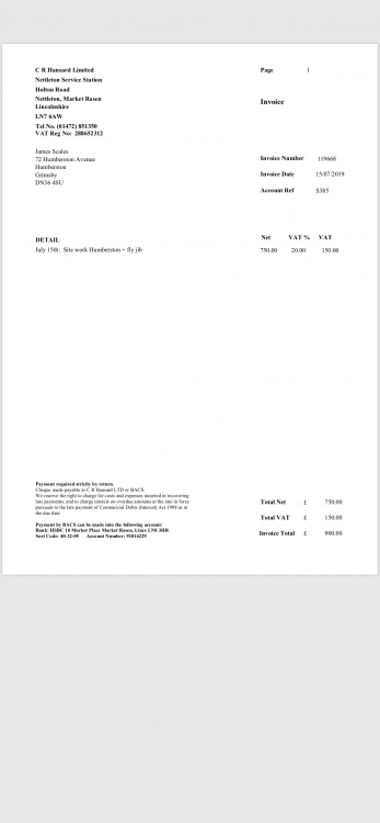

James94 Posted August 2, 2019 Posted August 2, 2019 Hi all, just a quick one - we recently had a local haulage company supply a HIAB and operator for a day to lift our roof trusses should I be paying VAT? Take a look at the invoice I have received and let me know what you think, they are insisting I can claim it back at a later date, I’m not so sure. Thanks James
ProDave Posted August 2, 2019 Posted August 2, 2019 I would say no. You were paying them labour for work on a new build. You cannot claim that back. Send them a cheque for the net amount with a covering letter explaining that it is work on a new build house and so they should have zero rated it. By sending the net payment they can't accuse you of withholding payment.
newhome Posted August 2, 2019 Posted August 2, 2019 22 hours ago, James94 said: Hi all, just a quick one - we recently had a local haulage company supply a HIAB and operator for a day to lift our roof trusses should I be paying VAT? If hired with an operator the job should be zero rated. This is shown in VAT Notice 708: Quote 3.4.2 Goods on hire Goods hired on their own are always standard-rated. Examples include the hire of: plant and machinery (although plant hired with an operator can be zero-rated where all the conditions in sub-paragraph 3.1.2 are met) VAT Notice 708 This is also made clear in HMRC's internal manual: HMRC Internal Manual It must be zero rated at source as there is no way of you claiming it back afterwards. The VAT reclaim scheme is for materials only. You will need to tell them to refer to VAT Notice 708 and zero rate the invoice.

James94 Posted August 2, 2019 Author Posted August 2, 2019 Thanks for your advice, I have sent off a covering letter along with the cheque. Now I’ll wait for a response.
Rob99 Posted August 2, 2019 Posted August 2, 2019 I'd expect the hire company to be sensible and just re-issue you with a zero rated invoice. After all, if he charges and collects the VAT from you he has to pay it over to HMRC anyway.
Thedreamer Posted August 2, 2019 Posted August 2, 2019 45 minutes ago, Rob99 said: I'd expect the hire company to be sensible and just re-issue you with a zero rated invoice. After all, if he charges and collects the VAT from you he has to pay it over to HMRC anyway. That's 100% correct. But often some contractors have the 'mentality' like they are running the risk of zero rating as they wouldn't want to be told later during an inspection that they should have charged VAT, which obviously wouldn't be the case in this circumstance.
Temp Posted August 3, 2019 Posted August 3, 2019 In some situations VAT 708 requires the purchaser to provide a "certificate" to the person or company making the supply. I dont think self builders are ever required to do so but it might help convince the supplier if you issue one anyway. The certificate is basically just a letter stating the work was done on a new dwelling and providing details of the project including your planning reference number. Think there is a template in Vat 708 and didn't someone post their version on this forum some time ago?
