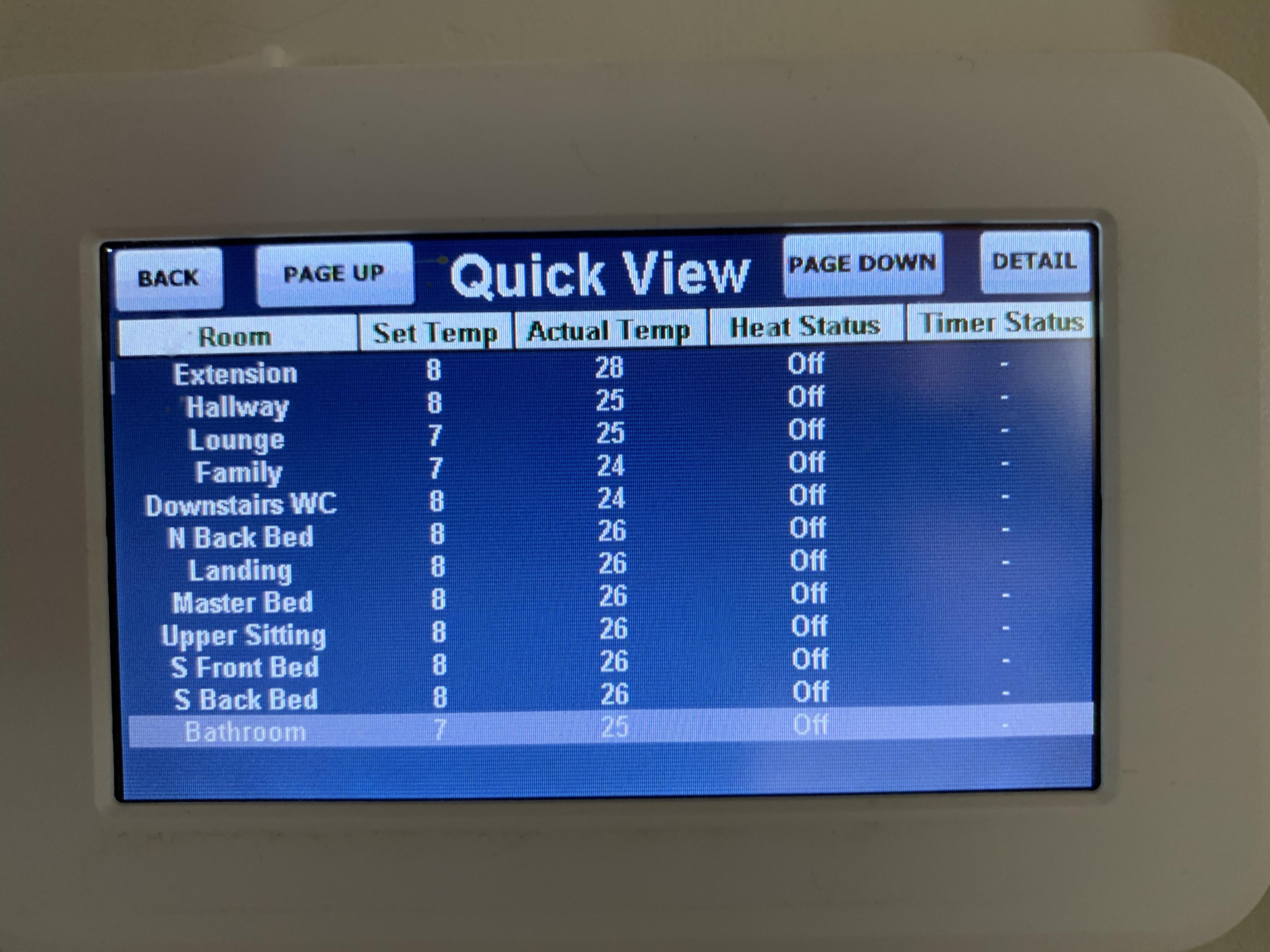

My family seem to be averse to opening windows no matter how hot gets.
I just checked Heatmiser and see a temp of 29 degrees in one south facing room.
But it is a mere 25C in Edinburgh at the moment, versus 38C down south.

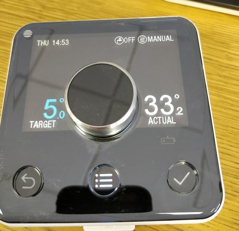

11 minutes ago, AdamSee said:
Behold!!!! My office temperature.
At this moment in time im pretty sure that if i peed myself it was actually be cooler.......but equally as damp.
33.2 will be hard to beat even if @JSHarris switched on his heating it is hotter than his flow temperature.
