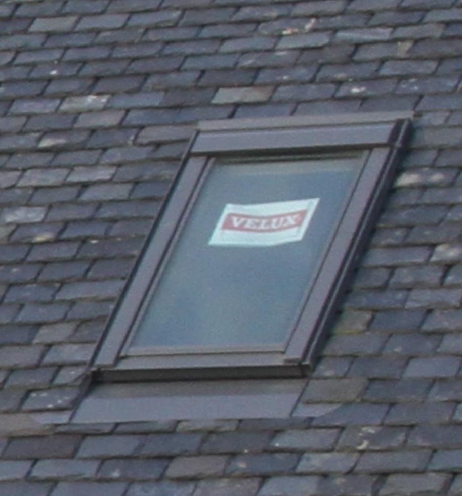

Repsac Posted July 24, 2019 Share Posted July 24, 2019 Hello all,I am looking for an opinion on a job that was performed by a loft conversion company and the way how they put the roof slates back together around the new velux windows. There are gaps I see between the slates and it does not look pretty as they are not organised nicely as the original ones before the velux installation.I have attached 7 pictures, picture 2,3 and 4 are the most ugly and these are from the front of the property, so any potential future buyer of our house may raise few eye-browses and questions like: "what's wrong with the roof ?"Just wanted your opinion on this overall roof job... ? Do you think I am eligible to having this repaired to its nicely done ? Is it possible with the type of roof and type of roof tiles/slates an type of window to have this done perfectly ? Is there any risk from what you can see of water coming in if this is left as is ?Regards,Repsac Link to comment Share on other sites More sharing options...
nod Posted July 24, 2019 Share Posted July 24, 2019 Very poor They won’t last a winter The Velux flashing can cause the slates sit at a slight angle But you can usually get round this by sorting through the new slates for ones that sit nice It looks like little care has been taken The gutters around the velux should be even and clear I would be concerned about how much care they have taken fitting the flashings if they are going to leave the slates looking so messy You need to get them back and see what they have to say Link to comment Share on other sites More sharing options...

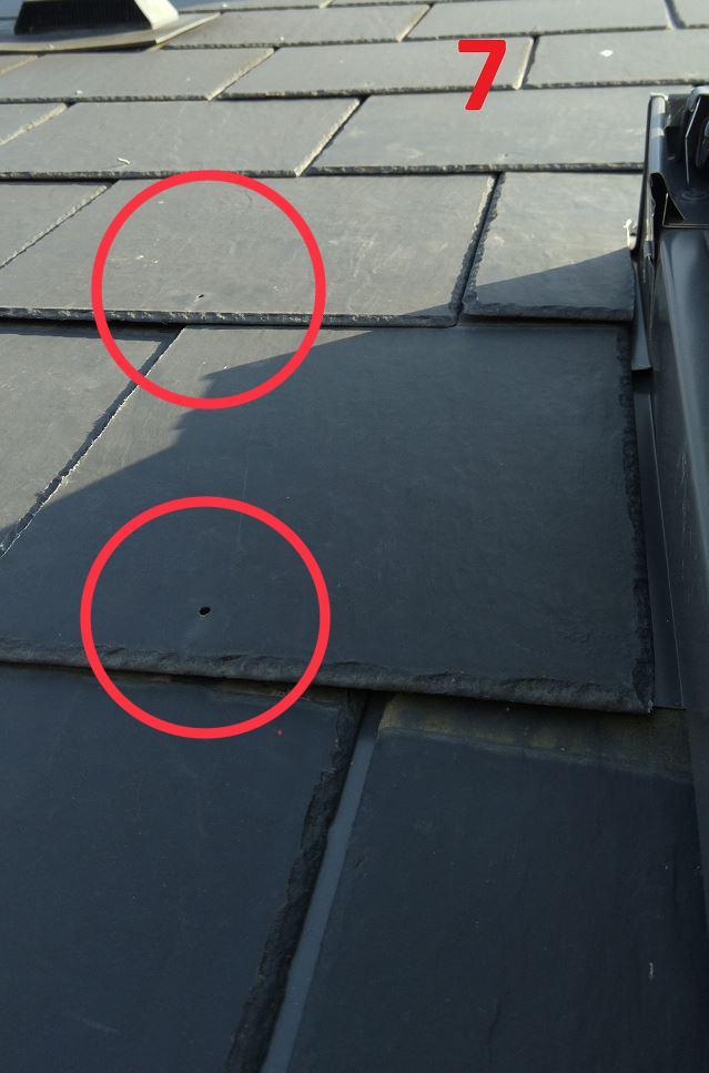

PeterW Posted July 24, 2019 Share Posted July 24, 2019 How have they refitted the slates as these two are upside down ....! Look at the nail holes in the circled slates. Link to comment Share on other sites More sharing options...
Repsac Posted July 24, 2019 Author Share Posted July 24, 2019 Thanks guys, it's not good new as i expected. What about pictures 5 and 6, these are from the other side where there is scaffolding, and it look tiny bit better then the other side. Do you think there is a risk of water coming in if left untreated ? Link to comment Share on other sites More sharing options...
Declan52 Posted July 24, 2019 Share Posted July 24, 2019 I think they have put the brackets in the wrong position for slates. If you put the brackets on the correct position the window is recessed low enough so the tiles don't kick. If you put the brackets at the other fixing points then the window sits higher for normal tiles. Watch these installation videos and see the difference. https://www.velux.co.uk/professional/tools/installer/installation-videos The good thing is if you take the sash out it can all be redone from the inside of the house so they don't need on to the roof again. Link to comment Share on other sites More sharing options...

Repsac Posted July 24, 2019 Author Share Posted July 24, 2019 Hi PeterW, I honestly don't know what sarking board or battens is, sorry I work with computers I tried googling it but to no avail. Declan52, thanks for the videos, I see what you mean... I did highlight the issue it to the workers, they said it's still work in progress and they are waiting for some clips and stuff and that it will all be nice and flat in the end, which I am not convinced at all.... ?? Link to comment Share on other sites More sharing options...
Declan52 Posted July 24, 2019 Share Posted July 24, 2019 There is no clips in the world that will level them tiles out. Link to comment Share on other sites More sharing options...
scottishjohn Posted July 24, 2019 Share Posted July 24, 2019 my guess looking how much the frame of velux is showing there are no batons --just tiles nailed to sarking If it had been on cross batons then you would fit velux first,then batons round it and you would have a perfect finish Link to comment Share on other sites More sharing options...
Mr Punter Posted July 24, 2019 Share Posted July 24, 2019 They need to strip the slates and soakers around the roof windows and re-lay them properly. Link to comment Share on other sites More sharing options...

bassanclan Posted July 24, 2019 Share Posted July 24, 2019 Another cause of the problem might be that they have used the wrong flashing - not a flashing designed for slates Link to comment Share on other sites More sharing options...
joe90 Posted July 24, 2019 Share Posted July 24, 2019 4 hours ago, Declan52 said: I think they have put the brackets in the wrong position for slates. I agree with @Declan52 about brackets in wrong position, velux too high in roof, kicking slates up. Link to comment Share on other sites More sharing options...
Mr Punter Posted July 25, 2019 Share Posted July 25, 2019 21 hours ago, joe90 said: I agree with @Declan52 about brackets in wrong position, velux too high in roof, kicking slates up. But down the sides they just have soakers that between the slates so even if the window is set a bit high they should still work without kicking them up. Link to comment Share on other sites More sharing options...
joe90 Posted July 25, 2019 Share Posted July 25, 2019 43 minutes ago, Mr Punter said: But down the sides they just have soakers that between the slates so even if the window is set a bit high they should still work without kicking them up. With dead flat slates even the thickness of slate soakers will kick them out of line a bit. But I still recon the velux is too high in the roof. Link to comment Share on other sites More sharing options...

ADLIan Posted July 25, 2019 Share Posted July 25, 2019 On 24/07/2019 at 16:19, PeterW said: How have they refitted the slates as these two are upside down ....! Look at the nail holes in the circled slates. Slates are not upside down those holes are for the copper rivets that secure the bottom edge of the slate. Poor roofer if he does not know how to fit these especially in cut slates such as around skylight, probably at the verges too. All needs redoing otherwise roof will last no time at all. Link to comment Share on other sites More sharing options...
PeterW Posted July 25, 2019 Share Posted July 25, 2019 I don’t think they are rivet holes as they look like repro slates. Think they have been removed and damage and turned upside down. Link to comment Share on other sites More sharing options...
Triassic Posted July 25, 2019 Share Posted July 25, 2019 I think the slates are the correct way up, If you zoom in you can see the rivets further up the roof. i agree, it’s all down to the position of the flashings, causing the slates to kick. Link to comment Share on other sites More sharing options...
Triassic Posted July 25, 2019 Share Posted July 25, 2019 (edited) To check you have the correct flashings you should be looking for a red symbol on the box. The Velux frame fixing brackets must the be fixed to the bottom for the red flashing kit. https://velcdn.azureedge.net/~/media/marketing/uk/brochures/installer_handbook.pdf Edited July 25, 2019 by Triassic Link to comment Share on other sites More sharing options...
ADLIan Posted July 25, 2019 Share Posted July 25, 2019 Look at the close up shots of other slates. Slates are normally nailed twice towards the edge not once at the very top edge and man made slates normally riveted too. Looks like rivets may be missing in general roof area too as the slates are too far apart to secure the rivet. Link to comment Share on other sites More sharing options...
