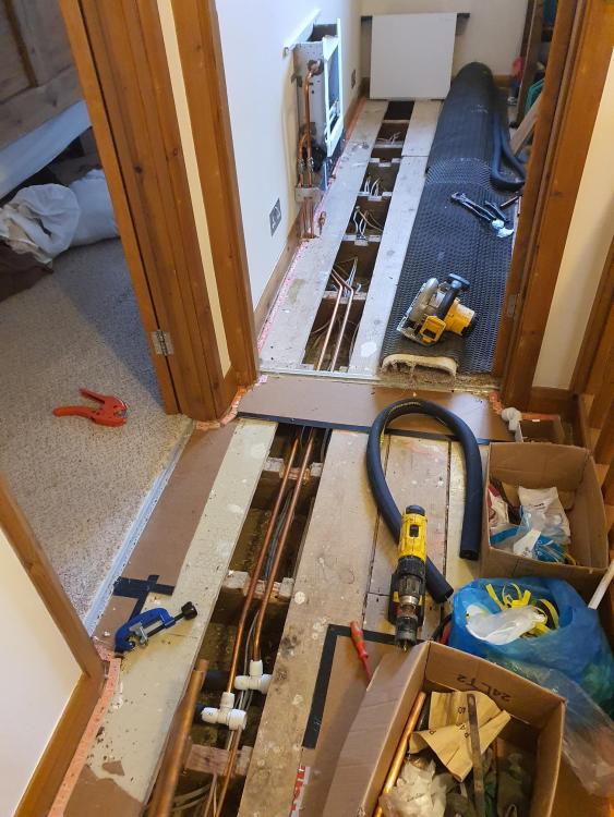

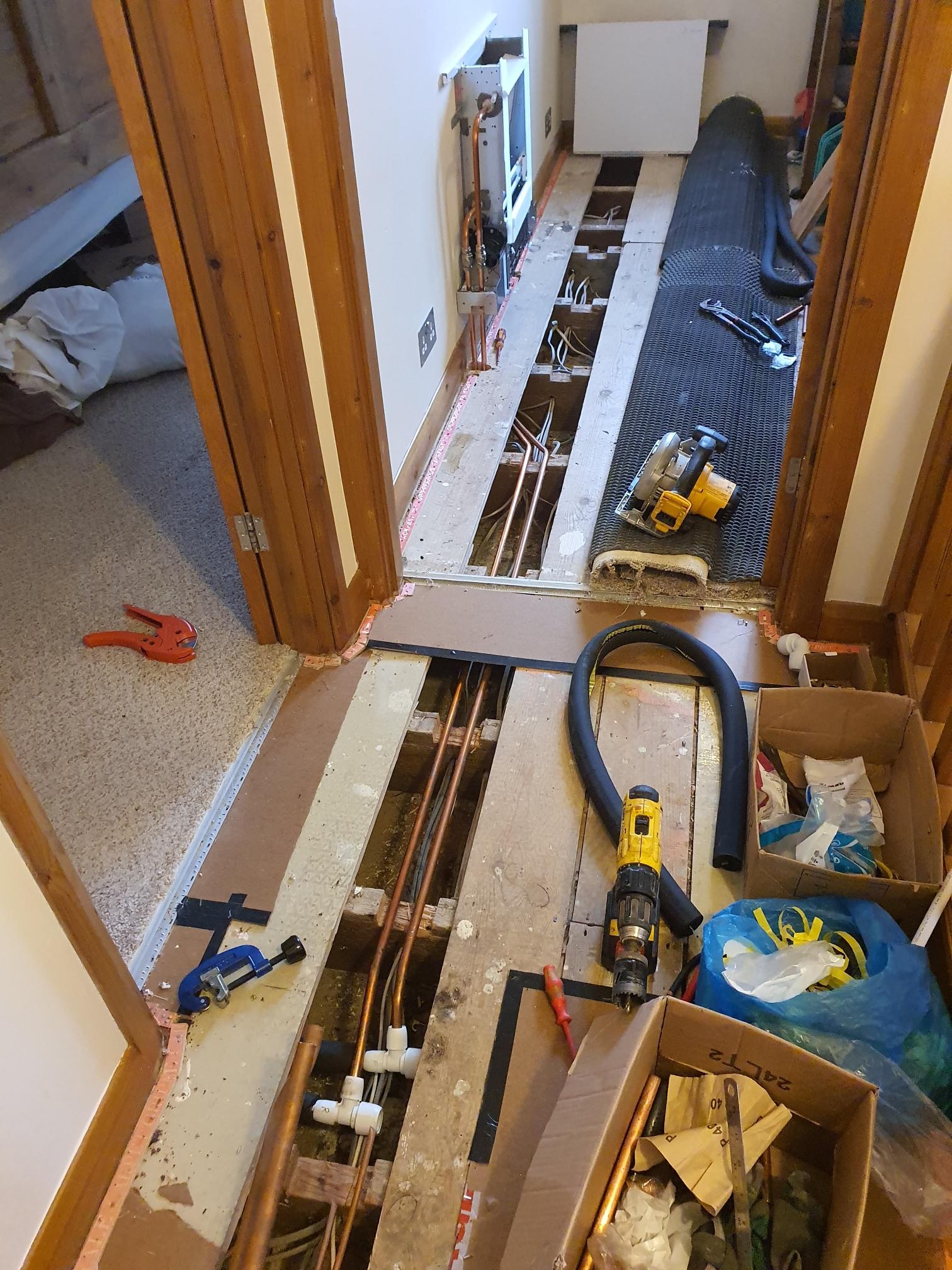

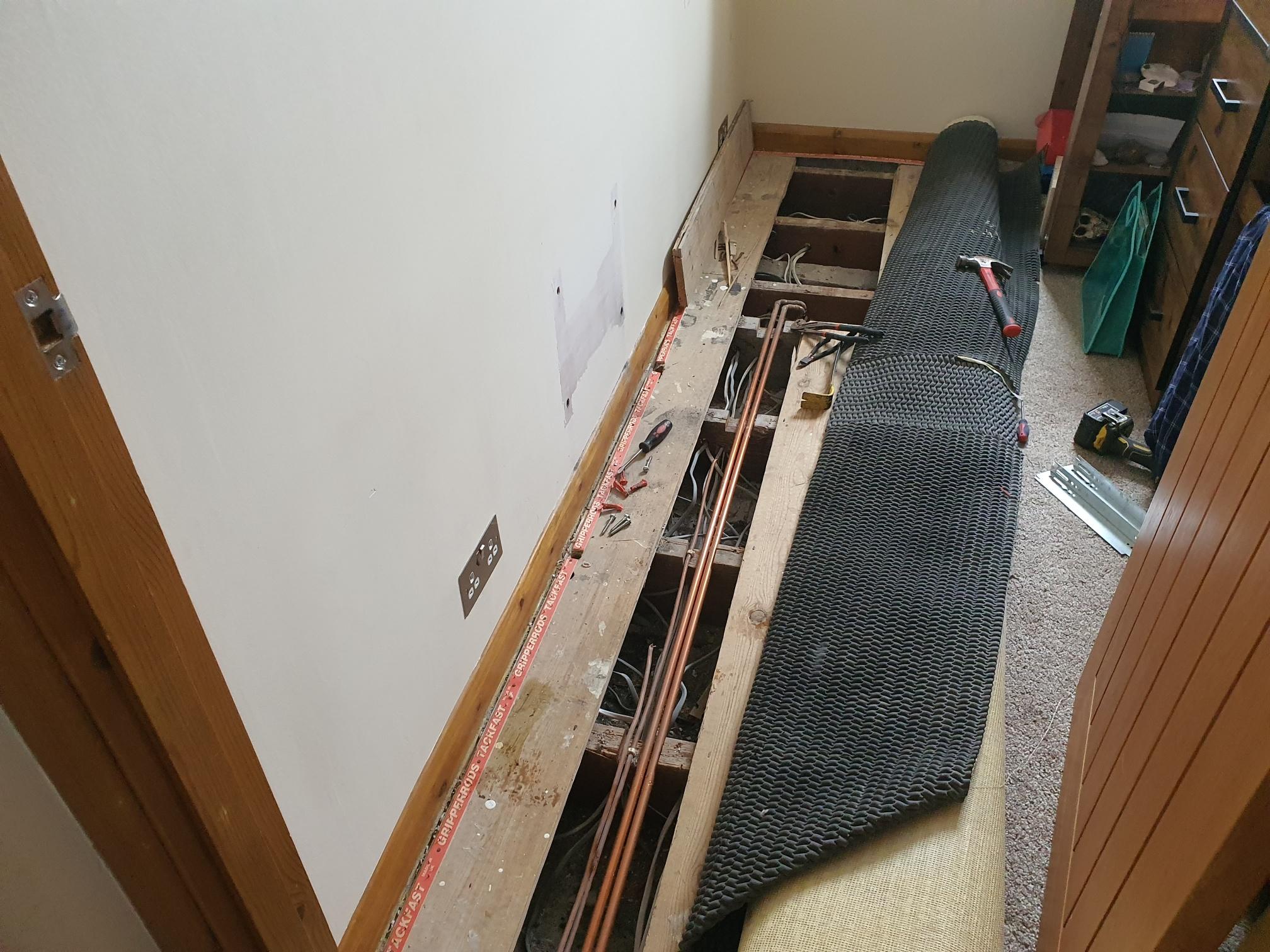

eniacs Posted April 19, 2023 Share Posted April 19, 2023 Repiping and radiator install. Insulating every bit of exposed pipe is actually quite a faff. This is one radiator (well FCU). Each has to be done, all new piping, all new insulation and a power connection too. 3 Link to comment Share on other sites More sharing options...

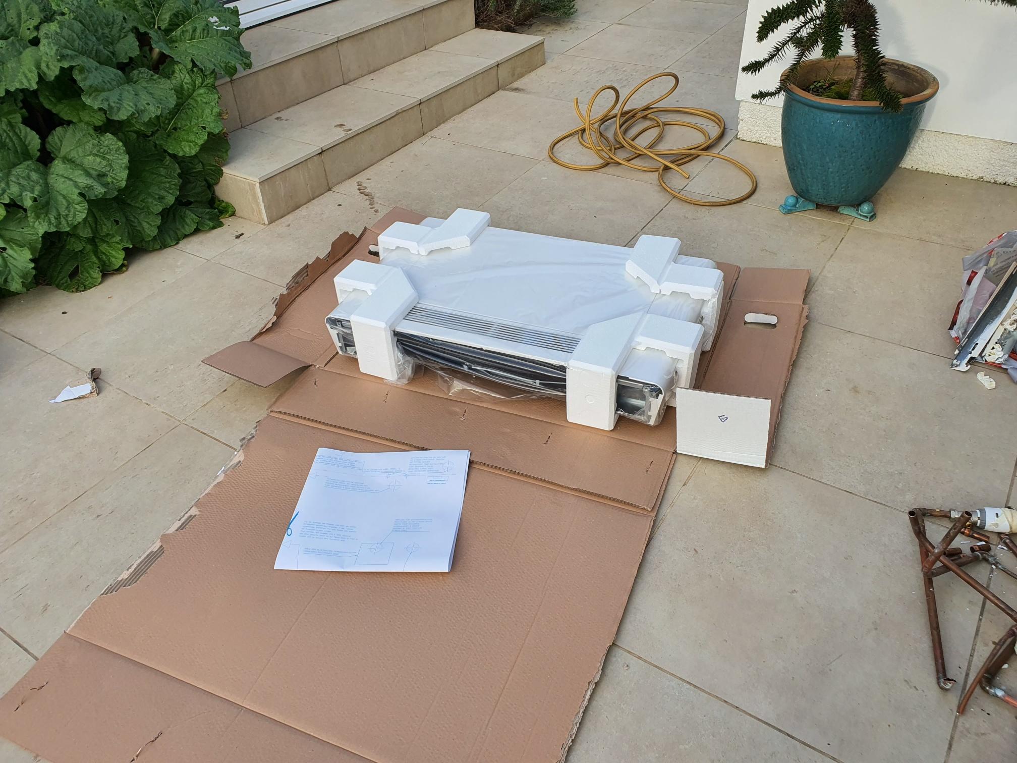

eniacs Posted April 20, 2023 Share Posted April 20, 2023 Joe, these are italian, Innova brand. I got them shipped from italy, they were a good price in italy, (around 450euro each including the controller) however once they got here i paid around £650 each. I was charged 2 x VAT sadly, a victim of Brexit. I also looked at the ivector's, they look good. Daikin do Innova stuff in the UK, no idea on pricing though. Would be worth finding out, i doubt they have to pay 2x VAT to get them in the country so could be good value. Link to comment Share on other sites More sharing options...

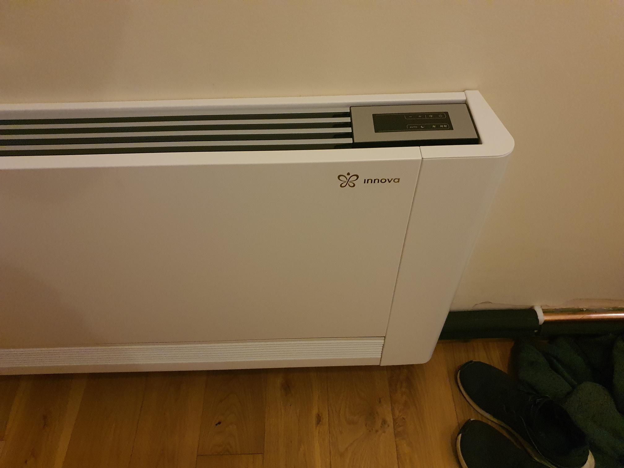

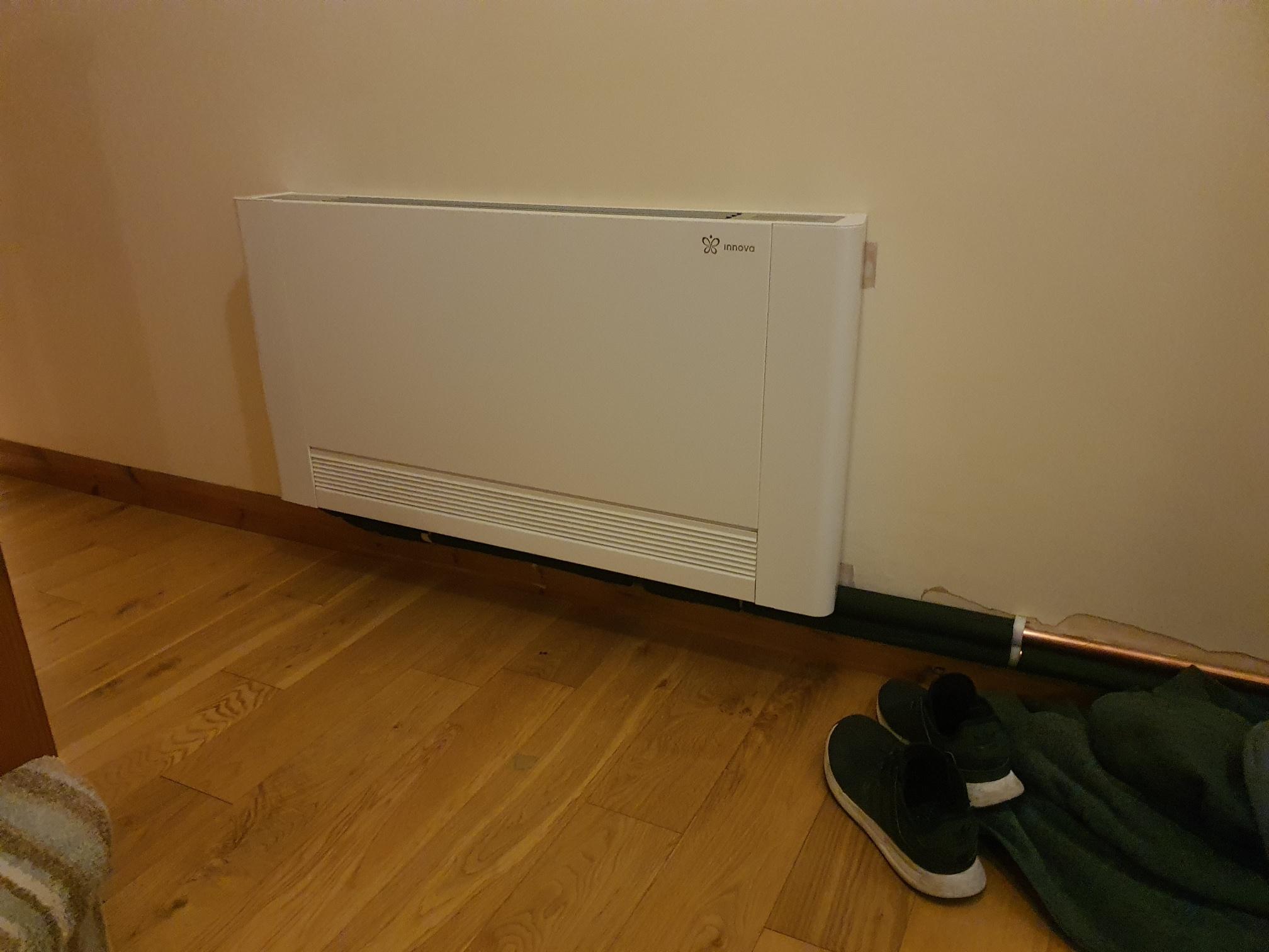

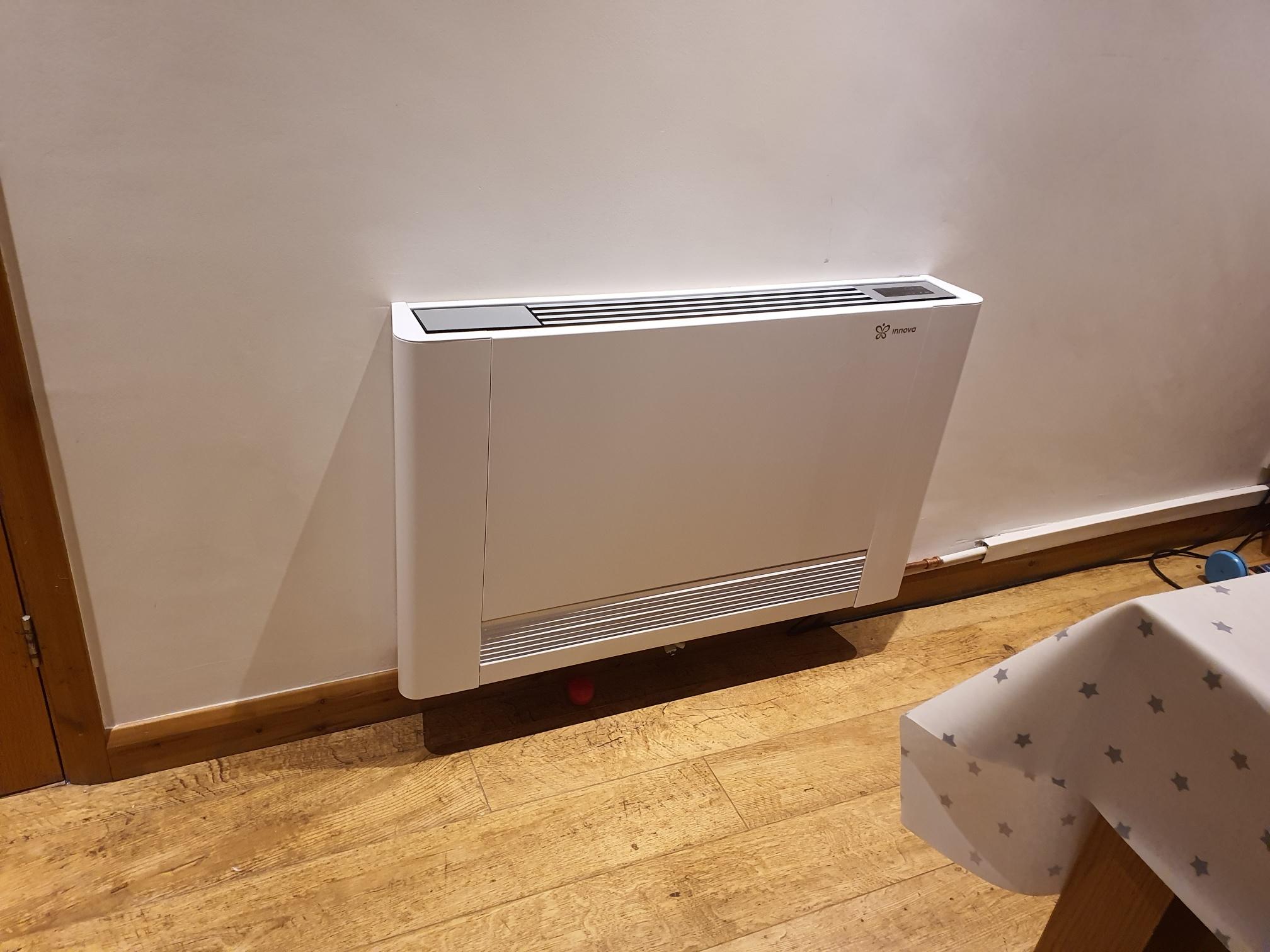

ReedRichards Posted April 21, 2023 Share Posted April 21, 2023 I would love to see a picture of the finished FCU. As a work-in-progress it looks quite ugly but I'm hoping it will look nice when finished. Link to comment Share on other sites More sharing options...

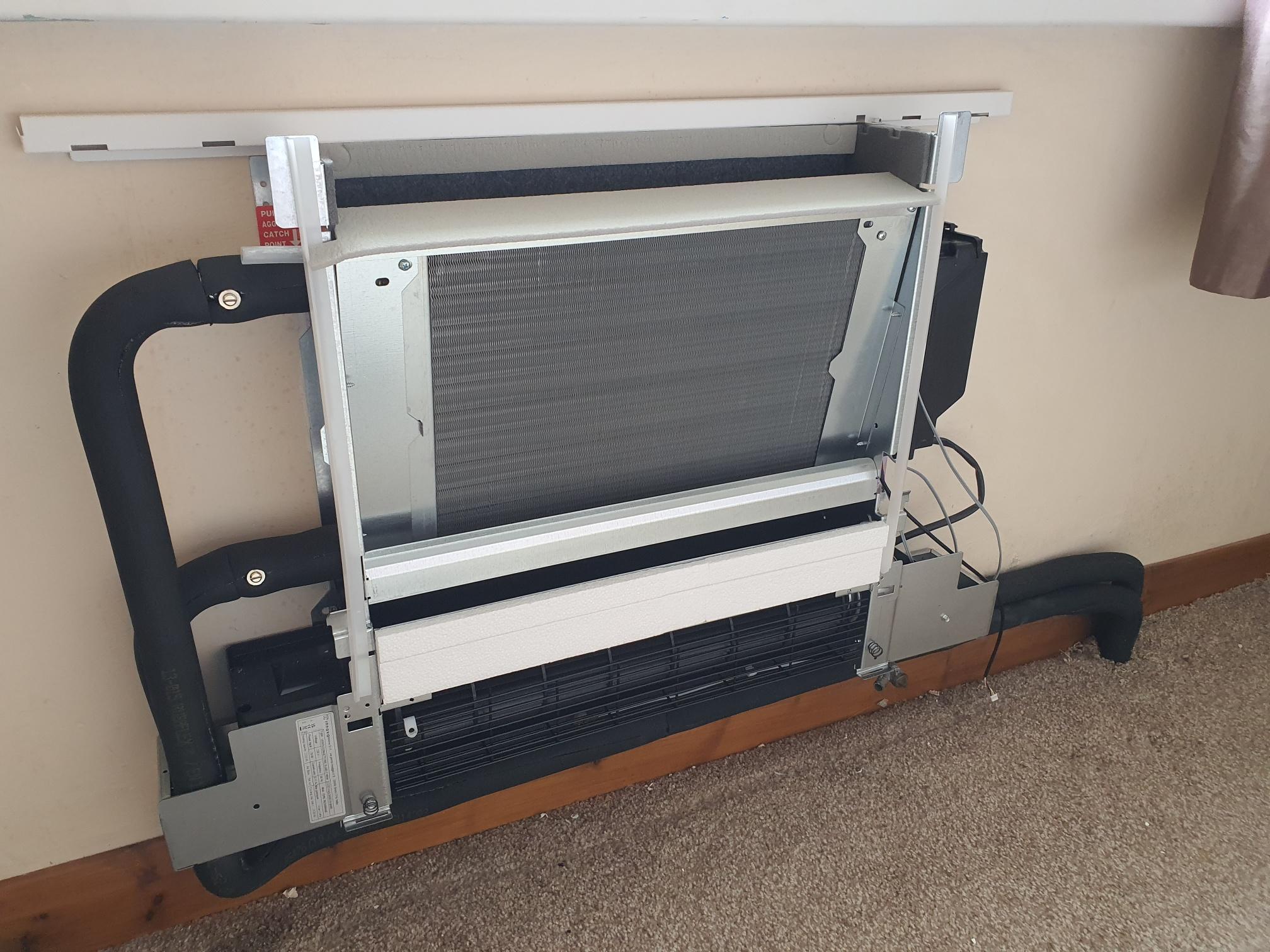

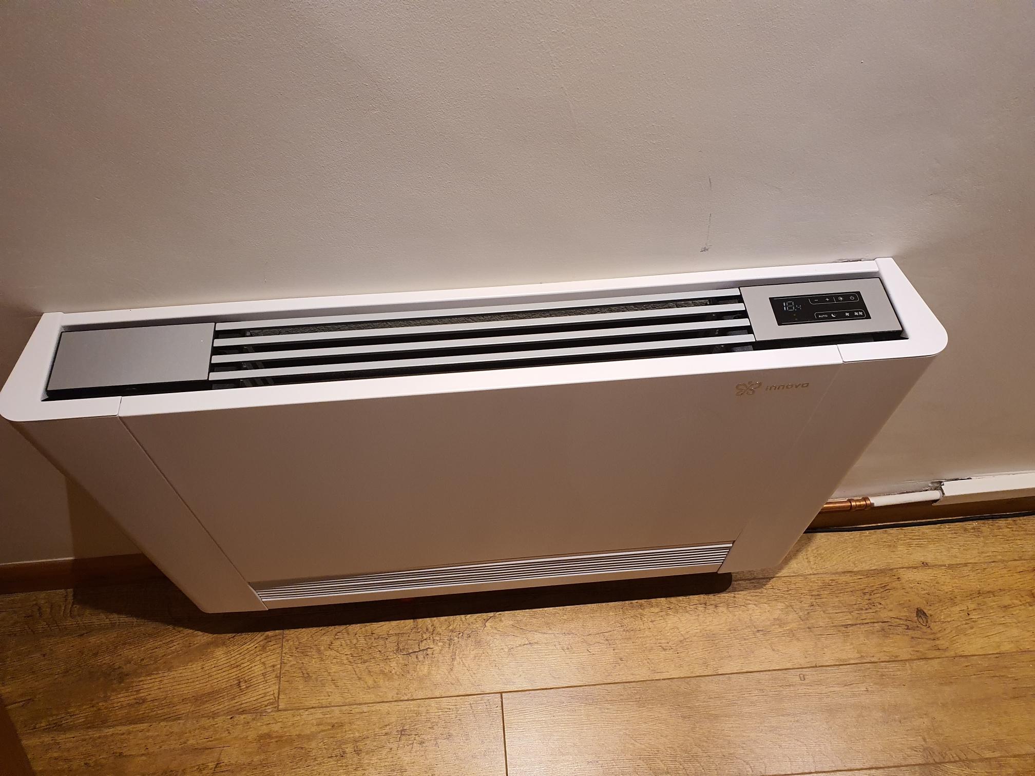

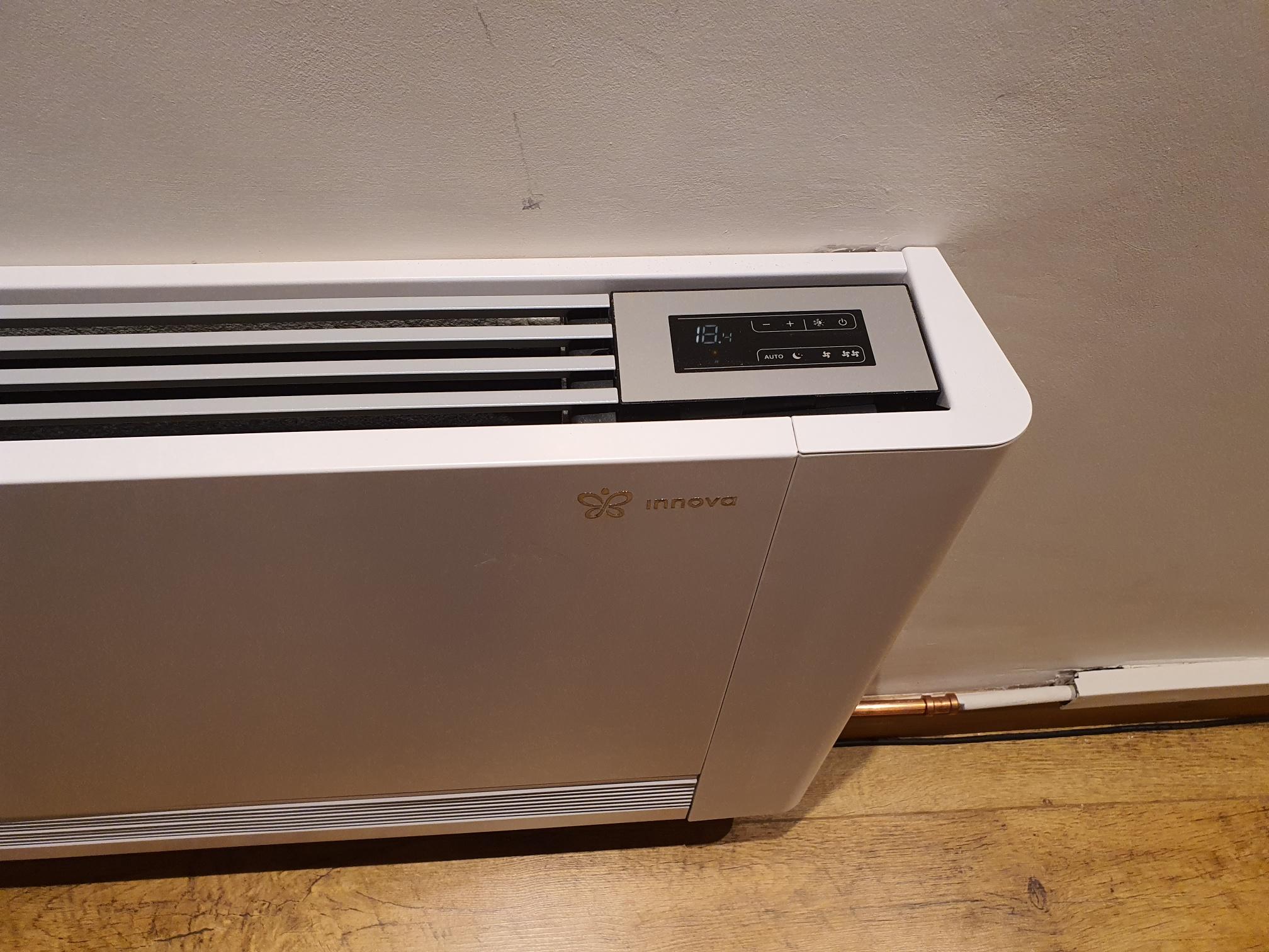

eniacs Posted April 24, 2023 Share Posted April 24, 2023 See attached, apologies I've literally snapped a few photos late in the evening when i had 5 mins spare. Some damage still on walls and piping not 100%, but getting there. Still got a small run to this rad left and the main 28mm run out to the heat pump and the UVC to buy and put in place (have a plumber friend who will actually connect this for UVC rules). All piping is lagged, its taken so much time to do and been very fiddly, still i dont think it is 100%. In the first photo you can see a bare pipe next to an insulated run of piping, my youngest (18 months old) walked in proudly showing us the insulation he had managed to tear off. Once completed the idea is to run the HP in cooling mode through the summer and heating of course in winter, so lagging was one of the most important issues here. Link to comment Share on other sites More sharing options...
NSS Posted April 24, 2023 Share Posted April 24, 2023 26 minutes ago, eniacs said: See attached, apologies I've literally snapped a few photos late in the evening when i had 5 mins spare. Some damage still on walls and piping not 100%, but getting there. Still got a small run to this rad left and the main 28mm run out to the heat pump and the UVC to buy and put in place (have a plumber friend who will actually connect this for UVC rules). All piping is lagged, its taken so much time to do and been very fiddly, still i dont think it is 100%. In the first photo you can see a bare pipe next to an insulated run of piping, my youngest (18 months old) walked in proudly showing us the insulation he had managed to tear off. Once completed the idea is to run the HP in cooling mode through the summer and heating of course in winter, so lagging was one of the most important issues here. Apart from the display/control panel markings, these look to be identical to the Panasonic Air rad we installed six years ago. If so, I'll be interested to hear how they work for you as ours is fine in cooling mode but practically useless in heat mode as the ashp water temperature almost never reaches the delta at which the valve opens to allow water to circulate through it. Link to comment Share on other sites More sharing options...
eniacs Posted April 25, 2023 Share Posted April 25, 2023 That sounds right, both Panasonic and Daikin rebrand these units from Innova to sell in the UK. I didn't go for the valve option so I hope that isnt a problem! Spec sheet shows them switching on the fan at a flow temp of 35deg. I was hoping to play with running a flow temp of 35 to 45 deg and see what works for the house, i dont think i'll be devastated if they only work at 45deg though. How do you deal with condensation in cooling mode? I've looked at condensate pumps and drilling external drains etc but havent done anything yet. Link to comment Share on other sites More sharing options...
NSS Posted April 25, 2023 Share Posted April 25, 2023 34 minutes ago, eniacs said: That sounds right, both Panasonic and Daikin rebrand these units from Innova to sell in the UK. I didn't go for the valve option so I hope that isnt a problem! Spec sheet shows them switching on the fan at a flow temp of 35deg. I was hoping to play with running a flow temp of 35 to 45 deg and see what works for the house, i dont think i'll be devastated if they only work at 45deg though. How do you deal with condensation in cooling mode? I've looked at condensate pumps and drilling external drains etc but havent done anything yet. Okay, must have different internals to ours. We have a condensate drain that connects into a nearby waste pipe. Link to comment Share on other sites More sharing options...
