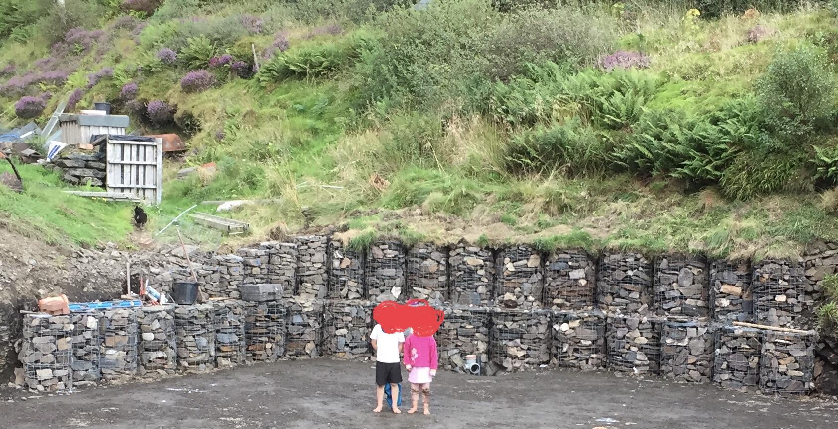

Cpd Posted August 31, 2020 Posted August 31, 2020 On 23/06/2020 at 07:41, Russell griffiths said: Could you make them out of sheep netting? Well my first lot of home made baskets have been installed ! Iused high tensile sheep netting doubled up and offset to make the holes small, wired them together and then they were filled with Stone salvaged from site. It worked really well and saved me a lot of money but it did take some time all said and done. Got a lot more projects to do so will need to get on and build some more...... 4
Onoff Posted August 31, 2020 Posted August 31, 2020 5 minutes ago, Cpd said: Well my first lot of home made baskets have been installed ! Iused high tensile sheep netting doubled up and offset to make the holes small, wired them together and then they were filled with Stone salvaged from site. It worked really well and saved me a lot of money but it did take some time all said and done. Got a lot more projects to do so will need to get on and build some more...... Handy having somewhere to store them until you need them... 1

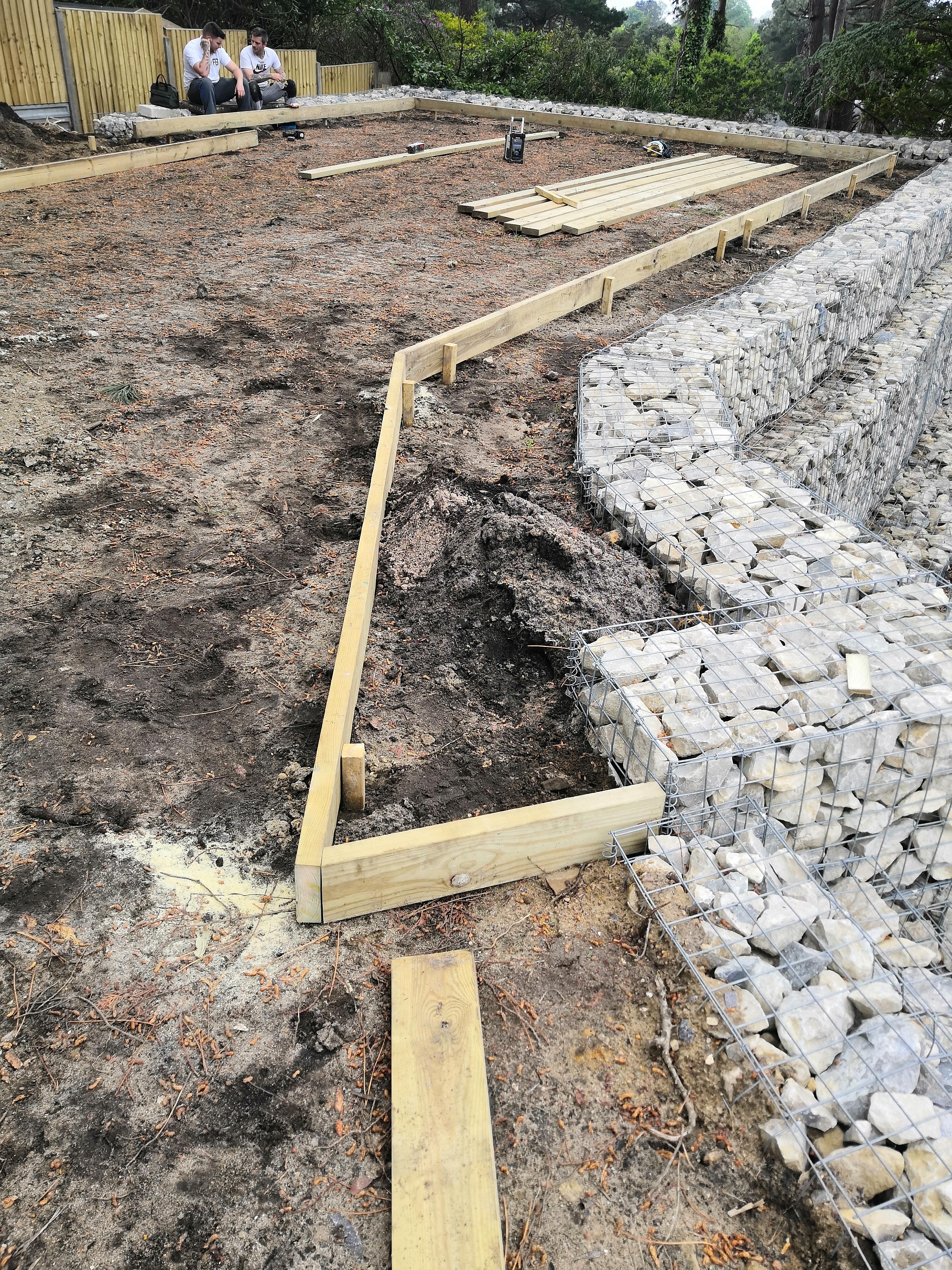

davejura Posted November 27, 2020 Posted November 27, 2020 Hi folks. I'm looking at ordering gabions from Macaferri. They are for a large retaining wall to hold up our parking area, and are specified at 4mm. Is there any advantages over using helicoils, or should I save a few ££s? Thanks.
ToughButterCup Posted November 28, 2020 Posted November 28, 2020 On 23/06/2020 at 07:41, Russell griffiths said: ... Could you make them out of sheep netting? ... Yes, if you are stacking feathers. No if you are using rock. I made some out of our spare sheets of A393, (5 or so) got rid of a load of rubbish stone in them, but covered the cages with MOT1 and then earth. The cages formed the corner of a carpark. Part of our ecological mitigation strategy. Somewhere for the newts to do whatever newts do in winter.
Adam2 Posted November 28, 2020 Posted November 28, 2020 21 hours ago, davejura said: Is there any advantages over using helicoils, or should I save a few ££s? They are quick and secure. Lacing wire I imagine does the same but will take more time to achieve similar secure connection. Will they be visible? The helicoils look ok I think. How high is your retaining wall?
davejura Posted November 30, 2020 Posted November 30, 2020 On 28/11/2020 at 17:36, Adam2 said: How high is your retaining wall? 3 metres. Not going to be highly visible.
scottishjohn Posted December 1, 2020 Posted December 1, 2020 (edited) 10 hours ago, davejura said: 3 metres. Not going to be highly visible. do you have an approved design from SE ? 3m high sounds like at least 2 rows thick ,maybe 3 + steppped maybe depending on soil type thats a lot to hold back maybe worth a look https://www.gabionbaskets.co.uk/gabion/gabion-wall-standard-design Edited December 1, 2020 by scottishjohn
Russell griffiths Posted December 1, 2020 Author Posted December 1, 2020 19 hours ago, davejura said: 3 metres. Not going to be highly visible. How about those concrete Lego blocks somebody did a wall recently in them, not very pretty but if it’s not that visible
davejura Posted December 1, 2020 Posted December 1, 2020 Yes, got approved design from SE. Was supposed to be rock armour, but their SER guy wouldn't sign it off! We are 2m x 1m x 1m running front to back x 2 layers, with second layer stepped back. 3rd layer is 2m x 1m x 1m running along the wall. We have had a shipping container sitting on the built up ground now for 2 years, and nothing has moved yet, so should be OK. Looked into lego blocks, but where we are the delivery killed it. 1
Adam2 Posted December 1, 2020 Posted December 1, 2020 I think a lot depends on what material you have on site, how much time you can put into this and how far you are from a lego concrete co. I managed to use a lot of rubble faced with nicer stone which was economical as most materials were here for free. But paid someone and it took time for a lot of gabions vs buying in blocks. Mine were visible so blocks not so good but if yours are hidden then more choices. With a 3m wall - can you stagger then over a wider area? I had ours as 2m a large lawn area (containing our soakaway) then another 1.5m some 20m apart so the overall height inc slope of lawn is about 4m but the gabions are not so complex due to the staggering - of course not always possible. Another strategy we've gone with is king post retaining walls as temporary works - just installed some 9m steels for the next one! That's a cost effective solution for some locations with steels and sleepers but I wouldn't want it for a long term structurally important solution.
davejura Posted December 1, 2020 Posted December 1, 2020 10 hours ago, scottishjohn said: maybe worth a look https://www.gabionbaskets.co.uk/gabion/gabion-wall-standard-design I have seen that, thanks. My SE seems to have over specced as usual!
