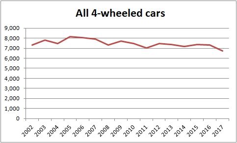

SteamyTea Posted July 7, 2019 Posted July 7, 2019 True, but I would probably go to more places if it was cheaper to do so. Motoring distance is often set on a price point, rather than an absolute milage. It is why mean annual mileage has dropped. ONS figures for all 4 wheel cars.
