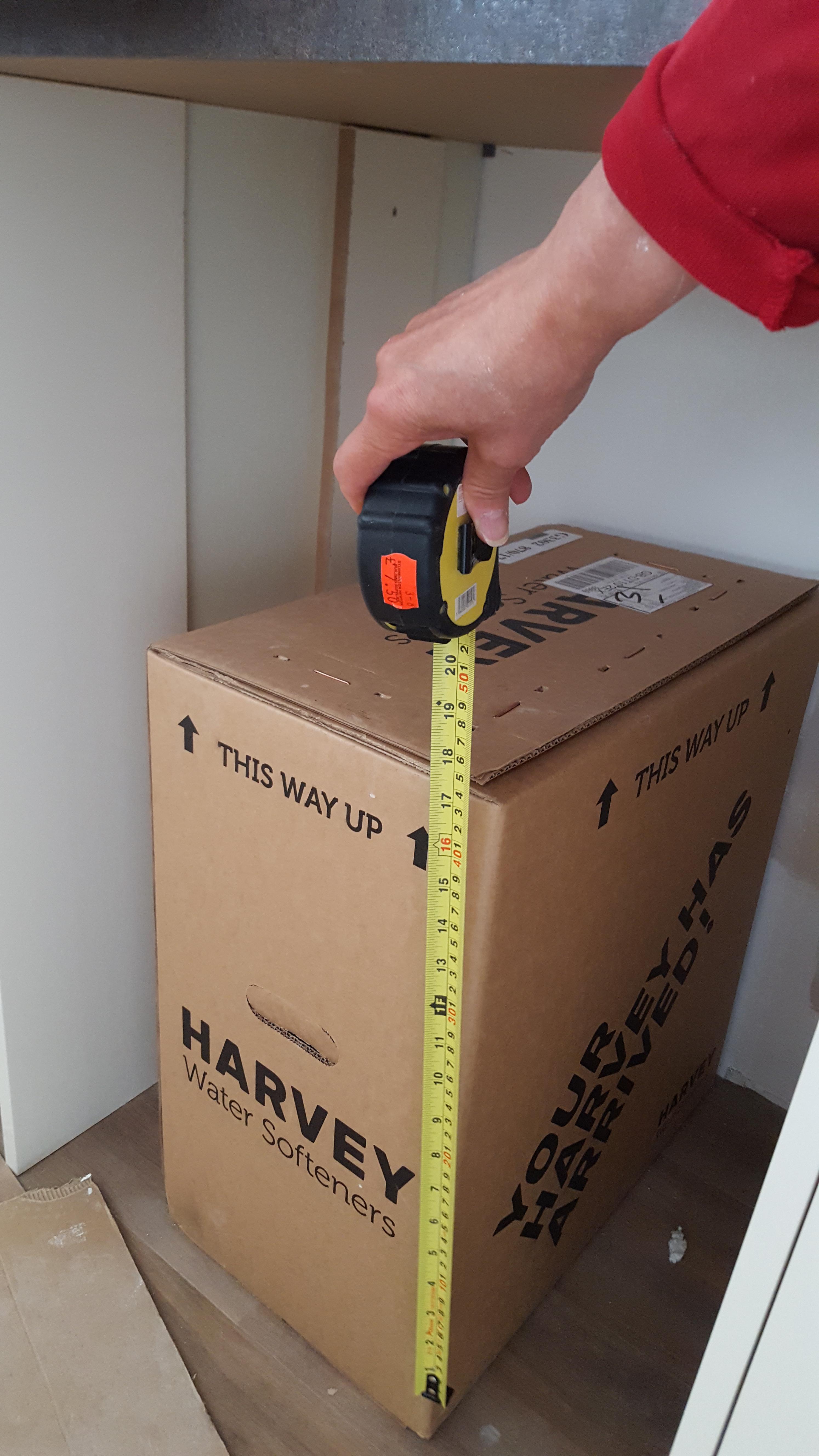

MartinP Posted July 16, 2019 Author Posted July 16, 2019 Managed to disassemble PV. The heater itself after 13months with polyphosphates looks worse than the previous one without them! (not just scaled, pitted with rust too) Need softener, period. Can you recommend one? Ideally slim vertical to fit behind PV, or in the cupboard next to it. 2 people 2 bathrooms... NB Tectite brass pushfits in hard water area are fun to disassemble...
Jeremy Harris Posted July 17, 2019 Posted July 17, 2019 That looks pretty dire for just 13 months use. Makes me wish I'd taken our old Sunamp PV heating element out after three years to see what it looked like. Harvey softeners are pretty slim and look fairly neat. We have one and it seems to work very well. They are sold under a few different names, as I think Harvey has licenced the core technology. We have this model: https://www.uk-water-softeners.co.uk/product/dimensions/ 2
vivienz Posted July 18, 2019 Posted July 18, 2019 Not the best of photos, but this is my Harvey water softener, boxed up and shortly to be installed in the garage. The void is for a standard 600mm kitchen cabinet where my dishwasher will go.
Moira Niedzwiecka Posted July 18, 2019 Posted July 18, 2019 I've just bought a Kinetico Kube from Costco at a good price. 1
