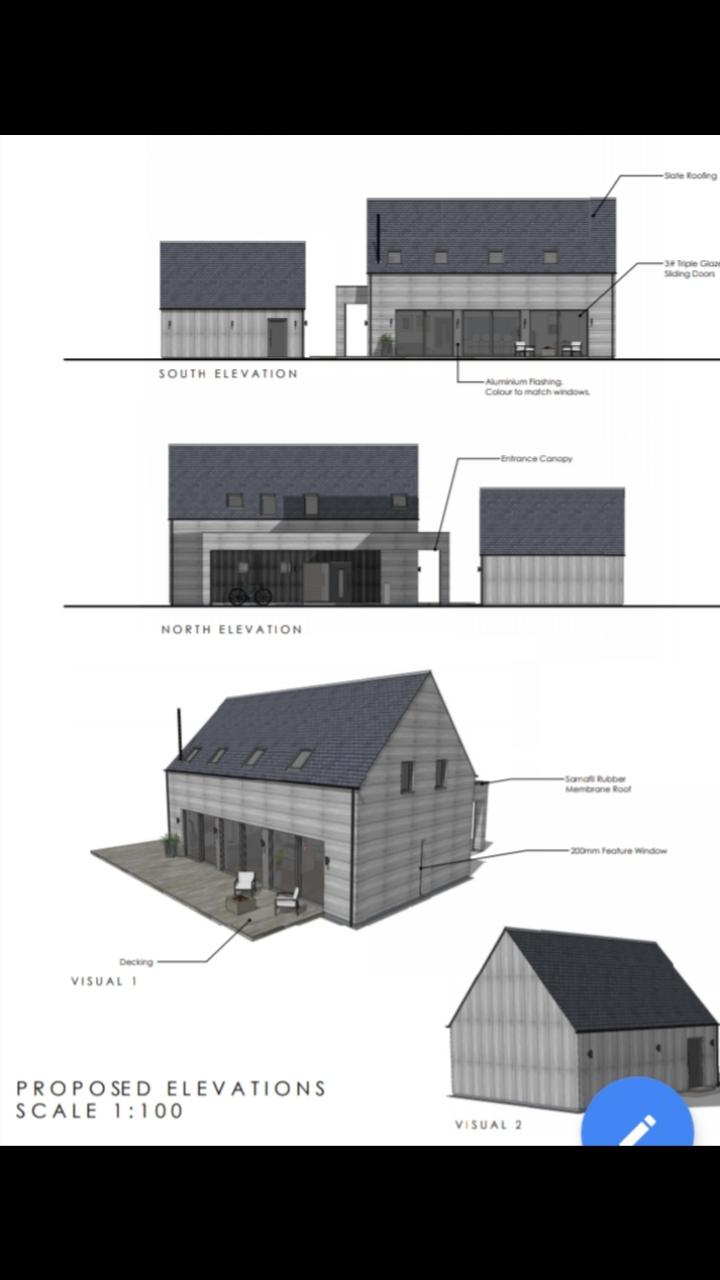

July 2, 20197 yr Hi folks, Just wanted to share our plans with the forum so those with much more knowledge than myself can cast their beedy eye. Building warrant is approved and will be going to tender within the next month. Internally the house is sitting at about 195m2.
July 2, 20197 yr Hi, exciting times, is this a timber frame house, looks similar to one I remember looking at although can’t remember what firm
July 2, 20197 yr Author Yes it is timber frame... please dont tell me it was already out there somewhere ?... We could have saved so much time haha!

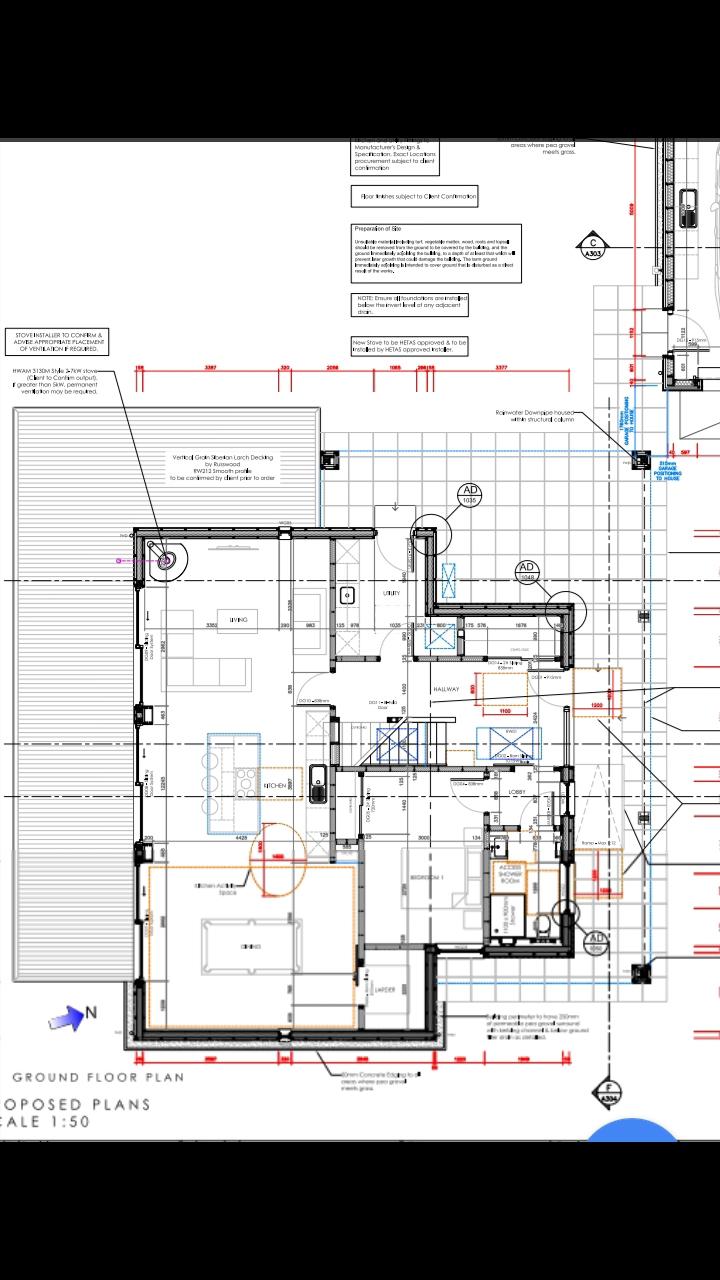

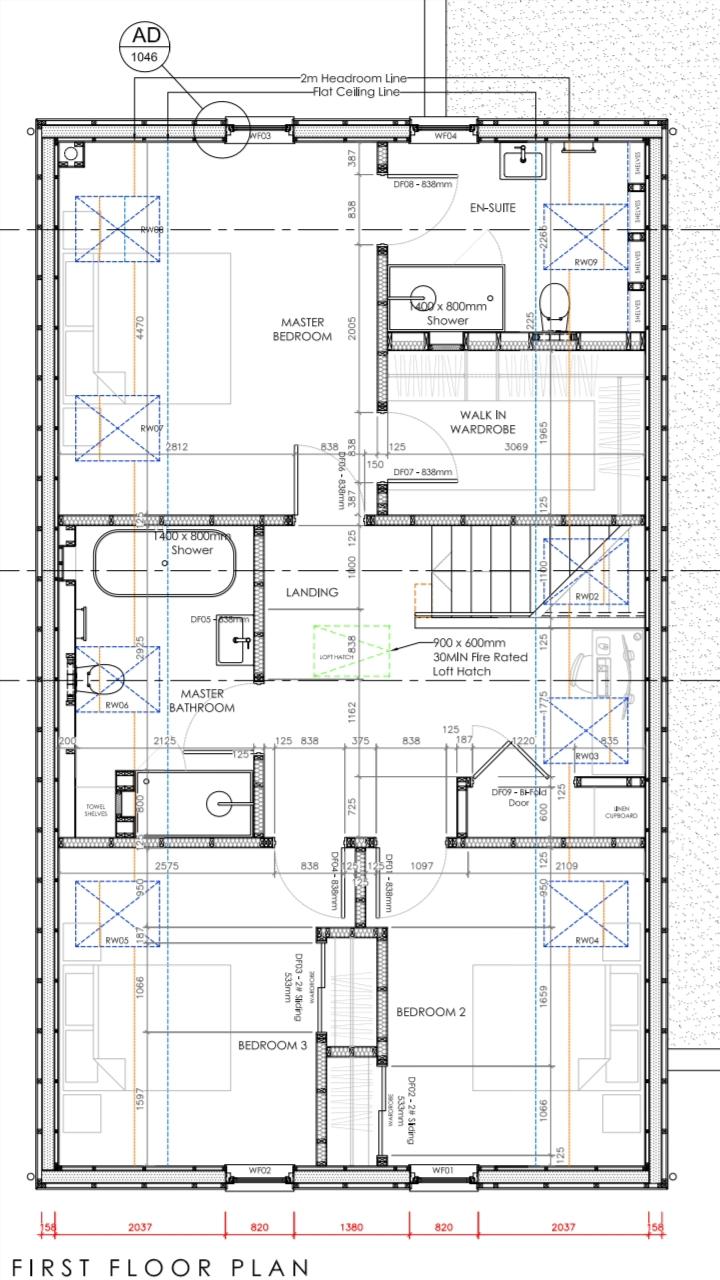

July 2, 20197 yr Personally I would not want all the living space in the same room as the kitchen. Kitchens are noisy places, living rooms should not be. Personal choice of course but one end of the room would be divided by a wall to make a cosy snug if it were mine. I would want a gable end to give the upstairs bathroom more headroom, just like we have done:

July 2, 20197 yr Author 9 minutes ago, ProDave said: Personally I would not want all the living space in the same room as the kitchen. Kitchens are noisy places, living rooms should not be. Personal choice of course but one end of the room would be divided by a wall to make a cosy snug if it were mine. I would want a gable end to give the upstairs bathroom more headroom, just like we have done: Hi Dave, yes a large separate living room is something I wanted for this reason but just could not fit it into the square footage. Thinking some extra quiet appliances and a good extractor will be worth splashing out on. A partial wall might be an idea though.... depending on the routes of foot traffic. I like your idea of the gable for the upstairs bathroom also.... tbh something I had never considered. How much hassle would that be at this stage do you think? Do you have a 1 and a half story or 1 and three quarter? Edited July 2, 20197 yr by selfbuildaberdeen

July 2, 20197 yr 7 minutes ago, selfbuildaberdeen said: Hi Dave, yes a large separate living room is something I wanted for this reason but just could not fit it into the square footage. Thinking some extra quiet appliances and a good extractor will be worth splashing out on. A partial wall might be an idea though.... depending on the routes of foot traffic. I like your idea of the gable for the upstairs bathroom also.... tbh something I had never considered. How much hassle would that be at this stage do you think? Something simple like a bifolding internal room partition so one end (with the stove?) can be closed off when you want quiet, but otherwise opened up. Changing to the gable end would probably require revised planning and certainly a revision to the building warrant. We also have 2 similar gable ends at the back to give more headroom to the 2 main bedrooms. I much prefer our arrangement to ordinary dormers. I first saw it on the Isle of Skye where it seems more common.,
July 2, 20197 yr Author Just now, ProDave said: Something simple like a bifolding internal room partition so one end (with the stove?) can be closed off when you want quiet, but otherwise opened up. Changing to the gable end would probably require revised planning and certainly a revision to the building warrant. We also have 2 similar gable ends at the back to give more headroom to the 2 main bedrooms. I much prefer our arrangement to ordinary dormers. I first saw it on the Isle of Skye where it seems more common., Yeah I like it.... much better than the standard dormers like you say. Do you have a 1.5 or 1.75 story?

July 2, 20197 yr I love that layout ..!! Get an ikea storage unit, whack 6 industrial castors on it, and use it as a moveable screen. And is that a pool table, or artistic licence by your architect ..??
July 2, 20197 yr Author Just now, PeterW said: I love that layout ..!! Get an ikea storage unit, whack 6 industrial castors on it, and use it as a moveable screen. And is that a pool table, or artistic licence by your architect ..?? it is indeed a pool table. We intend to have a dining table top for it. That section of the room had to be 5x4m specifically for it to allow for playing space. Just got to find a way to protect all the glass ?

July 2, 20197 yr In shape, size and first floor layout it is very similar to the plans we have sketched (and are having drawn just now) so it goes without saying that I think it looks really good! Love the idea of sectioning off the snug/bedroom and downstairs shower room from the rest of the property - we also have a downstairs shower room and separate snug-cum-spare which I'll have a look at again to see if it's possible to section that off. First instinct is it might not be.
July 2, 20197 yr Prehaps this is one other members were suggesting similarities with. https://www.ruralhouse.co.uk/houses/r3/ Is your plan for a kit or will it be a bespoke project?
July 3, 20197 yr Author 7 hours ago, eandg said: In shape, size and first floor layout it is very similar to the plans we have sketched (and are having drawn just now) so it goes without saying that I think it looks really good! Love the idea of sectioning off the snug/bedroom and downstairs shower room from the rest of the property - we also have a downstairs shower room and separate snug-cum-spare which I'll have a look at again to see if it's possible to section that off. First instinct is it might not be. Our plan is to do it with a sliding barn door so will hopefully be a nice feature when you first come in. There will also be another barn door into the larder to tie it together the small lobby area it makes could be classed as wasted space but i think for flexibility and in order to meet regs for access it was needed
July 3, 20197 yr Author 8 hours ago, Thedreamer said: Prehaps this is one other members were suggesting similarities with. https://www.ruralhouse.co.uk/houses/r3/ Is your plan for a kit or will it be a bespoke project? Yes very similar indeed It will be a scotframe kit made from our design. We looked at loads of different designs already out there but ended up changing them so much we might as well of just started from scratch. Edited July 3, 20197 yr by selfbuildaberdeen
July 3, 20197 yr Author 9 hours ago, the_r_sole said: Looks good, presented similarly to the R-house products I think so maybe that's what people are picking up on... you going for a blown cellulose insulation? quite a big house, what are you hoping (or dreaming!) it's going to come back from tender at? Yes had another look at R house and it is defiantly a website i came across all those moons ago when plans were first coming together. We struggled to find a layout with 3 bedrooms upstairs which all had easy access to each other. Only 2 beds upstairs is no use with young children. some of the heb homes had 3 beds upstairs but with 2 staircases so in the middle of the night it was down a flight, through the house, up another flight and into a kids bedroom which was technically right next door. It will be a closed timber kit and top hat trusses roughly 195m2 internally. Aiming for tender coming back around the 300k. That does not include chuckies on the drive, fencing, decorating, supply and fit kitchen/bathrooms, tiling..... we will supply/fit all that ourselves. QS has been on board from the start so im hoping his calcs are worth the money we have paid for them! Edited July 3, 20197 yr by selfbuildaberdeen
