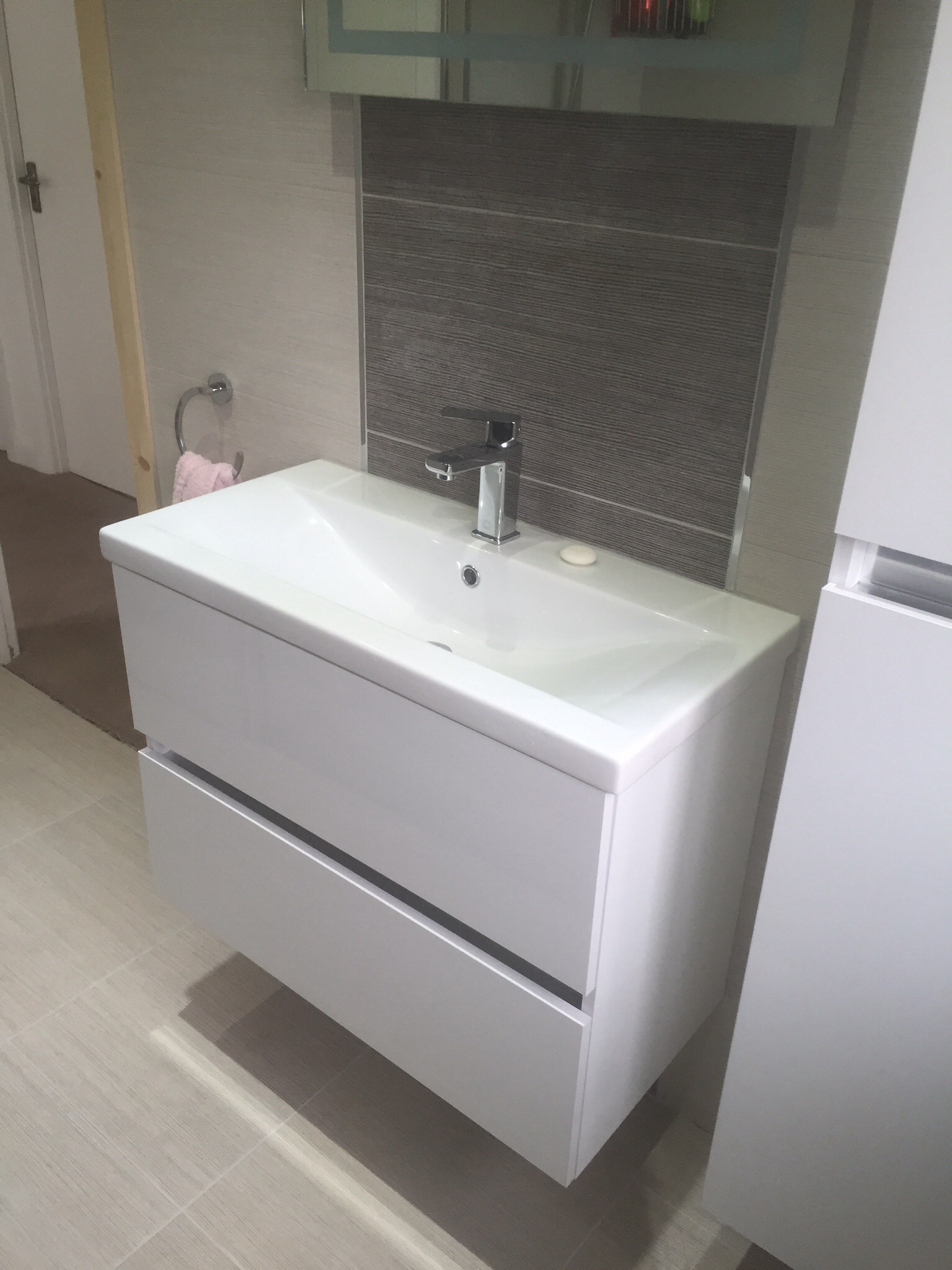

Bitpipe Posted September 17, 2016 Posted September 17, 2016 1 hour ago, Nickfromwales said: I did.....up to the point I was sweating, effing and jeffing, and looking like a cheerleader. Cant be done. End of. Anybody know what I'm on about? And split one ? Just me then ? Our plumbers had never heard of it but I made them use it on Nick's recommendation to fix the shower trays and anywhere silicone would have been used. So, our en-suite sink and cabinet were been bonded onto the tiles with Sikaflex. A few weeks later they had to be removed to get at the leak we had. Two plumbers, a joiner, multitool, global fish knife and much swearing and it still wouldn't budge. Finally got it off and cracked the sink in the process (invisibly fixed by MagicMan). Now they swear by it. - I've just used it to fit some 8mm U channel side on to the wall to take the son's shower screen and it's rock solid. 1
Nickfromwales Posted September 18, 2016 Posted September 18, 2016 I have to do exactly the same thing next week......Tap washers gave up the ghost so the carcase got soaked over time and it all swelled up so I have to remove and refit the sink and renew the cabinet. Not looking forward to it tbh, and it's a riven, ceramic tile I'm going to cut the unit into firewood and remove one bonded side at a time. I hope the tiles stay on the wall !
