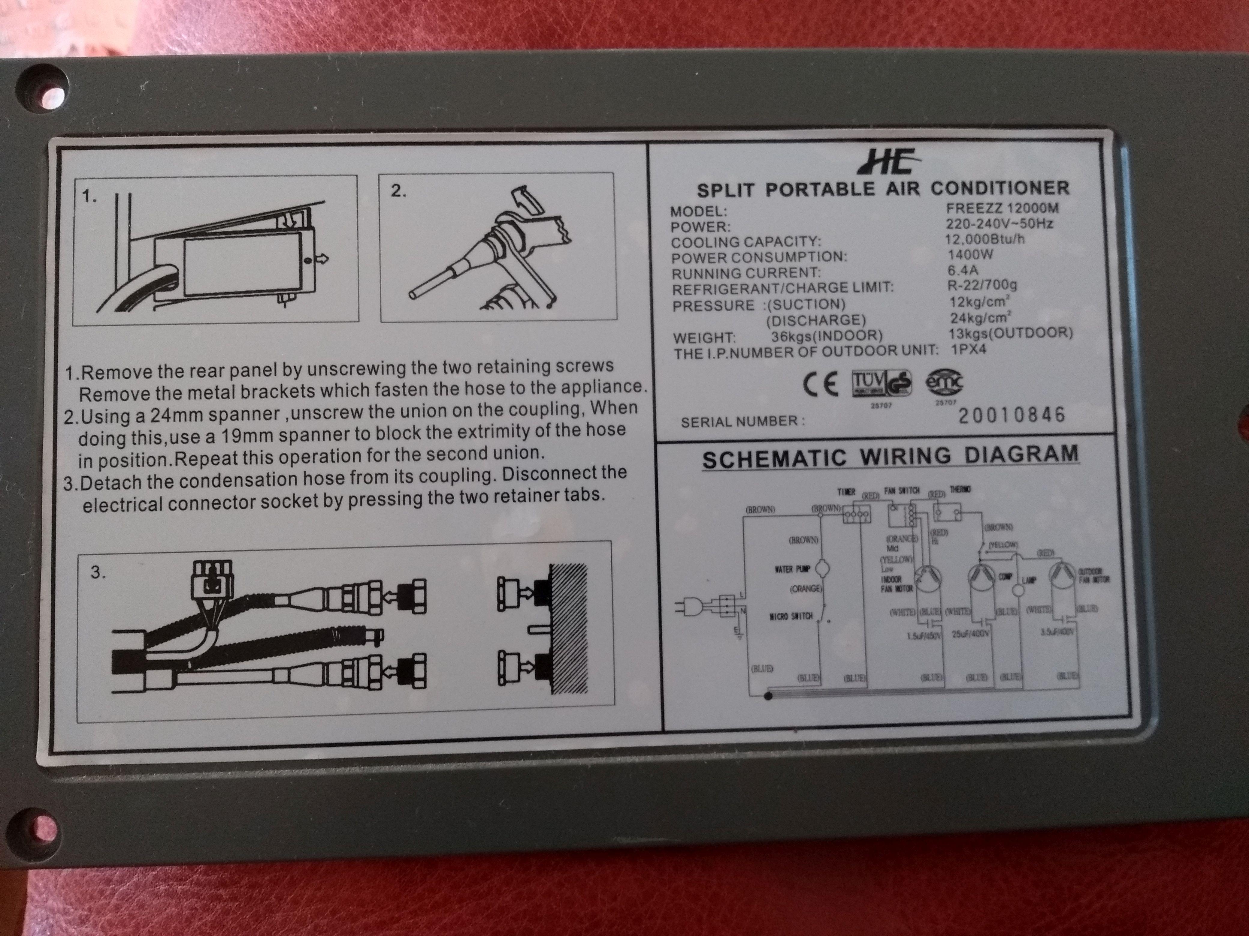

Temp Posted July 1, 2019 Share Posted July 1, 2019 We had a small precharged split unit purchased in Belgium 12 years ago. The unit came with instructions on how to separate the two units to allow the pipe to pass through a hole in a wall. As I recall the ends of the pipe had some valves that automatically sealed when disconnected. 2 Link to comment Share on other sites More sharing options...
Jeremy Harris Posted July 1, 2019 Author Share Posted July 1, 2019 @Temp, do you recall how big the pipe end fittings were by any chance? It doesn't seem to be something that's included in the spec for any of the units I've looked at, yet it's fairly significant, as I need to get the pipes out through a duct fitted through the wall, and would much rather have as small a hole as possible. Link to comment Share on other sites More sharing options...

Temp Posted July 1, 2019 Share Posted July 1, 2019 (edited) 3 hours ago, JSHarris said: @Temp, do you recall how big the pipe end fittings were by any chance? It doesn't seem to be something that's included in the spec for any of the units I've looked at, yet it's fairly significant, as I need to get the pipes out through a duct fitted through the wall, and would much rather have as small a hole as possible. Wife reminds me we still have the unit in the garage! The indoor unit is "portable" in that it's on castors but you can't move it around much. The outdoor unit is intended to be hung on an outside wall. Here is a photo of the pipe connections and the instructions on the back of the indoor unit. They are fixed permanently at the outdoor unit. The pipe is oval and has in it.. Flow & return pipes, a condensate tube and an electrical cable. Overall dims of the pipe are about 50mm x 25mm. The connectors on the end are 24mm (across the flat) but can't be sent through the hole individually. So I think the hole in the wall would need to be at least 50mm and 60mm diameter for comfort. The grey stuff on the cold is foam tape. Underneath it looks similar to the hot connection. Edited July 1, 2019 by Temp 1 Link to comment Share on other sites More sharing options...
Jeremy Harris Posted July 1, 2019 Author Share Posted July 1, 2019 Many thanks, @Temp, that's perfect, exactly what I was after! I fitted a second MVHR air feed through the wardrobe and up to a terminal on the wall, right where I now want to fit the indoor unit. To get a neat looking duct run inside the wardrobe I used 110 x 54 PVC rectangular duct, so with luck the pipes will all be able to run inside this. Link to comment Share on other sites More sharing options...

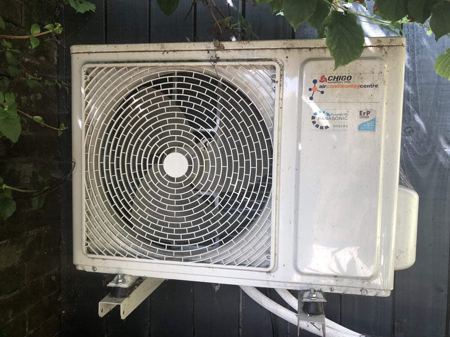

MrMagic Posted July 2, 2019 Share Posted July 2, 2019 I have exactly the unit that was linked earlier (CPC) which was 'DIY' fit (and then later serviced by a Fgas engineer) as well as 4 fitted units in the house. The compressor is pre-charged and holds the refrigerant based on a maximum pipe length that can be found in the instructions. The pipes are just normal A/C piping and are reasonably soft so you can bend as required. I would caution, you get what you pay for here... 1) Strictly speaking this must be installed by an Fgas engineer 2) The purging method is bonkers.. but thats how the chinglish instructions tell you to do it. Vac-pump would be much better and would help confirm the joints are tight 3) My unit is still working but sometimes it seems to have a funny-5-mins. Turning it off and back on again solves this 4) The DIY fit ones take power from the indoor unit - most other systems take power from the outdoor unit 5) The 4 indoor units - pro-fitted Mitsubishi - have worked flawlessly since install I'm sure you have the skills to do the install justice but I'd go for a more recognisable brand (Mitsubishi, Daikin etc). At least then you have some options for servicing/parts in the future. As far as I'm aware a lot of the outdoor units now come pre-charged... Heres some pics of the 'no-name' unit... And the Mitsubishi units.. 1 Link to comment Share on other sites More sharing options...

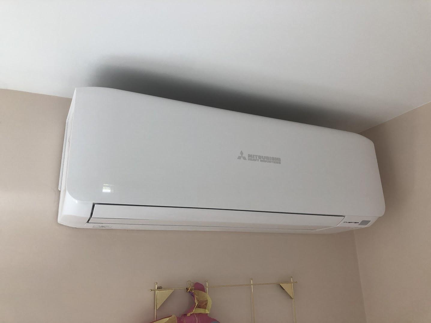

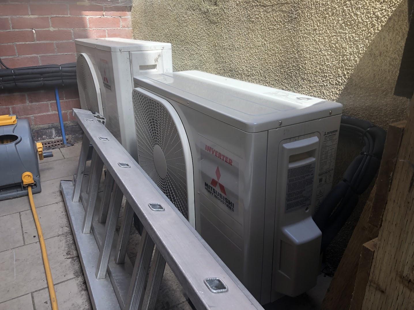

MrMagic Posted July 2, 2019 Share Posted July 2, 2019 (edited) @JSHarris - Exact same units... mine are the 2Kw version (1x standalone, 1x 3 way multi-split) Can't fault them. They seem very efficient as well - the 2Kw one seems to ramp to about 700w at power on but then settles down and purrs along at about 400w when the compressor is running, and negligible when just circulating. Outdoor units are pretty much silent, theres a 'quiet' mode button on the remote that reduces them even further. The only time they make any noticeable noise is when the compressor stops, the fan ramps for 20 or 30 seconds before shutting off.... but as you already have a ASHP, you'll be used to all this. Edited July 2, 2019 by MrMagic 1 Link to comment Share on other sites More sharing options...

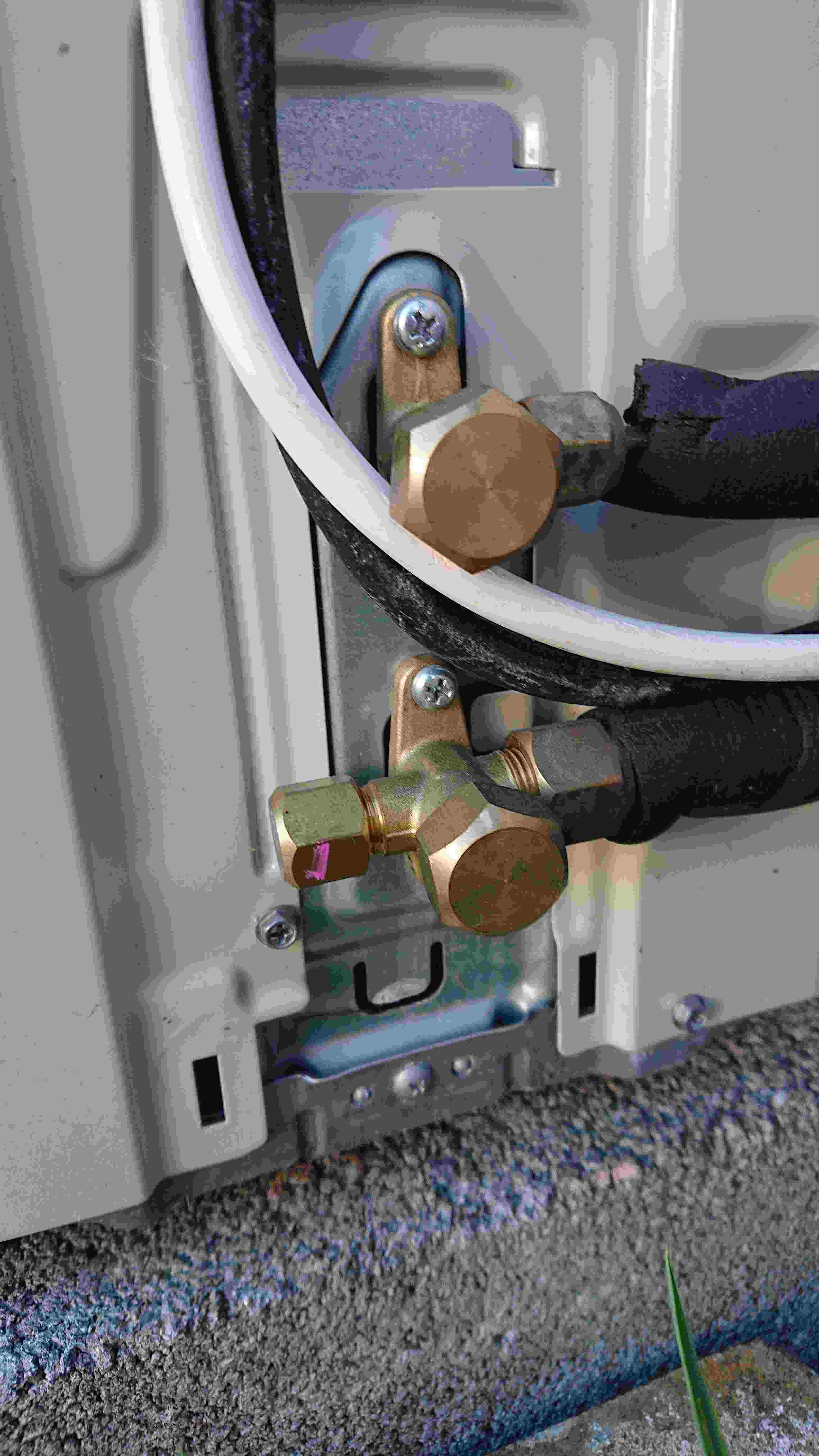

Jeremy Harris Posted July 2, 2019 Author Share Posted July 2, 2019 1 hour ago, Miek said: I've fitted a 2.5kw daikin unit, diy. The hole in the wall was an offcut of rainwater downpipe which I foamed around. The copper pipe is soft 1/4" & 3/8" which you need to flare into a cone with a pipe flaring kit. I bought the install kit with the unit to make life easy. This is easy to do IMO. Condensate drain is 20mm flexible pipe. You can hire the vac pump for £100 a week but I chose not to and just bubble tested the fittings. Bought the kit from Saturn sales, very helpful and thorough diy instructions supplied, although they explicitly say that if it is not fitted by an Fgas engineer then the warranty is void on the unit. Thanks. I have a vacuum pump that I used to de-aerate mixed resin, home made, from an old freezer compressor, but it pulls a pretty good vacuum and has a gauge. I wonder if I could use that to pump the system out and leak test the pipe connections? Presumably there's a port on the valve block to allow a vacuum pump to be connected. 9 minutes ago, MrMagic said: @JSHarris - Exact same units... mine are the 2Kw version (1x standalone, 1x 3 way multi-split) Can't fault them. They seem very efficient as well - the 2Kw one seems to ramp to about 700w at power on but then settles down and purrs along at about 400w when the compressor is running, and negligible when just circulating. Outdoor units are pretty much silent, theres a 'quiet' mode button on the remote that reduces them even further. The only time they make any noticeable noise is when the compressor stops, the fan ramps for 20 or 30 seconds before shutting off.... but as you already have a ASHP, you'll be used to all this. Sounds ideal, especially as it's quiet. Our ASHP is very quiet, we can't ever hear it inside the house, and it's only barely audible outside - I often have to look in the grill to see if the fan is going around, as at low speeds it's just about inaudible. The plan is to mount the outdoor unit on the rear wall of the house, which faces North, and is hidden by our big retaining wall. There's a ~1.8m wide gap between the rear of the house and the retaining wall, so it should be OK there, and if the unit runs quietly that's a bonus, as I'm slightly concerned about noise transmission into the wall of the house. Unfortunately the paved path at the rear of the house is right up against the house wall, so I don't have the option to ground mount the unit. The indoor unit will be in our bedroom, but as I doubt we'll have it on at night (the house stays cool for a long time once it's cooled down) noise shouldn't be a problem. I think we'll probably run it during the day when the weather's hot (and the PV system is generating) and shut it down over night. and rely on the cool air from the MVHR Link to comment Share on other sites More sharing options...

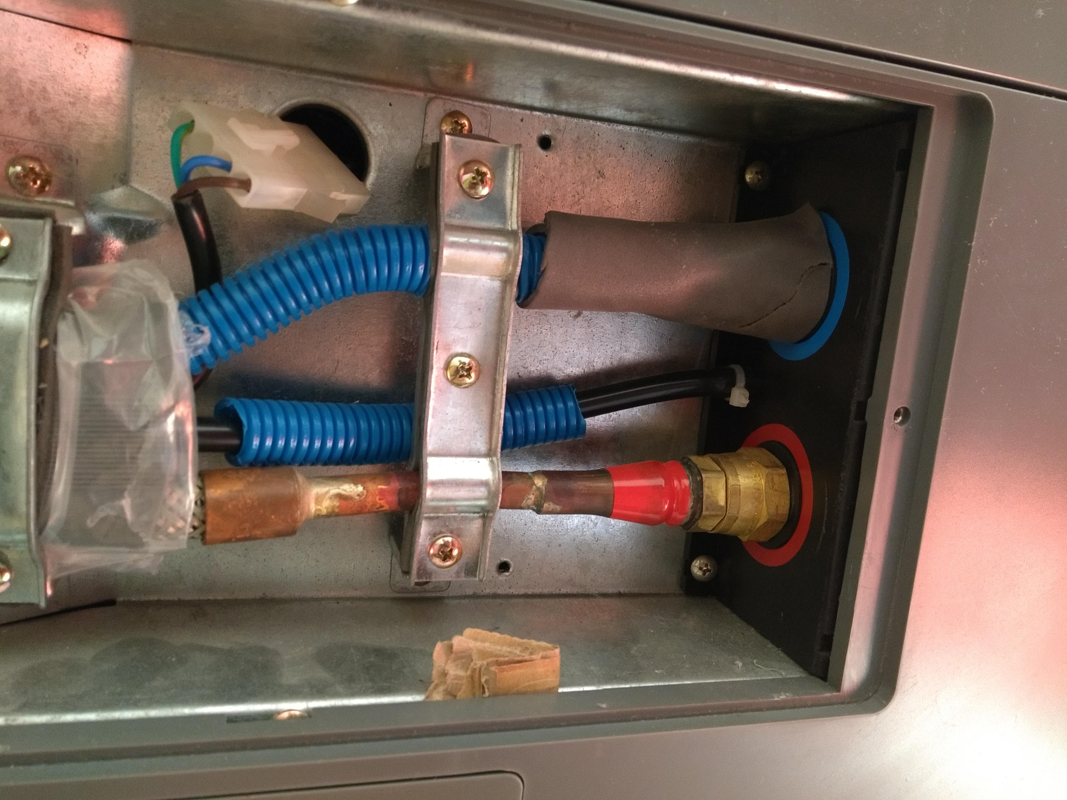

Miek Posted July 2, 2019 Share Posted July 2, 2019 6 hours ago, JSHarris said: Presumably there's a port on the valve block to allow a vacuum pump to be connected. Yes, the port in the LHS in the pic with pink on it. One other point is that there is a maximum length of pipe run for the pregassed units. Mine was 10 or 15m IIRC. Not usually a problem in the domestic situation. 1 Link to comment Share on other sites More sharing options...
