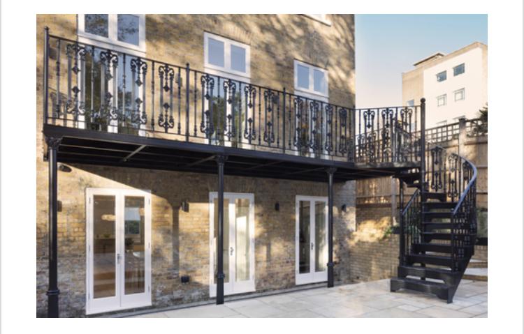

zoothorn Posted June 24, 2019 Share Posted June 24, 2019 G'day folks- I need to design a simple timber balcony, onto my 1st floor extention, so a pair of french windows can open onto. Steps up to it from ground. A cost-effective pretty simple approach is key (me to build it), functional but strong: smallish & decent looking for PP to approve (a non-material ammendment). Decking boards, softwood. Are there any timber minds out there? At the moment I've got some pic eg's as a rough guide. I have some woodwork skill, & Circ/ chopsaw etc.. but no idea of basic construction. Approx eg's. Steps up to the 1st pic, from the side/ perpendicular wall. 2nd pic good for depth & simplicity (~1.2m). 3rd pic good for width. Perhaps 45* braces for aesthetics (PP might like), like pic 4. Thanks, zoot Link to comment Share on other sites More sharing options...

PeterW Posted June 24, 2019 Share Posted June 24, 2019 If you want steps and a big platform then you’ll need planning - that is not a non-material amendment. What they will be expecting is a balcony about 18” wide and 6ft long , not something that you can have a hot tub party on it ..!!! You can can do something like a small balcony using a wall plate and hangers with a timber top and balustrade, or something like this ..?? Cast Spirals Link to comment Share on other sites More sharing options...

PeterW Posted July 1, 2019 Share Posted July 1, 2019 I’ll be really surprised if they let anything more than a 2mx500mm balcony through as a non material amendment ..! You need to design this properly - possible one for an engineer or add on for your timber frame company to do it right. This is not something to do on the advice of an Internet forum ....!!! Link to comment Share on other sites More sharing options...

PeterW Posted July 1, 2019 Share Posted July 1, 2019 17 minutes ago, zoothorn said: I would've thought this was the ideal small build project, for such a self-build forum; a simple timber structure (like my pic eg's) added to the house, which I could take my time doing once the extention's built. I A fall from that distance could cause injury - potentially serious. You’re talking about potentially trying to cantilever some sort of staging from the side of a building, and that needs to be designed carefully. For example, the balustrade needs to be 1100mm high, gaps no more than 99mm. It will be subject to building regs so has to meet all the regs for structure. You'll also need to make sure the underlying structure is capable of taking the loads. This needs to be designed in from the start. You could potentially build a full cantilever beam from the inside of the structure but ... it needs designing ..! Has the builder come back with a price for the main structure yet ..?? Link to comment Share on other sites More sharing options...
zoothorn Posted July 1, 2019 Author Share Posted July 1, 2019 Hi Peter- Ive never had the idea of a cantilevered balcony, but rather as per my pic eg's: three vertical posts > connect topgether with cross beams. An opposite beam aatched to the extension (or supported by vertical posts too). Then span across with a boardwalk/ decking boards = basic shell. Then ballistrades/ or basic railing yes. I cannot think of a simpler build tbh. Its not high at all.. the lower room's set down 2 ft & barely 6.5 ft high to its ceiling too. The balcony would be approx 6ft to the deck. Can you see the photo eg's I added in the 1st post? none have cantilevered balconies: all are simple wood constructions, the outer/ far sides supported by a few pillars that extend up as the ballistrades. No I haven't heard from builder, I re-sent my quote request a week+ ago & asked if he had rcvd & seen it/ yes. But I now expect to wait another month for a reply maybe two. I have no knowledge that this sort of 2-3 month wait for quotes timeframe isn't normal. Link to comment Share on other sites More sharing options...

PeterW Posted July 2, 2019 Share Posted July 2, 2019 7 hours ago, zoothorn said: three vertical posts > connect topgether with cross beams. An opposite beam aatched to the extension (or supported by vertical posts too). Then span across with a boardwalk/ decking boards = basic shell. Then ballistrades/ or basic railing yes. I cannot think of a simpler build tbh. Its not high at all.. the lower room's set down 2 ft & barely 6.5 ft high to its ceiling too. The balcony would be approx 6ft to the deck. This needs designing properly ...!! There is no racking strength (ie what is stopping it twisting and falling) and that’s the minimum to stop it moving with anyone stood on it. What’s the purpose of this balcony..??? If it’s just for somewhere to stand when you come out of the French doors then extend the room below and make it a flat roof. Much more stable, and probably quicker as the builder will do 95% of the work. Whatever you do, it will need to be done to get building regs sign off as you cannot have a set of French doors opening into thin air so you either have to build the balcony structure or put some sort of temporary Juliet arrangement before sign off. Link to comment Share on other sites More sharing options...

redtop Posted July 2, 2019 Share Posted July 2, 2019 whilst i agree it def needs BC and a SE to design it properly i cant see how it would be difficult or expensive to build at all. Couple of posts to take the weight with pad foundations underneath and then supporting joists properly anchored into the main building wall. bit of decking and ballistrade and bobs your uncle. So yes needs doing properly of course but i can see no reason why it would be even close to the cost of building a room underneath with a flat roof. FYI our house is raised on stilts due to trees and steep slope with a raised decking (aprox max 2.5M above ground level) leading from the kitchen / diner double doors. It has all been designed by a SE and has passed planning and i can certainly confirm the decking area is massivly cheaper to build than even a small part of the main house. I will be doing the decking bit myself. re the foundations, the piles are being extended to cover the decking area. There is a trade association for deking that covers all the regs for raised platforms and raised applies to anything above 1ft! Free to join and access the regs. There is another cut-off height (I cant remember what) above which the requirements get a bit more onerous (I think we are in the 'bit more onerous' bracket). Good idea, i love a nice balcany ? Link to comment Share on other sites More sharing options...

Mr Punter Posted July 3, 2019 Share Posted July 3, 2019 These Codes of Practice should give all the information you need for the specification and design, giving span and load tables, connection types etc. They cover balconies >2.4m from ground and raised decks. tdca_cop_balconies_e32018.pdf tdca_cop_raised_timber_decks_e62018.pdf Link to comment Share on other sites More sharing options...
zoothorn Posted July 3, 2019 Author Share Posted July 3, 2019 Peter, I can only think then that welsh PP then is different if Ive spoken to the PP officer himself & he's said, as I've explained. Can you just tell me you can see the images I posted in the OP?? if so.. Pic 1: if you were to narrow this (it looks approx 2m deep) to 1m, like pic 2, & add some simple steps up.. that's my basic design right there. Now that is not very complex: that's pretty much the very opposite I'd argue- very simple. Its far better to imagine a mash-up of pics 1 & 2.. rather than me sketch, or my describing it (I know I faff too much spiel: general apologies all! much appreciate your reading). thanks zoot schmootz Link to comment Share on other sites More sharing options...
