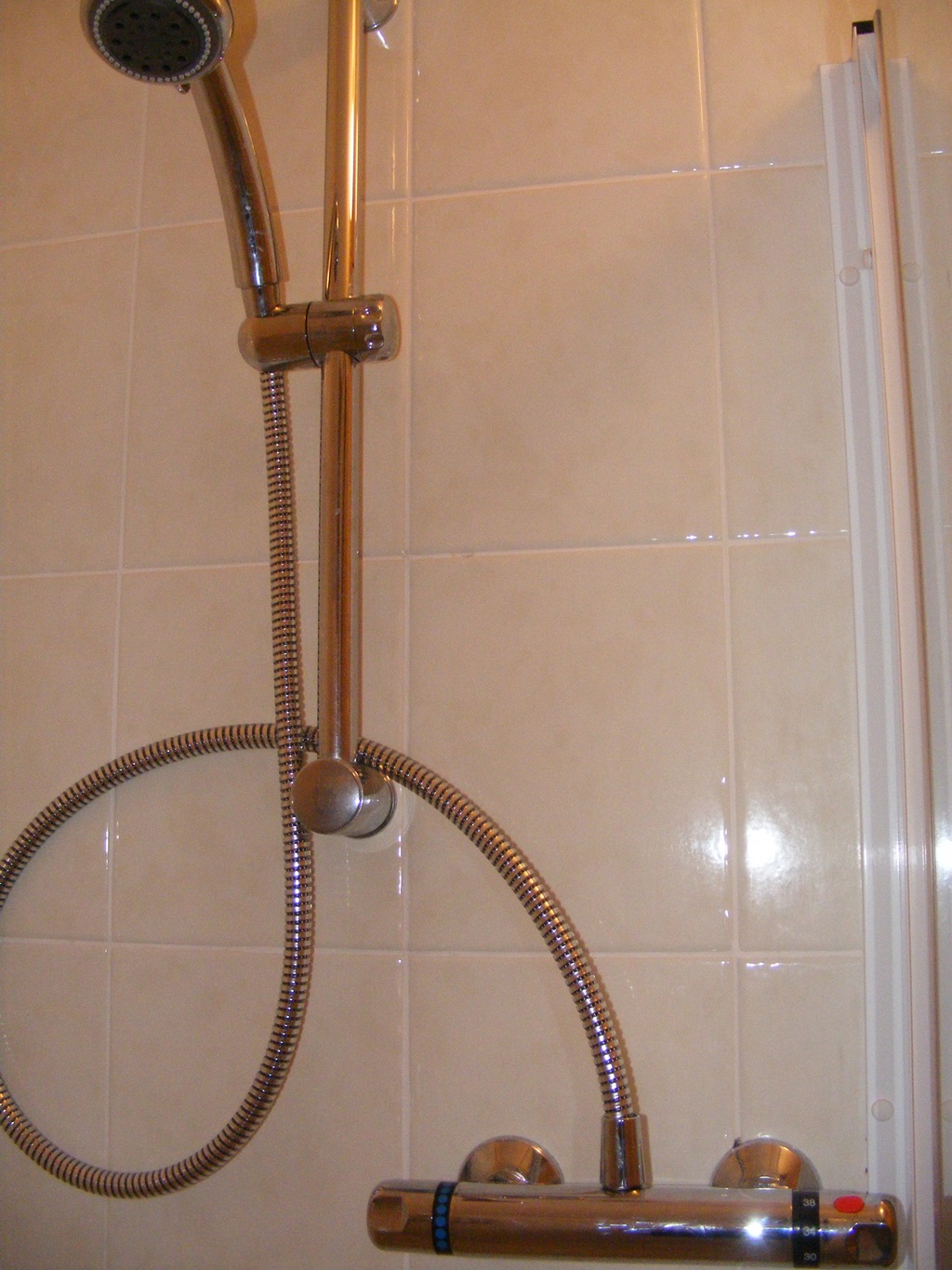

ProDave Posted September 19, 2016 Author Share Posted September 19, 2016 Well my £15 mixer arrived today. Slight faux pas. Description on the bay wasn't too good. It turns out the outlet is on the top and a larger diameter thread. I suspect it was intended to connect to a rigid pipe to a fixed shower head, not a hose to a handheld. Never mind, I soon discovered the outlet boss screws into the main body,and the thread in the body is nearly * the same size so I swapped them over from the old to the new. All now working, and i won't grumble about the hose coming out of the top instead of out of the bottom. * they were the same diameter thread but a slightly different pitch. The boss should screw in, until it bottoms out on an O ring flange. But due to the slight thread pitch difference it only goes in about 3 turns and binds before the O ring reaches the flange. Solved with ptfe tape. Link to comment Share on other sites More sharing options...
Nickfromwales Posted September 19, 2016 Share Posted September 19, 2016 Post a pic Dave, you know you want to Link to comment Share on other sites More sharing options...
ProDave Posted September 20, 2016 Author Share Posted September 20, 2016 Okay Link to comment Share on other sites More sharing options...
Nickfromwales Posted September 20, 2016 Share Posted September 20, 2016 For £15 you can't really argue, but my OCD is kicking off with the hose going up. Link to comment Share on other sites More sharing options...
ProDave Posted September 20, 2016 Author Share Posted September 20, 2016 Up is the new trendy. When you see it on Grand Designs, remember you saw it here first. 3 Link to comment Share on other sites More sharing options...
