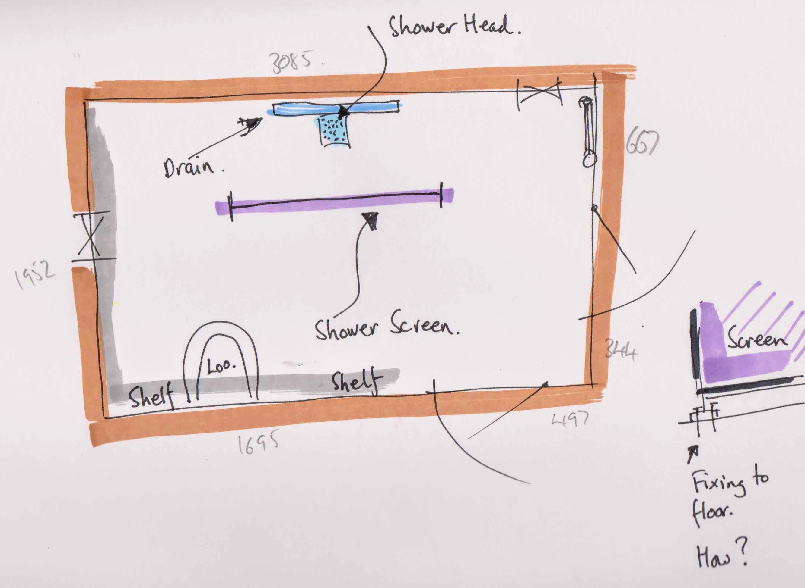

ToughButterCup Posted June 21, 2019 Posted June 21, 2019 ... without ruining the waterproof seal below the tiles? Look at this: At the moment I plan to suspend the screen from the ceiling - and until I bothered to think about it, intended to fix it to the floor. But then I looked at the issue in detail, I realised that in fixing it to the floor, I would puncture the waterproof seal. Someone has solved this problem before - many by what I now see as dubious means - make slots in the tiles; screw to the floor, and so on. Do I need to re-think the position of the shower ( and therefore shower screen) ?

Jeremy Harris Posted June 21, 2019 Posted June 21, 2019 Probably one for our resident wet room expert. Are you there @Nickfromwales? When I fitted our wide shower screen, I didn't like the idea of drilling holes in the shower tray to secure the small bracket on the outer lower edge of the screen, so I just used a bead of clear CT1 along the outer edge of the glass at the bottom, where it meets the tray. I'm surprised at how rock solid this is, it doesn't seem to want to go anywhere, and has withstood the odd knock and the edge of the glass being used as a hand hold.
Bitpipe Posted June 21, 2019 Posted June 21, 2019 (edited) I have done this. Believe Nick gave me the method. Two ways: 1) Screen on tile (wet room) , used 8mm alu U channel and bonded base to tiles with Sikaflex and then more Sikaflex in the channel to take the glass. No fixings on the horizontal run (but some on the vertical) 2) Screen on shower tray (non wet room) no alu channel on the bottom - balanced glass on 2mm spacers and sikaflexed along the 2mm gap between tray and glass. When it had gone off, poked out spacers and filled gaps with sikaflex Edited June 21, 2019 by Bitpipe Conflated two shower screen installs!
Oz07 Posted June 21, 2019 Posted June 21, 2019 You can buy U channel. Recently had a shower tray out of level which a frameless enclosure needed to go on. 6mm gap to nothing with a hung door on the 6mm end pushing it in. Bought some U channel, siliconed it to tray, slid glass in, rock solid

MAB Posted June 21, 2019 Posted June 21, 2019 Clear CT1 worked well for glass panel onto a walk in shower tray for me as described by Nick in the link above.
PeterW Posted June 21, 2019 Posted June 21, 2019 @AnonymousBosch you’ll find CT1 just as good as SikaFlex, or go with clear StixAll which is Sika in a different tube. I pay £6.30 a tube for CT1 so no extortionate.
