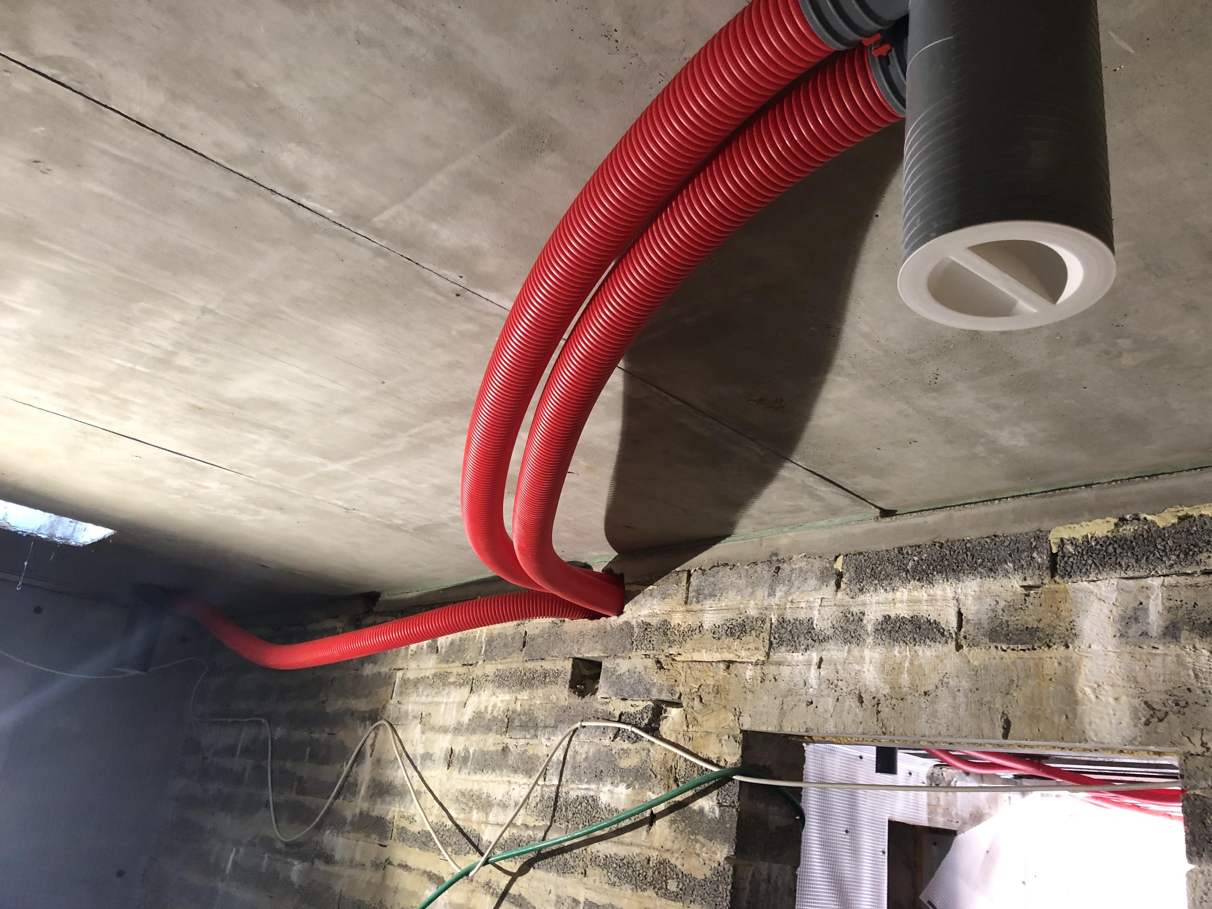

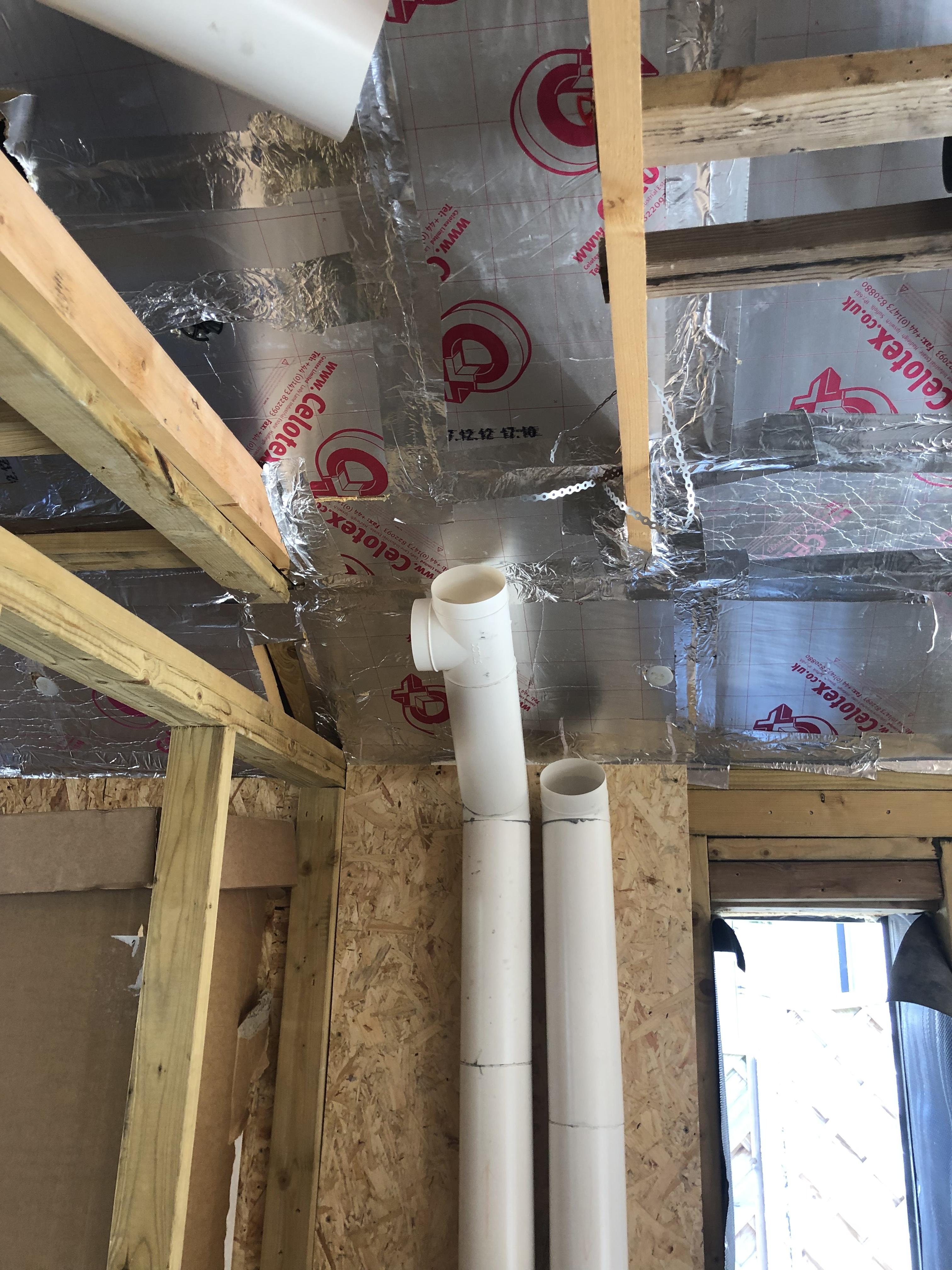

PeterW Posted August 21, 2019 Posted August 21, 2019 Looks very tight to the roof ..? Are you able to get bends and silencers etc on that ..??
Pocster Posted August 21, 2019 Author Posted August 21, 2019 (edited) 13 minutes ago, PeterW said: Looks very tight to the roof ..? Are you able to get bends and silencers etc on that ..?? Yes - should do . Was told by bpc that I can fit the flexible silencers first to Mvhr - which should give me enough ‘bend’ to be in the loft space . Edited August 21, 2019 by pocster

Pocster Posted August 21, 2019 Author Posted August 21, 2019 Can you mount the spigot upside down ? So bottom entry rather than top ???

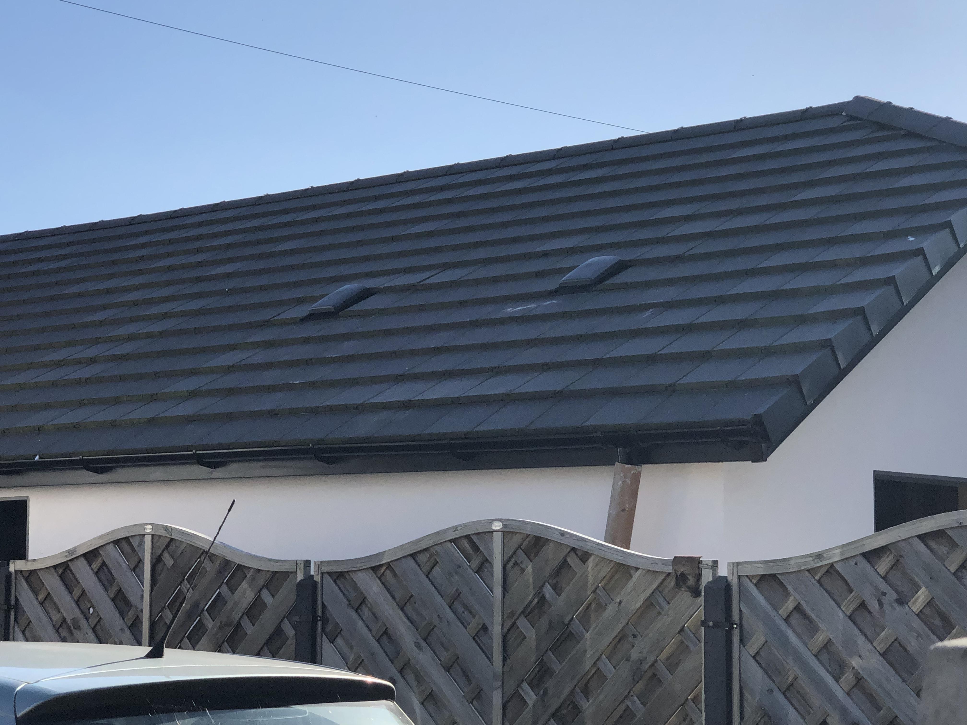

Pocster Posted September 13, 2019 Author Posted September 13, 2019 Got roofer I trust to put mvhr roof vents in 1
dpmiller Posted September 13, 2019 Posted September 13, 2019 are those tiles all in neat unbonded rows?
Pocster Posted September 13, 2019 Author Posted September 13, 2019 30 minutes ago, dpmiller said: are those tiles all in neat unbonded rows? Sigh yes ! . Even this ‘proper’ roofer queried why they were done like that ...
PeterW Posted September 13, 2019 Posted September 13, 2019 38 minutes ago, dpmiller said: are those tiles all in neat unbonded rows? I think I questioned that when they went on ... 1
Pocster Posted September 13, 2019 Author Posted September 13, 2019 (edited) 1 minute ago, PeterW said: I think I questioned that when they went on ... Yep - you did .... Original roofer ( if that is what he was ) said “it didn’t matter “ Edited September 13, 2019 by pocster
Oz07 Posted September 14, 2019 Posted September 14, 2019 You do see a few roofs like that with the flat tiles perhaps the interlock detail means it's ok who wouldn't want bonded though?
ProDave Posted September 14, 2019 Posted September 14, 2019 46 minutes ago, Oz07 said: You do see a few roofs like that with the flat tiles perhaps the interlock detail means it's ok who wouldn't want bonded though? My neighbours house is tiled with flat tiles that have a line down the middle, they are meant to look a bit like slates and for that to work would need to be offset by 1/4 of a tile from the row above. But they are all laid with no offset at all.

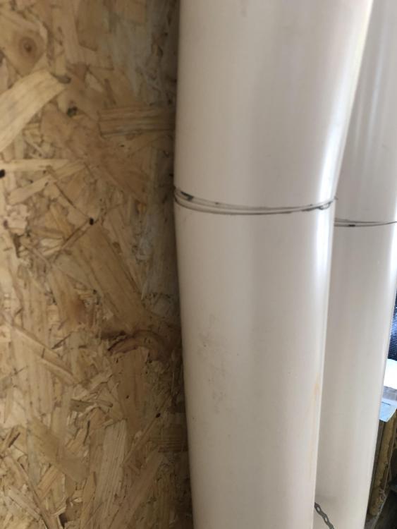

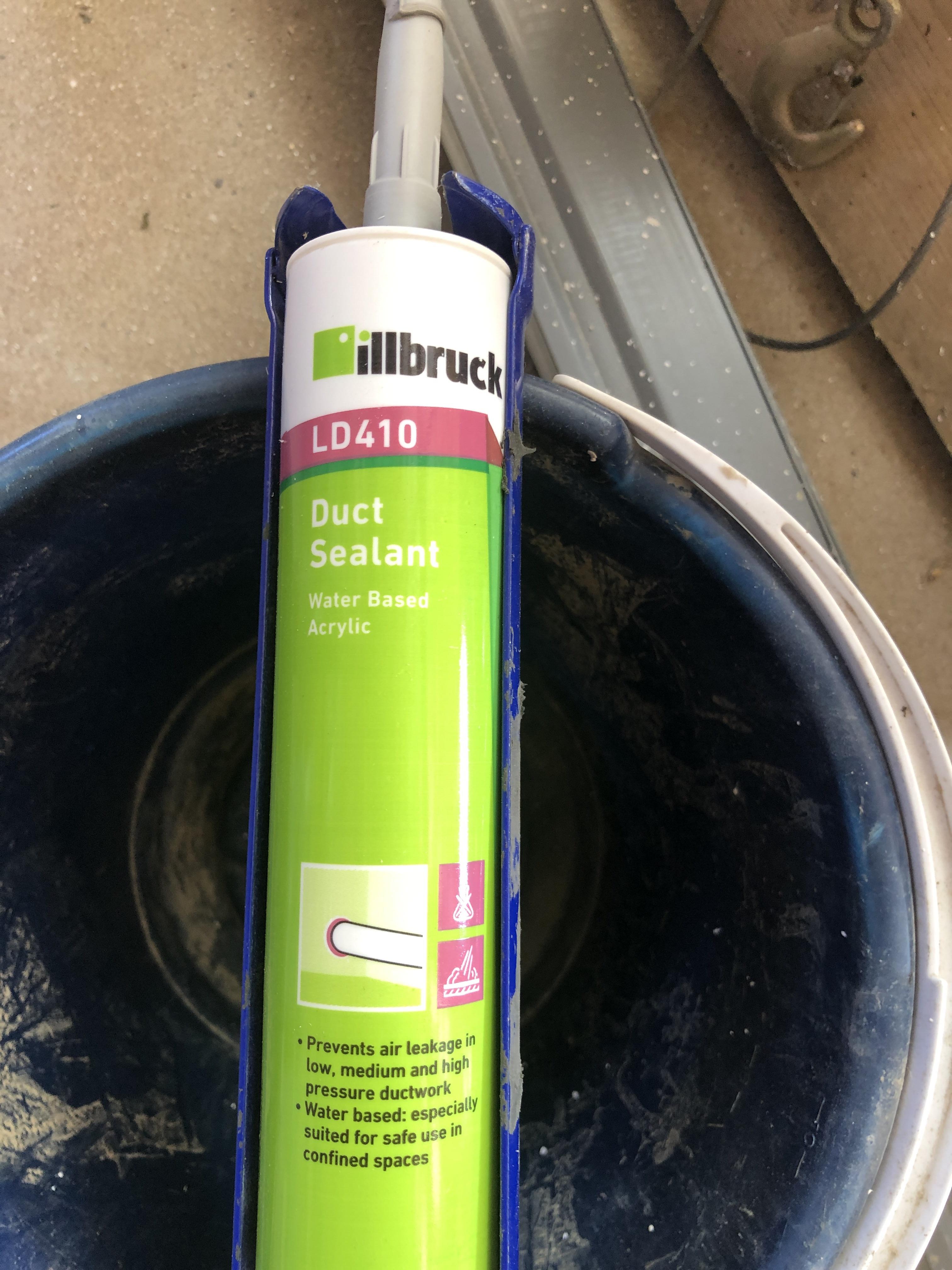

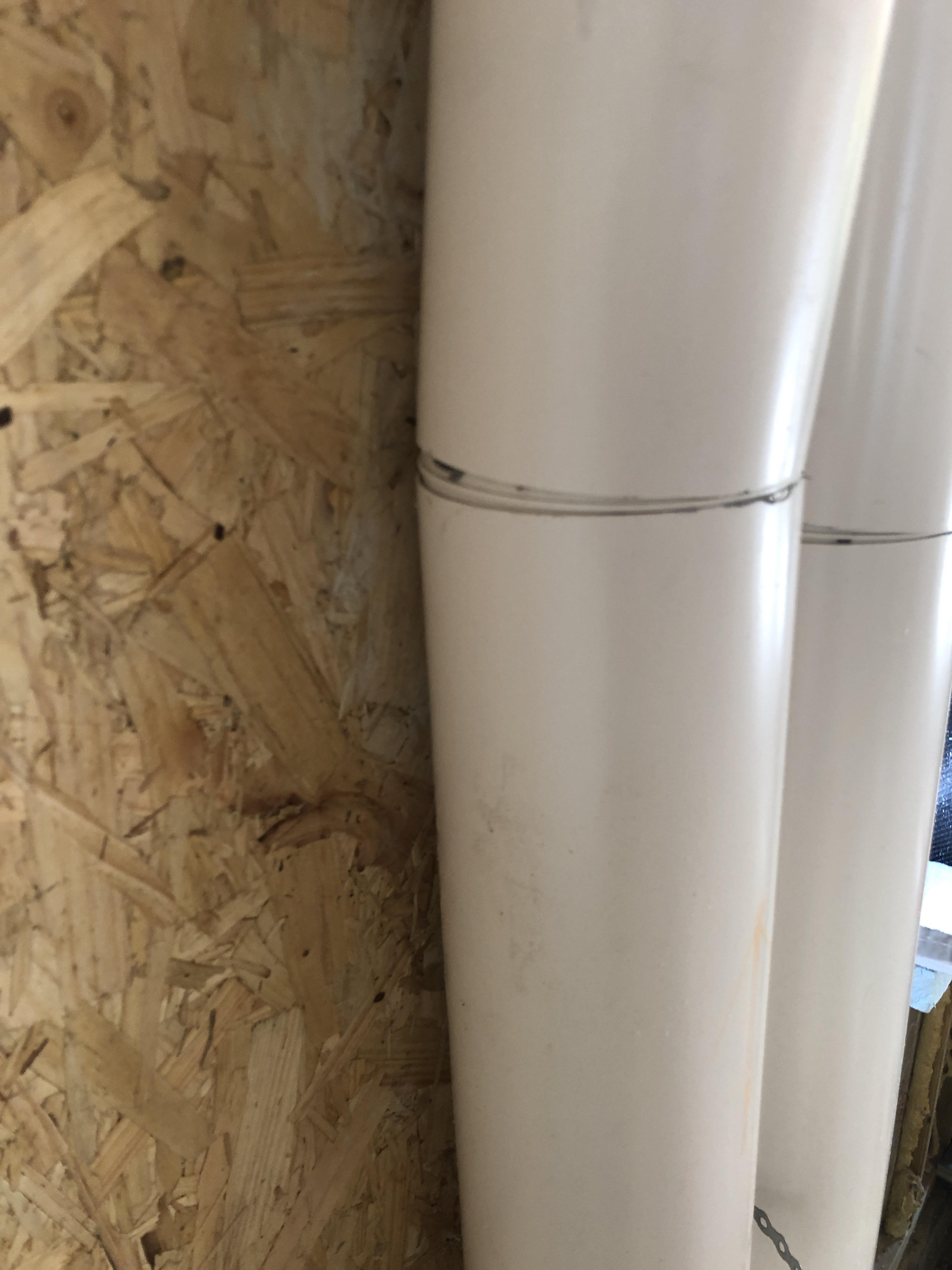

Pocster Posted September 17, 2019 Author Posted September 17, 2019 Anyone else have issues with the supplied duct seal ? . Doesn’t seem to hold joints together at all ! . Thought it would be like solvent weld but it’s not . Next day with the slightest bit of strain on the joint it comes apart ...
Pocster Posted September 17, 2019 Author Posted September 17, 2019 Hmmmm perhaps i’m Not meant to use this for connecting solid pipe . Not sure where i’m Meant to use it !
Pocster Posted September 17, 2019 Author Posted September 17, 2019 Ah bum ! Going to try some ct1 instead !
Mr Punter Posted September 17, 2019 Posted September 17, 2019 I like to tape around the outside as well with the foil tape.
Jeremy Harris Posted September 17, 2019 Posted September 17, 2019 34 minutes ago, Mr Punter said: I like to tape around the outside as well with the foil tape. Me too, in fact I've relied on duct tape to both join and seal all our sections of rigid duct. There's a good reason that duct tape is called duct tape...
jack Posted September 17, 2019 Posted September 17, 2019 If it's a sealant rather than an adhesive, it may not be intended to provide a mechanical joint.
Pocster Posted September 17, 2019 Author Posted September 17, 2019 Oh yes; I was going to foil tape all joints anyway. Rather make sure they aren't coming apart before I do that though... 1
Pocster Posted September 17, 2019 Author Posted September 17, 2019 BPC say that the duct seal stuff remains plyable for a few days before setting. I'll keep to CT1 for now.
Oz07 Posted September 18, 2019 Posted September 18, 2019 Surely ct1 is ott here. What about all purpose silicone
Pocster Posted September 18, 2019 Author Posted September 18, 2019 1 hour ago, Oz07 said: Surely ct1 is ott here. What about all purpose silicone Just what I had lying around
Pocster Posted September 18, 2019 Author Posted September 18, 2019 Well ! Its going in ! . Solid pipe is a right pain.

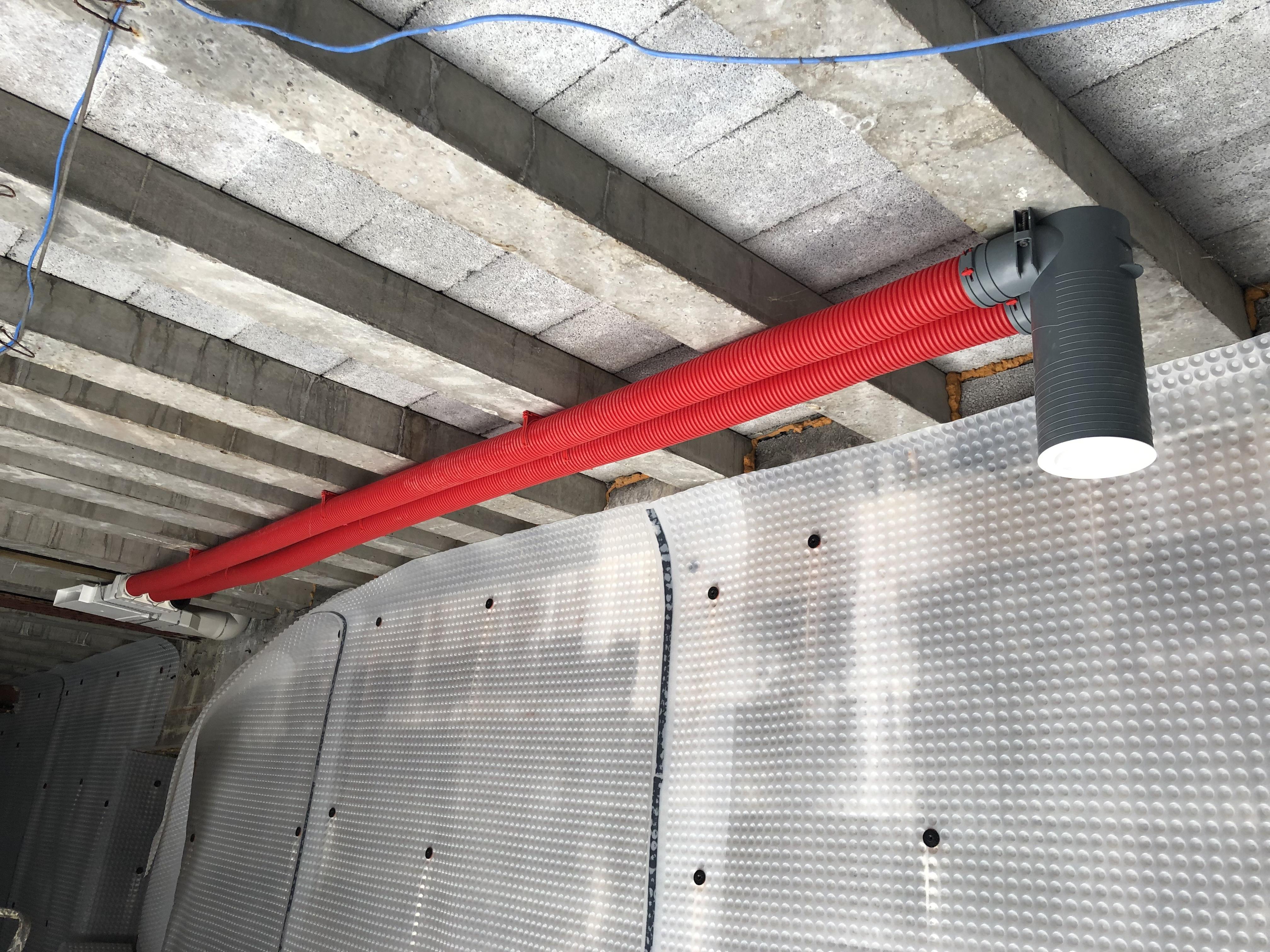

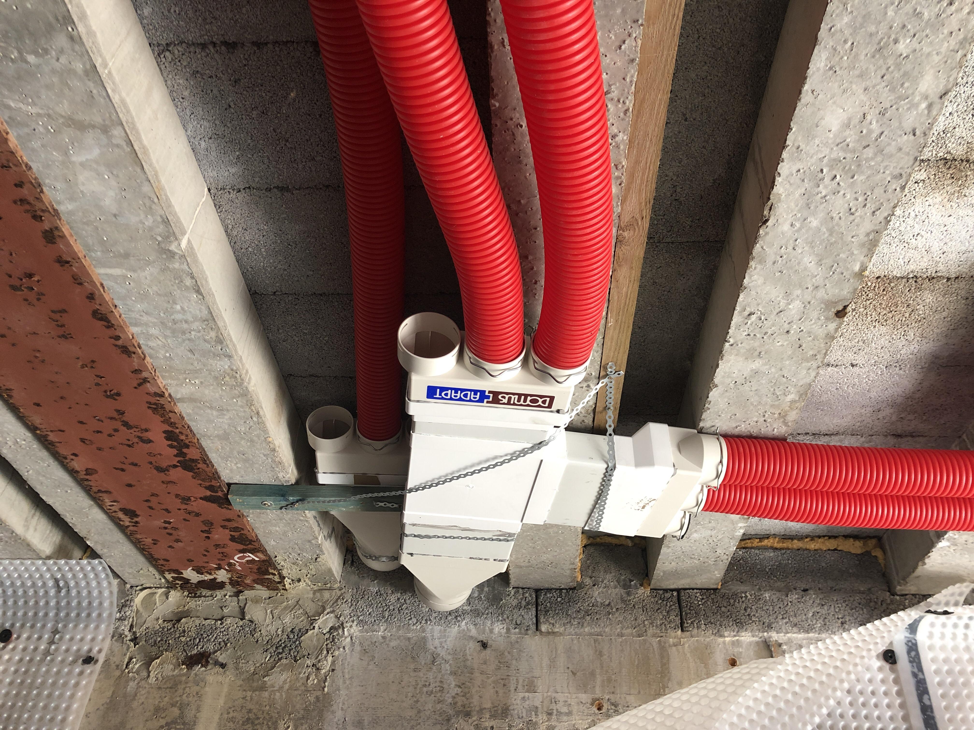

Pocster Posted September 19, 2019 Author Posted September 19, 2019 Below ground ducting complete . Think i’ll Add more support to some of the pipes . The fixing clips don’t seem especially strong . Ground floor now - should be easier . Tricky doing long pipes on your own as I have no friends ??
