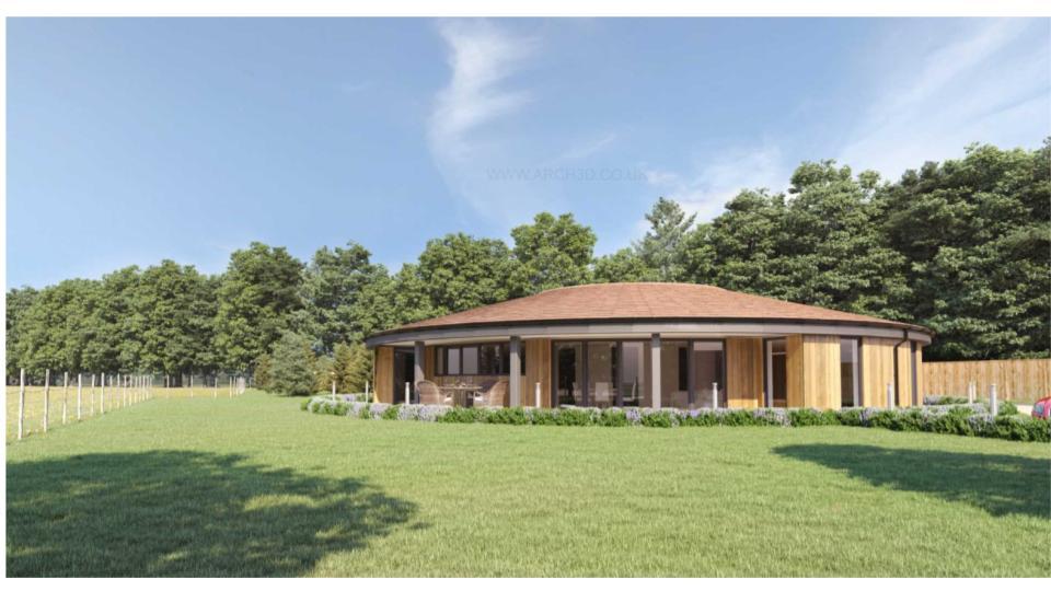

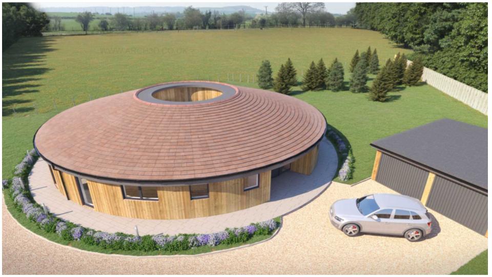

romario Posted June 11, 2019 Author Share Posted June 11, 2019 Thank you for your comments. Peter, You are right, first time I came across Ytong blocks was at MKM branch. Russell, I am building a 20m diameter roundouse so I will be using the mortar to get the round shape so unfortunately I can't use the thin joint system. Mr Punter, I agree that Thermalite and Celcon are most widely available and I was firstly looking at them but when I came across Ytong it looked more attractive. However, I have no experience with Ytong and that's why I thought I will put the question here. Yes, there is no cavity wall. I've decided to go for 215mm solid wall block construction with external insulation and cladding. The reasons behind are to have good thermal mass inside and option to add more insulation on the external side. I've added couple photos below. 1 Link to comment Share on other sites More sharing options...

Russell griffiths Posted July 11, 2019 Share Posted July 11, 2019 How are you going to get blocks to sit nicely in that radius. Would you not be better with a shorter block, brick so it follows the radius better, it will be awfully notchy otherwise and a major pain to fit your external insulation. Are you dead dead set on this method. Link to comment Share on other sites More sharing options...
Russell griffiths Posted July 11, 2019 Share Posted July 11, 2019 I love the house design by the way, I’m just not sure 440mm blocks will follow your 10m radius very well, have you thought of icf. Link to comment Share on other sites More sharing options...
Declan52 Posted July 11, 2019 Share Posted July 11, 2019 You have to cut each block in half to get a curve anywhere near decent. Which is very time consuming. Building a radius with blocks can't be done with a line so having to cut each block plus build free hand you will be paying a massive premium to build in that shape. Then as @Russell griffiths also says how are you going to bend enough insulation around that shape so you get it to passiv standards. Link to comment Share on other sites More sharing options...
