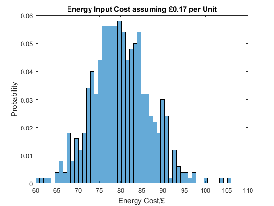

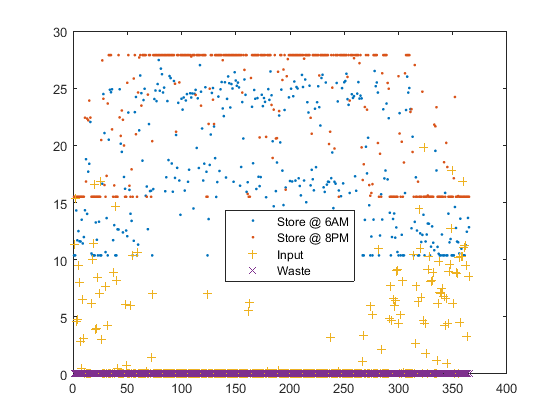

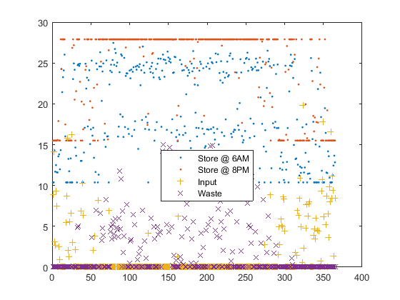

    Early in my career I spent several years modelling the underwater plunge behaviour of air launched torpedoes, to try and predict the 3D underwater trajectory for the short time between water entry and

40 minutes ago, JSHarris said:
Modelling is great fun (I spent months doing it...), but ultimately there are lots of parameters that are not easy to fully model.
Isn't that the truth!
I have spent the last 15 years doing mathematical modelling work (amongst other things) in the defence industry. Different subject matter but always the same question of finding the best thing.
Early in my career I spent several years modelling the underwater plunge behaviour of air launched torpedoes, to try and predict the 3D underwater trajectory for the short time between water entry and motor start up, so the range of attitudes, depth and velocities in all axes could be predicted (the aim was to inform the guidance control people of the sort of start up conditions they would have to deal with).  Back then we were coding in Fortran 77, using an ICL located 200 miles away, that compiled our code (transmitted via a 300 baud teleprinter link) overnight.  Each day started by going through the errors flagged in the printouts that had piled up overnight, before trying to fix the code and move on to the next section.
The best bit was validating the model, as that meant designing and building a pretty robust sensor and data logger (using 1/2" magnetic tape and missile data recorders) that we fitted inside dummy torpedoes that were released over as wide a range of drop conditions as we could manage.  It did mean I got to fly a lot, though, which led to a shift to a career in flight test.  To get the highest release speeds, we had to chuck the things out of a Canberra, doing around 400kts at maybe 150ft ASL.  Lots of fun...
I suspected you were involved in the industry somehow. My experience is mostly radars. I have been fortunate to sail a lot of miles with the RN and witnessed many missile firing trials to test the systems I have helped to build. It is as you say lots of fun.
I guessed you may have been a radar person, being where you are.  I was OiC of the ranges at DERA Funtington and DERA Fraser during the late 90's, when they were still a part of DERA Above Water Systems at Portsdown.

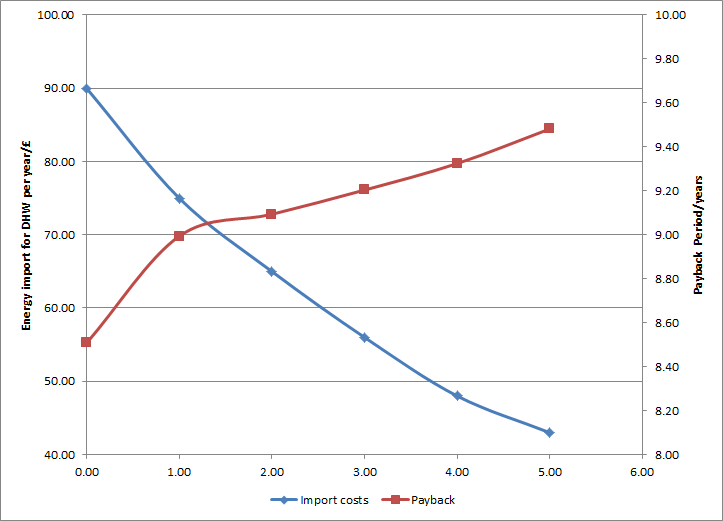

2 hours ago, dnb said:
I modelled the efficiency of these as 80% when the thermal store (or UVC - it makes no difference to the model) temperature is low, rolling off as an exponential decay as the store temperature increased according to [efficiency = nominal * exp(-tank_temperature/constant)]. I set up the constant to give an efficiency of approximately 25% at 60 deg C tank temperature.
The usual model is to assume a particular efficiency (η₀) at 0 °C temperature difference (between the water being heated and outside ambient) then a heat loss proportional to that temperature difference and the square of that temperature difference.
ΔT = water temperature - outside temperature (°C or K).
G = insolation in W/m².
Q = power output in watts = Gη₀ - α₁ΔT - α₂ΔT²
It's not just the curve that will be different with this model, the losses are also proportionally larger as the insolation drops. This makes sense, in the extreme case (like at night) the panels can actually lose heat.
A somewhat old blog post on the subject: https://edavies.me.uk/2012/01/pv-et-flat/

But hot water is a fairly a useful trick!  I take the point though - in the summer, the 9m^2 of ETs are not pulling their weight for much of the day, when their equivilent area of PV could be doing something useful like powering the A/C from my other thread. But of course only if the DHW is charged or it's more cost effective to heat the DHW over night with economy 7 (or whatever other base load incentive I might find)
I have come to the conclusion that I can make whatever system I install work and meet my DHW requirements, and all I am going to achieve is to get the last few percent of efficiency out of the system. It should be worth it though. I updated the model with Ed Davies suggested ET efficiency model and used the parameters from the Navitron system I was considering. It makes surprisingly little difference to the conclusions.
What I really need is a near infinite capacity thermal store that has next to no loss. Then I can average the energy across the seasons... So, a 10m^3 concrete cube buried deeply  ;)in the garden ought to do it. ;)
I got the first draft of the SAP calculations this afternoon. It will change a bit, I am sure, because some design details have been entered as guesses. It indicates the house will be annoyingly close to carbon negative, but won't quite achieve it. Still, it's a good A rating so nothing too bad for a first go at house building.
