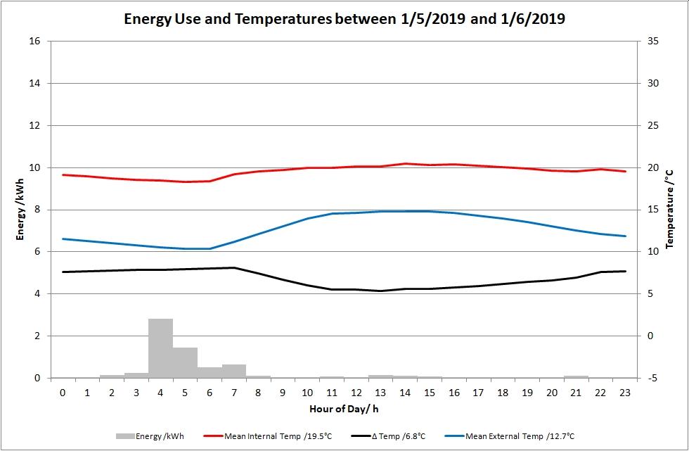

Not to be outdone on the charts, here is May's mean energy usage by hour.
I am usually up by 6AM, so water heating is between 1AM and then.  I have limited the E7 window so that it now starts at 4AM.

Part of the reason I limited my E7 window to the last 3 hours of the period was because I use most of my DHW first thing in the morning.

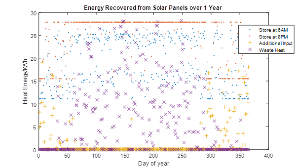

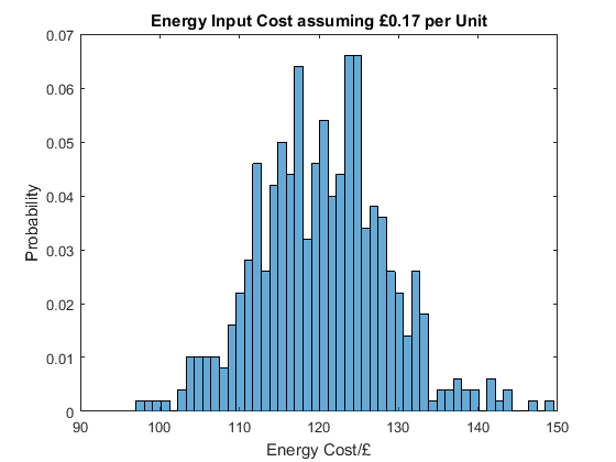

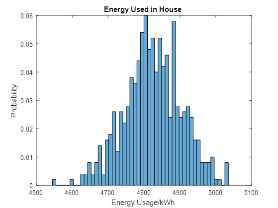

A bit more work using an updated version of my house DHW model:
I created 6 versions of the house, with various distributions of PV and ST areas on the roof and ran them in parallel for 500 years using randomly generated hot water usage (according to the model I described in the 1st post) and a model of daily solar availability based on recorded data.

Case 1 required the following yearly energy input costs from the grid (a simple histogram of all 500 years worth of data):
Case 2 energy input on the same scale:
As can be seen, case 2 requires less energy input, so is in theory is more efficient. But it is only £40/year on average, so when system costs are factored in, case 1 may be the best route. This cost data is available and will be presented later.
Now here are some specifics. I have taken one year from the data set and plotted internal data from the model for both cases. It concerns "filling" and "emptying" the tank with energy. The model assumes water is consumed just after 6AM and just after 8PM (It simplifies things nicely) and that once the tank is full the thermal energy can't be used. The PV might be used so I don't count it as waste, but it is not used further because it isn't doing anything for the DHW unless I make the modelled system more complex - and that's tomorrow's job.
Case 1
Case 2:
So on the one-of-one observation it seems the PV system generally wants more energy input throughout the year, but at a low level. Both systems can cope with demand fairly well, so if my model is to be believed, it is a case of finding the cheapest system to install that gives the fewest side effects to the rest of the house rather than DHW running costs.
Any thoughts?  Does the model look like it represents reality?
