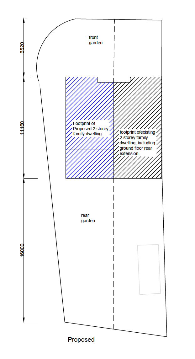

Pemu Posted June 8, 2019 Posted June 8, 2019 Morning everyone, I have made an offer on a piece of land subject to satisfactory sub-soil survey which I need to get done. I am keen on exploring the idea of adding a basement to the build and need to get a survey done that gives me sufficient information. Naturally, I want to save as much money as possible as well. I also want to have all the information I need to them get quotes, work out costs, etc., to then decide whether or not I want to build a basement. I've read posts where people have had to get a second survey and I want to avoid such costs. This is all new territory for me so any advice and information will be very helpful, including recommendations for good companies who serve the North London area. Questions that come to mind: To what depth do the samples need to be taken from? How many holes need to be dug and where? What details do I need to have included in the report? I'm sure there's more. The plot is at the end of a terrace so there's a pavement and then a road next to it. My goal is to include a basement under the main footprint of the house which is about 11 metres long and 6 metres wide. There will be a further 2.5 metres between that and the border of the property/pavement where I will try to get permission for a single story side extension separately. I'm attaching a picture of the outline of the property. Any other general advice for this stage will be helpful. Thanks

Conor Posted June 8, 2019 Posted June 8, 2019 The drawing shows the proposed dwelling being attached to the existing neighbouring dwelling? If you are considering a basement, proximity to existing buildings may be an issue, depending on soil conditions, your neighbour's attitude and planning policy regarding substructures. In regards to geotechnical investigations, you'll be wanting to drill bore holes to 50% beyond the bottom of the proposed basement. E.g 4.5m for single level basement. Geological Survey online maps will give you an idea of local ground conditions. They also have borehole logs, if luck you might find some that were done nearby. Basement construction costs start at approx double the going rate for ground level construction. E.g. if local rate is £2k/m², then budget £4k/m² for basement. Adverse ground conditions could potentially double or triple that number. We're doing a basement as well... But have advantage of a sloping site so will be a lot easier.

Pemu Posted June 8, 2019 Author Posted June 8, 2019 (edited) Thanks everyone so far. Some clarifications and some more questions: Yes, the existing landlord is splitting his garden and has also agreed to any party wall requirements, etc. The Thames Water report shows a 150mm waste pipe running through the middle of where the basement would be so I'm investigating costs and implications on that. I made a separate thread about that: Are there any other checks that you can think of which I should get done (e.g., for other underground services)? Is this the correct website for doing some background research and finding data from other boreholes? https://www.bgs.ac.uk/discoveringGeology/geologyOfBritain/viewer.html I haven't come across anyone else locally who has a basement so can't think of where to get a ballpark figure. @Ferdinand did you have anyone particular in mind from Milton Keynes or was there a reason you were suggesting looking there? Also, can anyone recommend any companies and companies for getting the survey done whom they have used themselves, heard good things about or would just be good yardstick for prices, etc.? Edited June 8, 2019 by Pemu
