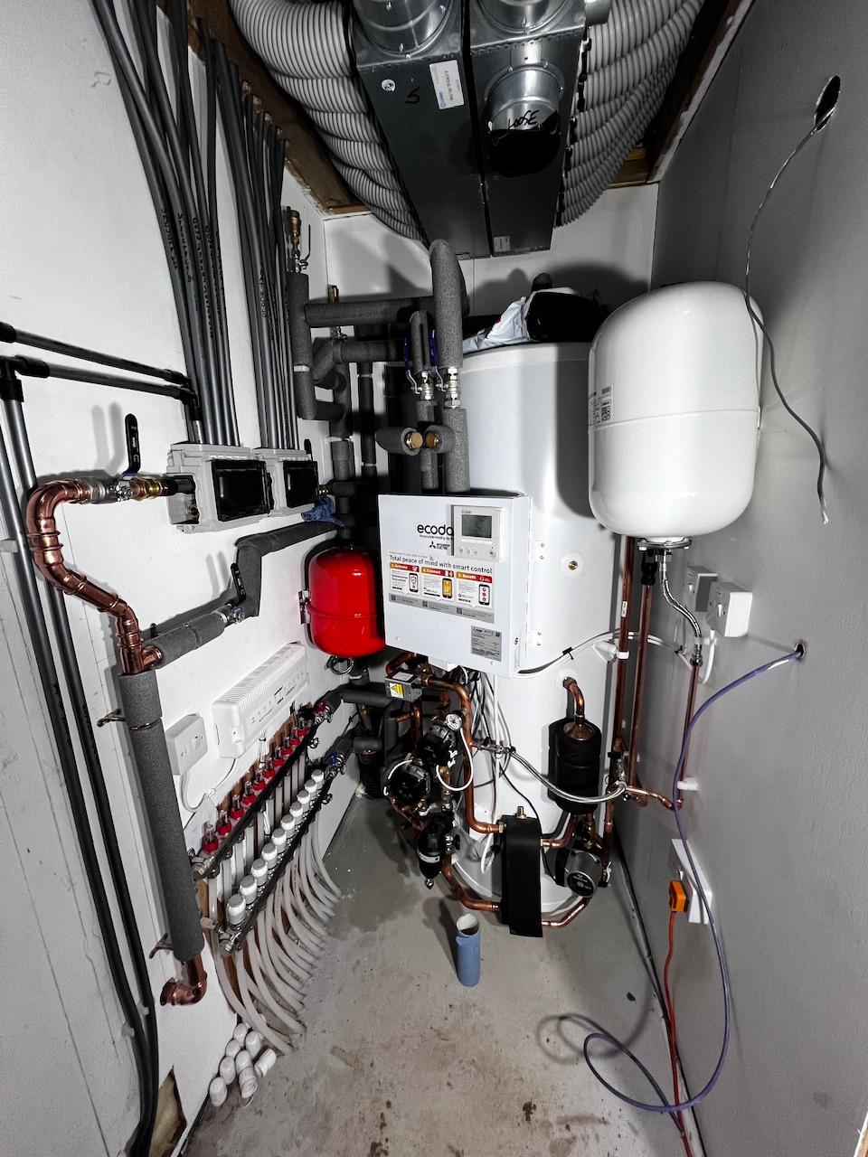

  12. The pipes and they way the joints are made are more robust than the other systems I looked at, you don’t need to worry about scratching the outside of the pipe when pulling through the building albeit I was still careful, the manifolds are very neat and I had limited space in the plant room. The pipe is less flexible than the Hep stuff so you need to be careful with how you route it as pushing it around other stuff isn’t easy so I put it in first.
  13. I used the Rehau smart manifold system. It wasn’t cheap and requires a couple of special tools to form the joints which the supplier hires out. Very happy with it. It’s very neat, the joints are good, the pipes are very robust. It’s very quick to install. Took a day to pull all the pipe through the house and connect to the manifold. I made one mistake and cut the pipes too short in the utility room so was unable to form them through the wall so I ended up having to make two joints in the wall.
