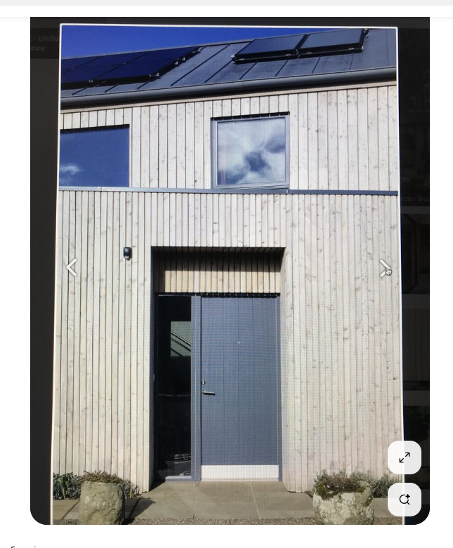

  2. Thanks. I wasn't aware of the acoustic transparency of the PIR. The one positive I do like of the SIP is around the fact that the cladding can then be flush in the vertical plane of the wall when it adjoins the lower floor brick exterior skin. Having the lower in brick / cavity / block and the upper block / cavity / block, means that the counter batten + cladding (~ 75mm thickness) will sit proud of the lower floor brick face. Aesthetically it doesn't quite look as nice. I don't think there is anyway to avoid that?
