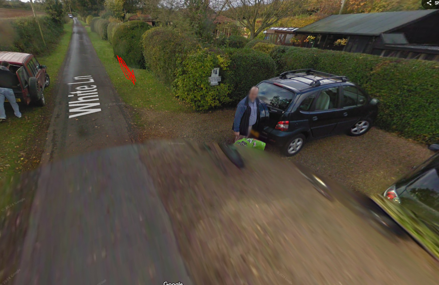

  11. The new entrance is as below. I have just calculated the distance from the road to the splay at the point we cross the neighbours boundary and it's 1.8m. Looking at the image below 1.8m is not possible.

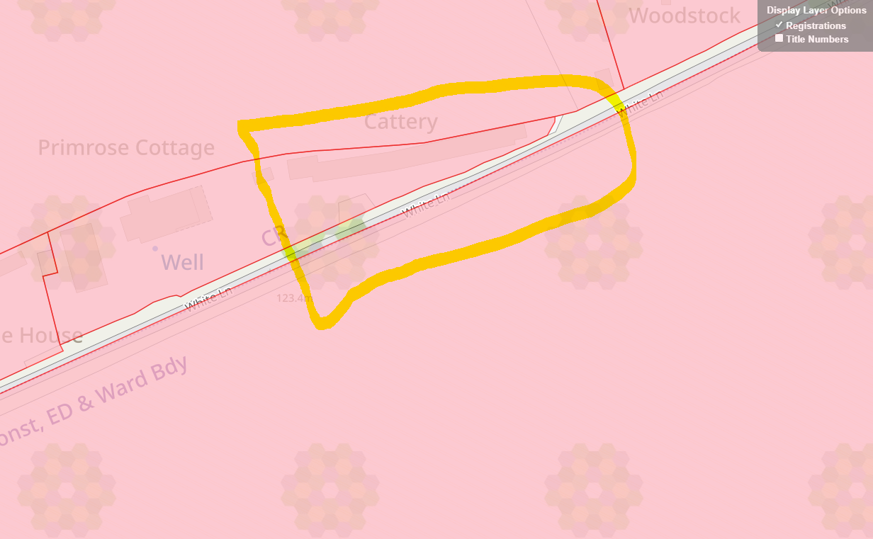

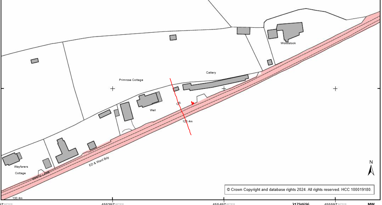

  13. I don't want the original access. Surely before embarking on a scheme for a client, they should have done the necessary due diligence to ensure access is viable? I did this yesterday and the result is below (glad I paid for the 20 day turnaround and not the express 5 day turnaround. Got the results in an hour and saved > £200). The tricky part is translating the splays across the area in pink to deduce whether the splays sit outside the pink. I suspect they do, given that you have to measure back 2.4m from the edge of the verge for where the splay starts. I can do some basic trig to work out the distance of the splay when we cross to the neighbours boundary.
  14. So I have purchased the report and it does show Hampshire CC do own the section of verge. I sent the plan showing this to the architects to ask them whether the visibility splays do sit within the HCC owned map and none of the splay crosses land owned by the neighbour. A highway consultant (was very helpful) informed me that so long as the visibility splay sits within HCC owned land, then any hedging that sits within that can be ordered to be cut back via a enforcement notice. This then means that we don't have to worry about the condition as it can always be resolved, where as the visibility splay crossing the neighbours land / hedge is outside our control. I am also requesting the architects raise the issue of the visibility splay being requested to the edge of the carriageway, as it is an unclassified road which is only 7ft wide, so definitely single lane. This apparently means the visibility splay is taken to the centre of the carriageway and not the edge. I have told the architects to push to have the condition removed.

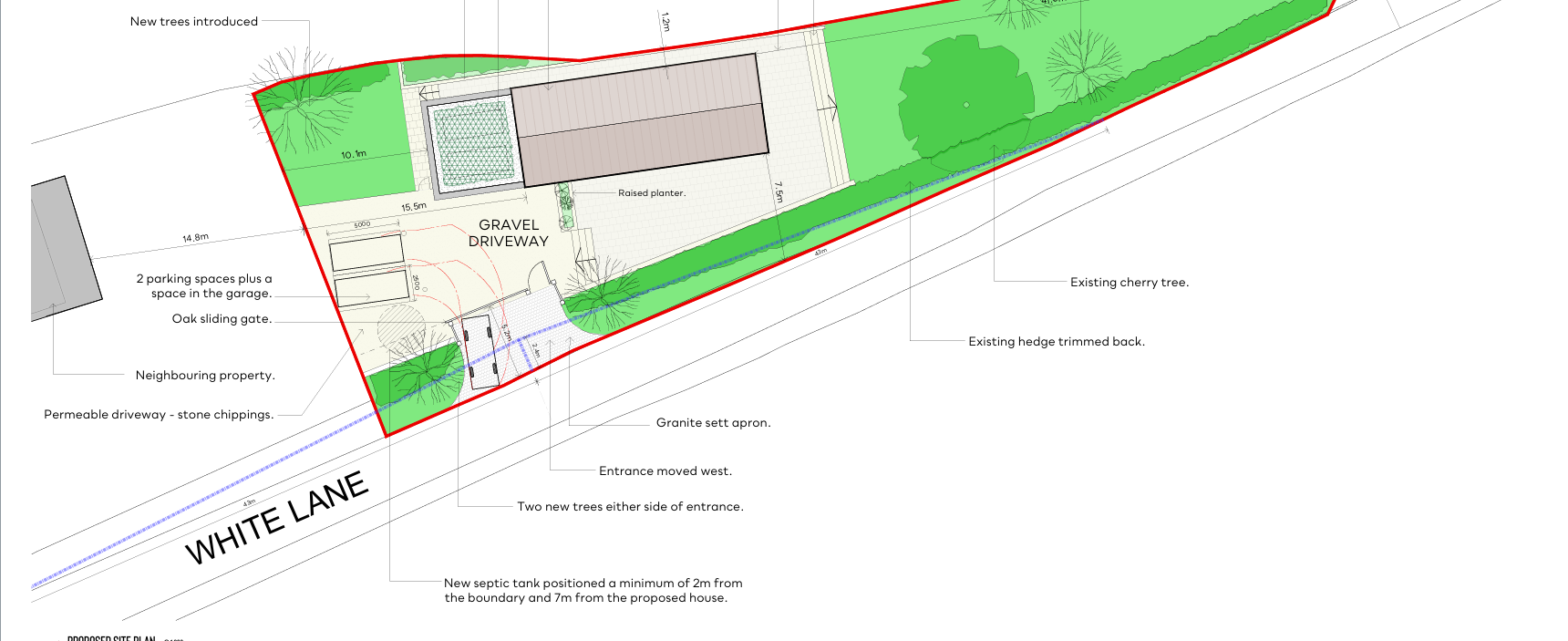

  17. The plot already has granted PP and the access for that application is shown on the second image. The access already exists and was the entrance to the old cattery business. As to the boundary not going to the road edge. Our solicitor never flagged that. I just checked on Land Registry and it appears to not be owned by anybody and I think it must be owned by the council. This would have come up in searches if there had been an issue with access and ransom strips. As no development has happened on the lane in 40 years or more, there won't be any chance of finding anything which might help the case. Worst case scenario, we will have to leave the access where it is.
  18. But a quick look on land registry suggests the boundary is not up to the road. Where as on the south side the farmer seems to own half of the road as well. This could be a land registry display issue.

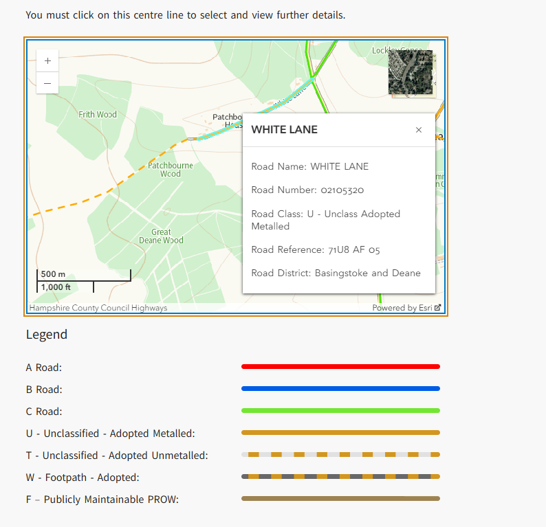

  21. So I have just manged to find out it's classification
  22. I am not sure if it is classified. How can I tell? It's a no through lane, that does have a council named sign at the entrance, so I assume it is.

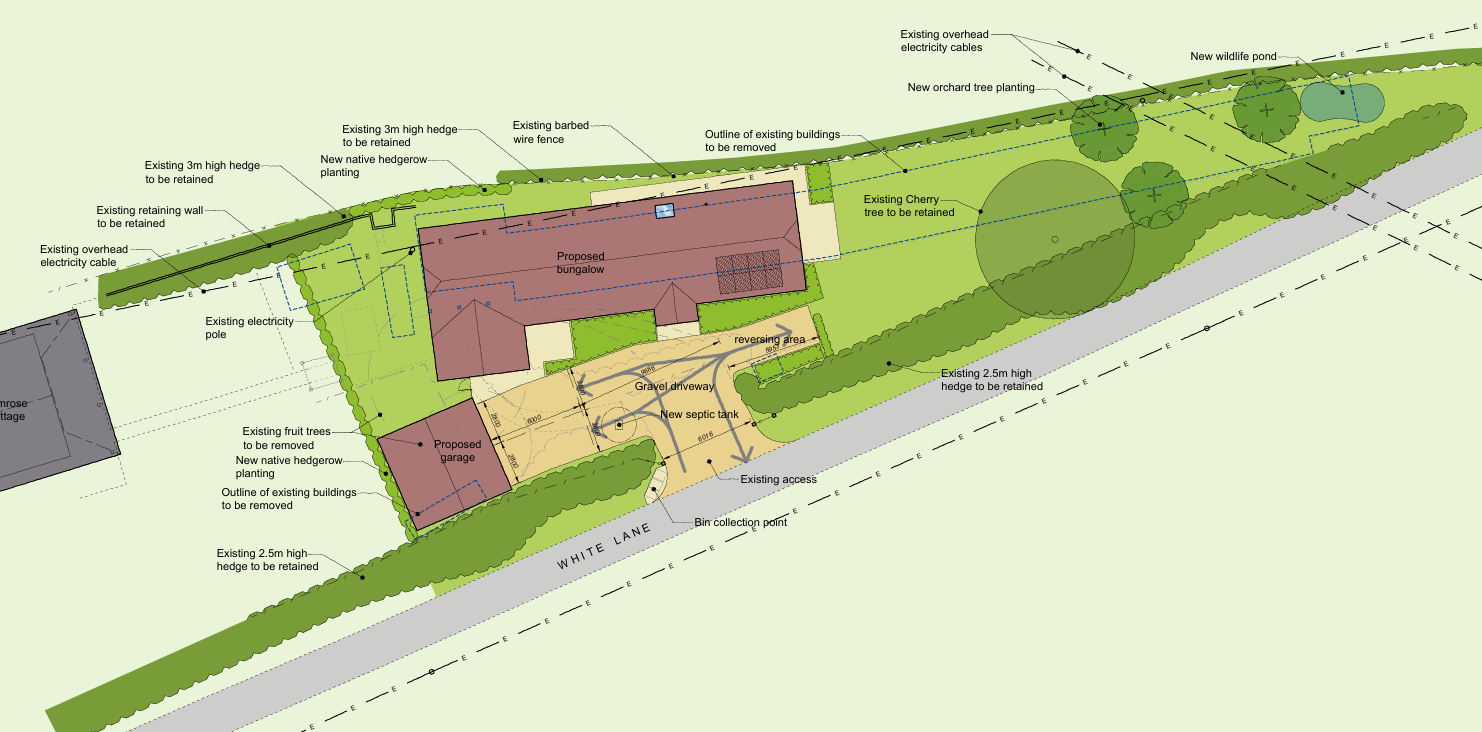

  23. Just to add. This is what the architects have come back with. One would think that before designing a house and submitting the application with visibility splays considered. I feel that it's their screw up and they've seriously messed up. "This could be an issue.. The previous permission did not have this 1.0m high clear sight line requirement, but then the access was not moved west. To make the current scheme work we have to move the access west, which brings it nearer to next door, making the visibility splay to the west potentially harder to achieve. (that said the last consent also had a bin store blocking this view although I guess that may have been 1m high only.) To be sure this isn't a potential problem we need to know some measurements as to the extent of next doors hedge and whether it obscures our 43m visibility splay as you look right - from 2m back from the highway edge - from the centre point of our proposed new access. The photo below shows that there is some grass verge to help here, but we need to check whether this is sufficient to comply with the suggested condition. If it's not, the choices are to do nothing, accept the consent and assume it'll never be checked or challenged, or to instruct a qualified highway engineer to make a case that the new access, and what can be seen to the right is adequate for this very lightly used single carriageway lane. I can suggest a name in this connection if required. It would be helpful as a start, if you could plot some dimensions when you next visit to ascertain if we do have an issue to address here. Hope that makes sense."
  24. So the architects moved the proposed entrance of our house slightly westwards to that of the granted planning permission. As is clearly visible from the blue line, it cuts directly through the neighbours hedging and they won't agree to us removing said hedging to meet the condition that they have attached (see below). What is strange, is that the granted planning application shows the visibility splay to be nowhere near as wide as what highways have mandated this time. "Before the development is brought into use, the means of vehicular access to the site shall be constructed in accordance with the approved plan (Drg No.24-WLC-PA-10) and no structure, erection or planting exceeding 1.0m in height shall thereafter be placed within the visibility splays shown on the approved plans." The existing entrance is shown below and Highways didn't mandate any conditions (they did so a site visit), and they haven't this time. It's also a no through lane. I obviously don't want to build a house that cannot be lived in because the condition cannot be satisfied.
