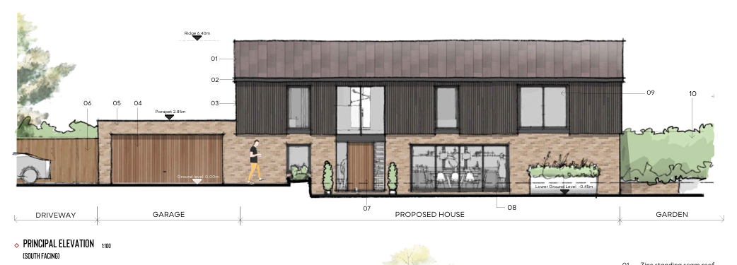

  18. Our proposed dwelling is as below (the steps down will be where the man is). The garage floor level is 400-450mm higher than the floor level in the house and I am trying to understand how to do the required excavation / concrete pour. I was not planning on using beam and block due to the spans. As a result, is it simply the case that the outer wall of the house that adjoins the garage will have to have some sort of tanking to stop damp or should I go beam and block in the garage so that the oversite is below the dpc level of the house?
