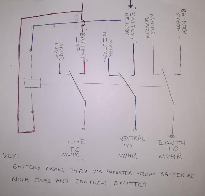

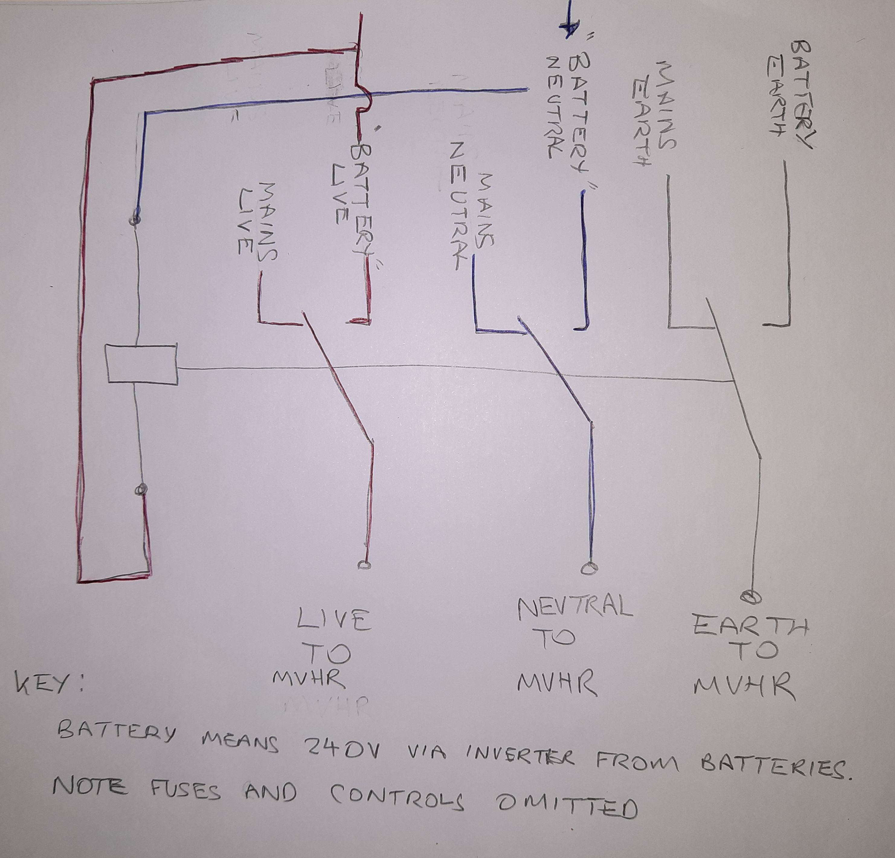

Yes we also have a "charger/inverter only system" which is not connected to the mains, which charges when there is excess PV and only discharges to 'mains unconnected' low power items in the house. When the batteries are discharged the relays disconnect the live neutral and earth from the battery system and connect the mains live neutral and earth. M

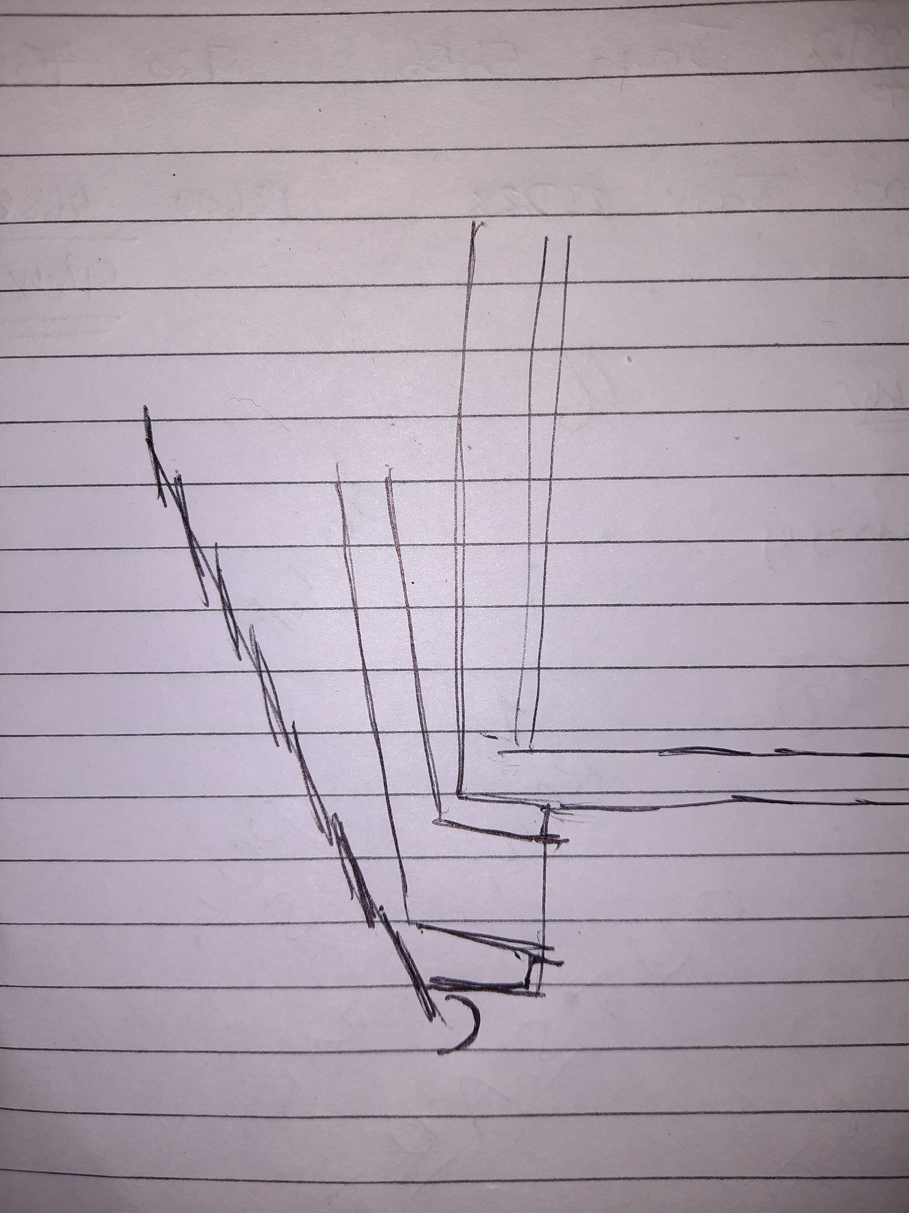

Hi @retrospective-build Yes. Pictures would help. I dropped ours through the soffit. If the pipework is outside the thermal envelope I would keep it as short as possible to avoid overheating the air in the summer and insulate like mad. I assume you know to keep the inlet outlet apart... -
