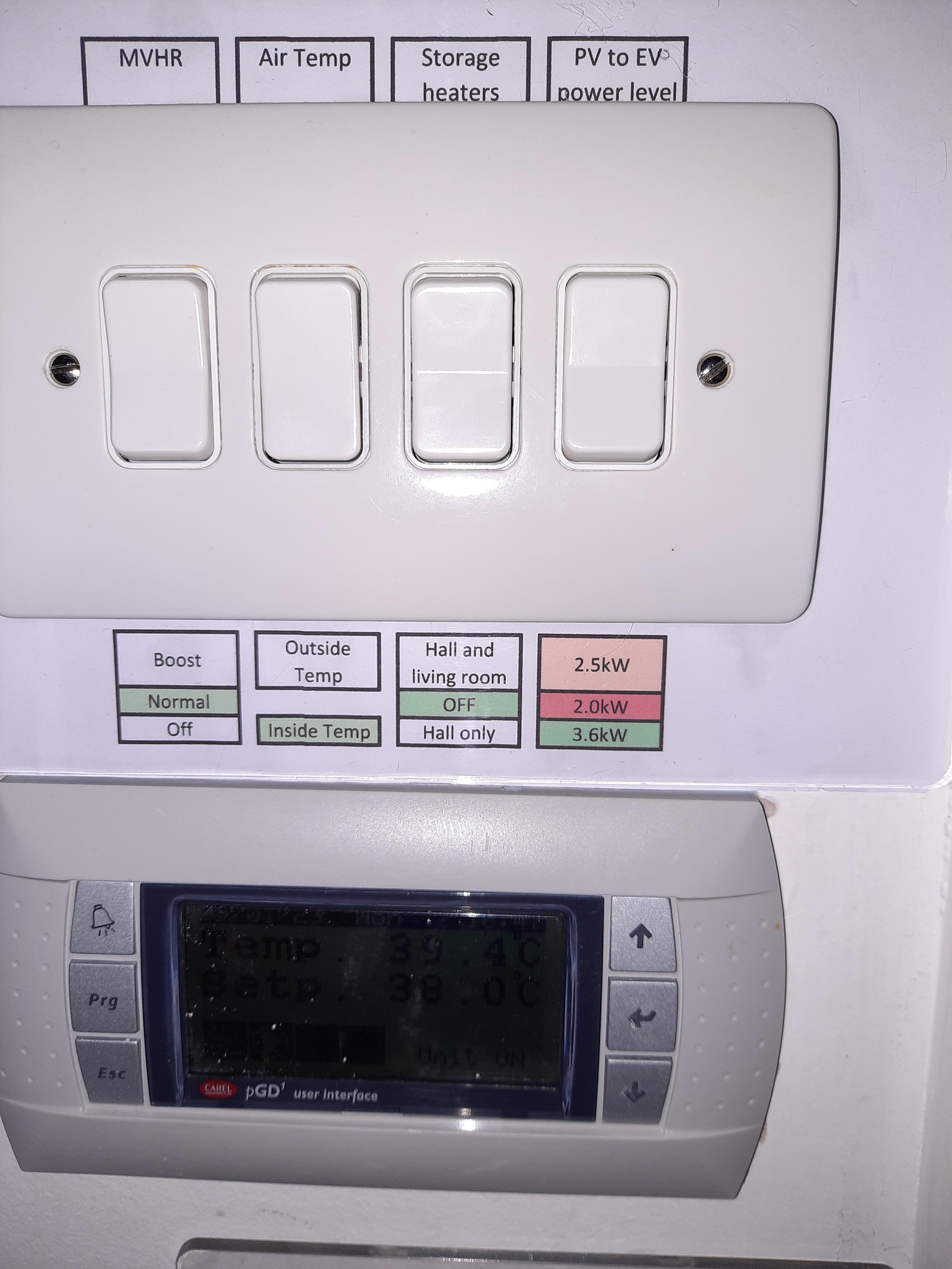

  2. The design is to protect the relays from over amperage. Actually today the tank was heated and some went in a storage heater.
  3. Yes I have trouble..
  4. Hi @ProDaveYes very complicated. Your quite right, I forgot to show the heater control switches.
