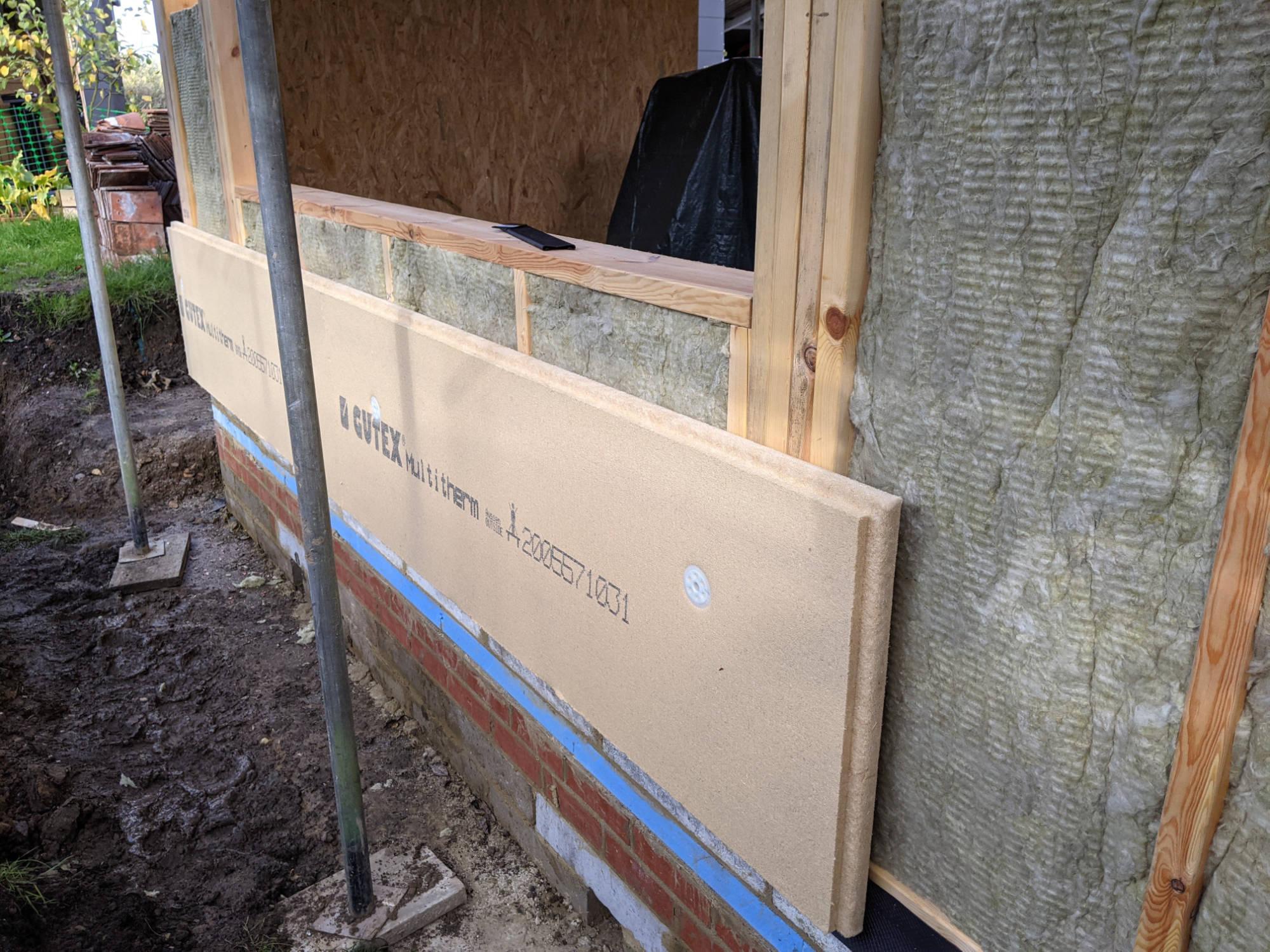

Hi, We've just today put the final fixing in for our wood fibre sheathing board on roof and wall. 60mm on the walls too. As you suggested, we've used the Ejotherm fixings to hold the sheathing board back to the timber frame. Typically a couple per board. We're now in the process of fixing back the vertical battens with Heco fixings (https://www.heco-schrauben.com/screws-accessories/screws/heco-topix/). 180mm perpendicular (straight in) and 200mm at 60 degrees (for suction and sheer). We ordered the insulation through Ecological Building Systems who organised a fixing plan from Heco. I think you can go direct though. The plan basically says where fixing centres are closer together (i.e. corners of the building). Whereas the middle of the long walls the spacings are much further apart saving on screws. Couldn't quite believe the cost of the them though..... Pic for good measure.... (every other batten done for now as I'm working through limited stock!) Cheers

@saveasteading - 140x38 stud. Lintels are 225x50 x3. OSB on the inside to give me a good working surface to VCL, service void/batten out. Gutex board is currently fixed in place with 2 or 3 thermally broken screws Ejotherm STRH, these aren't structural. On top of this will go the breather membrane tapped for windtightness. This is all held back to the timber frame with 38x50 treated battens using Heco screws (Heco provide a fixing design but they were ££££). Cladding on top. ?

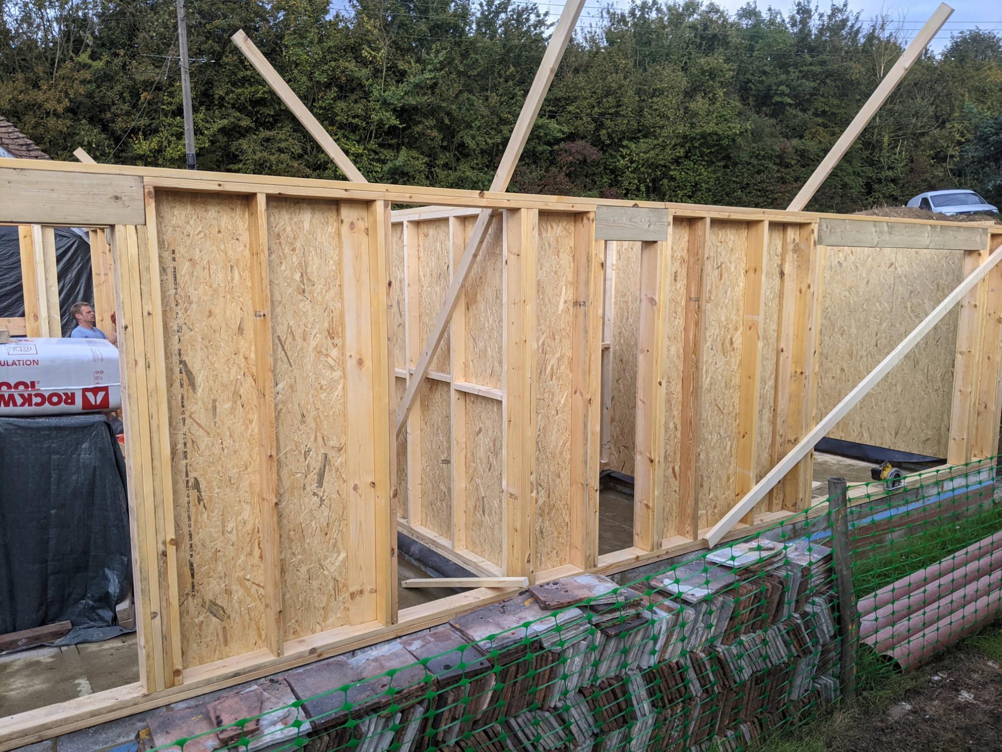

Hi. I can only echo the above - it's the similar route we have taken. Rockwool Flexi between studs and 60mm Wood Fibre board over. Ready for rainscreen cladding / weatherboard. Flexi infill is very simple. Push fit, no gaps and has reasonable heat storage capability. It was under half the price of a sheep's wool or wood fibre flexi batt. A bit itchy to work with but I was actually watching two others do it whilst I started the Wood Fibre. One thing many forget with infill insulation only is that you end up with so few gaps to actually fill up. See the pic attached and note the amount of triple studs and solid lintels.... BP

It begins! Got my eye in last night trimming the grooves from the bottom of 10 or so boards that will form the starting course. Makita 190mm circular saw with a 12t wood blade is like going through butter. No clogging up either. Feeling confident about trimming for window openings etc now. Cheers.
