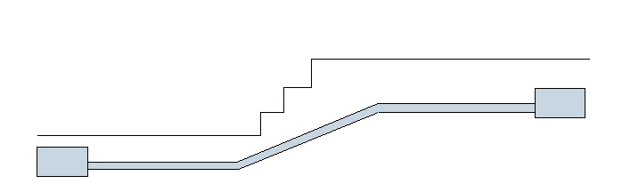

I did consider that but with a 600m drop the gradient would mean I'm too low at the soakaway end. I assume its not permissible to add a swept bend which would still be roddable? Something like this:
BTW: I wish there was another way! I hate manhole covers. I was trying to see if I could create a drop shaft but without a chamber but i've not found anything online that refers to it being possible? Theoretically I could get a rodding point into the face of the step?
This is at the 600mm level change. I assumed I need a drop shaft connection?

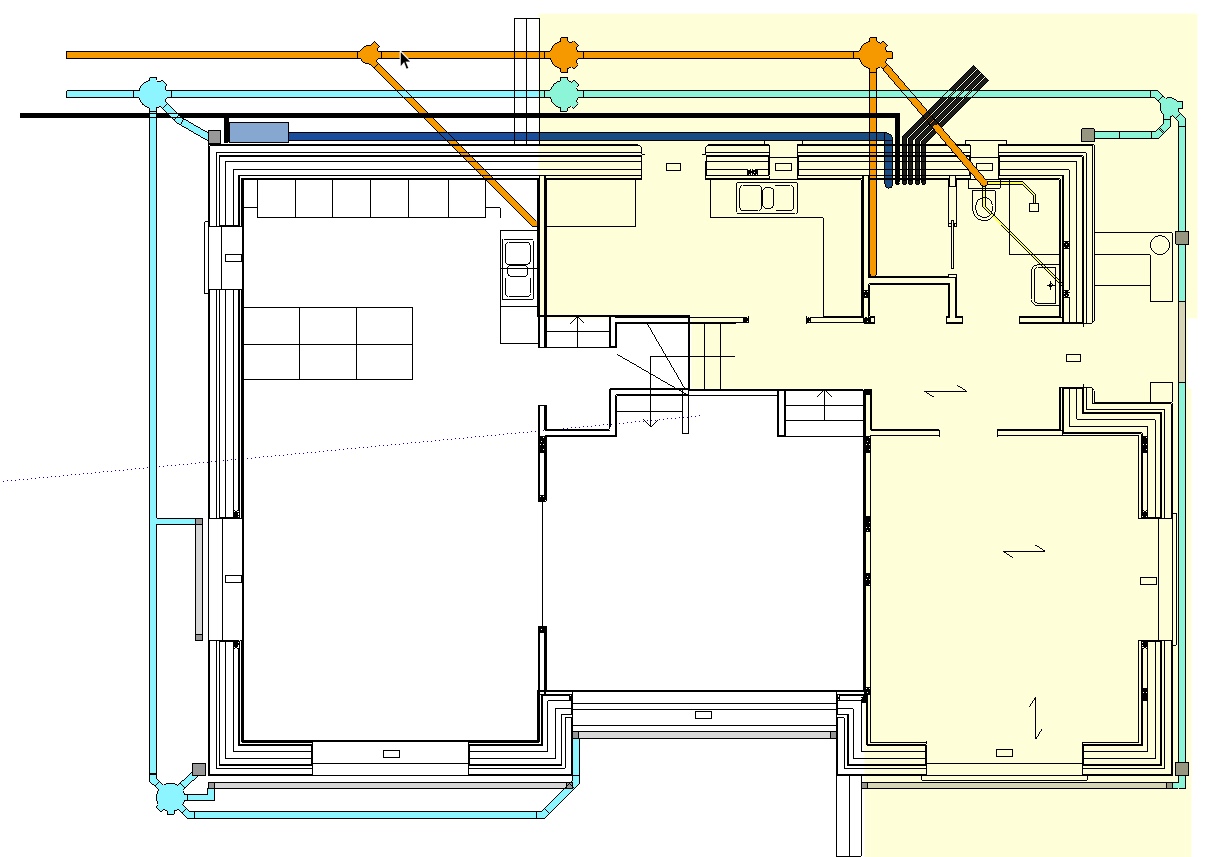

Thanks Ian. Really useful. I'll change the drawing.
This is broadly what I'm planning. Note that we have a level change in our slab and surrounding ground, the shaded yellow area is 600mm higher. I've had to pull the soil pipes further under the slab than I would have liked but this is due to the fact we have a 'cat slide' roof at the rear that drops to a single story. This makes the runs to the first floor a little more tricky (difficult to explain in 2d!). I've also added provision for brick slot drains in front of all the the low threshold doors. Orange: Foul Blue: Surface Black: Ducts for power, water etc. Blue: Insulated flow and return to ASHP.
Hi All Just finalising my groundworks jobs. I was interested in what people (especially those with a passive slab) have done about surface water drainage? Did you install all your pipe runs and gully's etc before the slab went down? Or after the slab? Or perhaps even only once the house was up? I can see pro's and cons for before and after.
