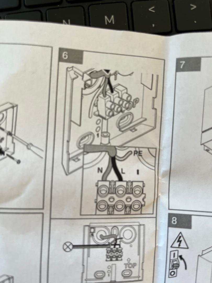

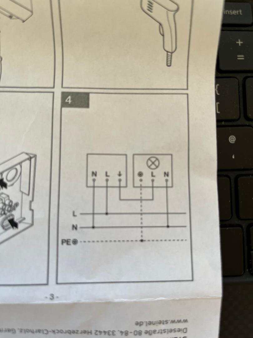

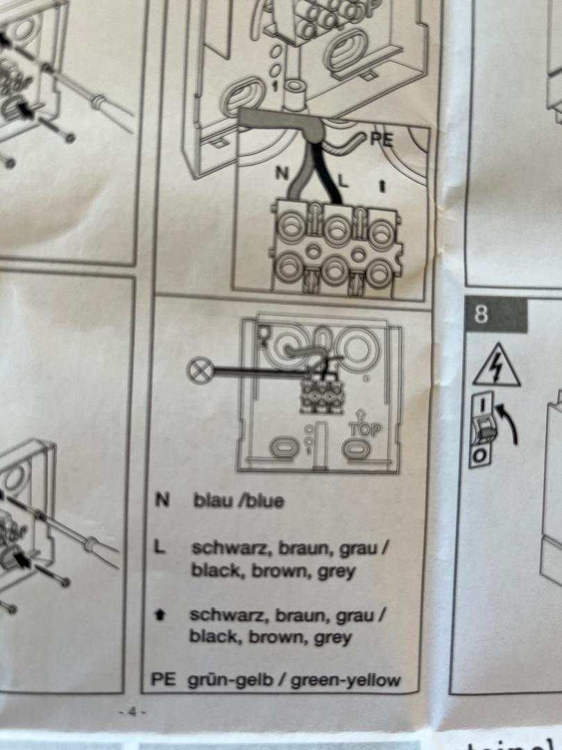

I've bought a Steinel sensor and am baffled by the instructions on wiring that come with it. I dont know if anyone else agrees but what are these meant to show - see photos. Maybe an electrician would understand the wiring diagram but I'm not one and the pictures dont seem to show what you are meant to do clearly. Can anyone - maybe @ProDave explain in simple terms how I wire this from the 3 core mains into it and then onwards to the low voltage driver for the led strip it is to operate? Thanks.

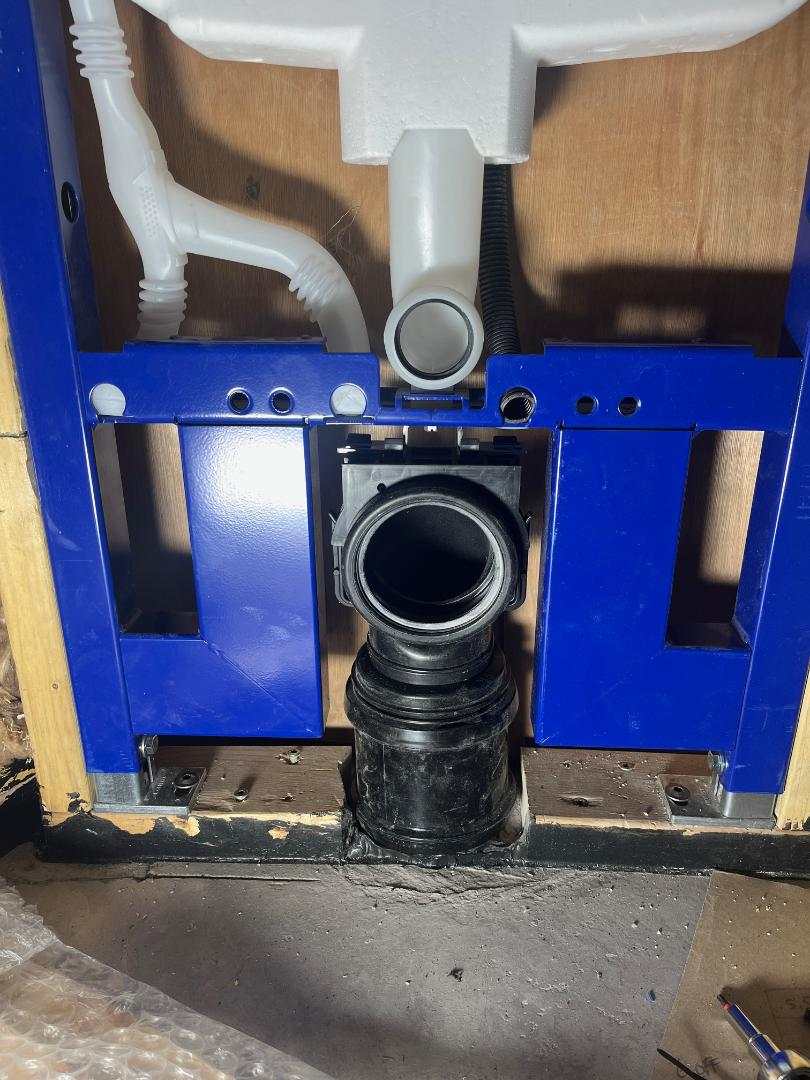

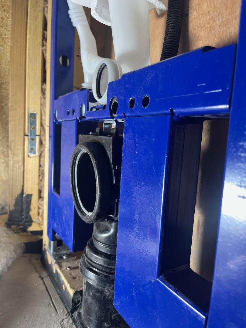

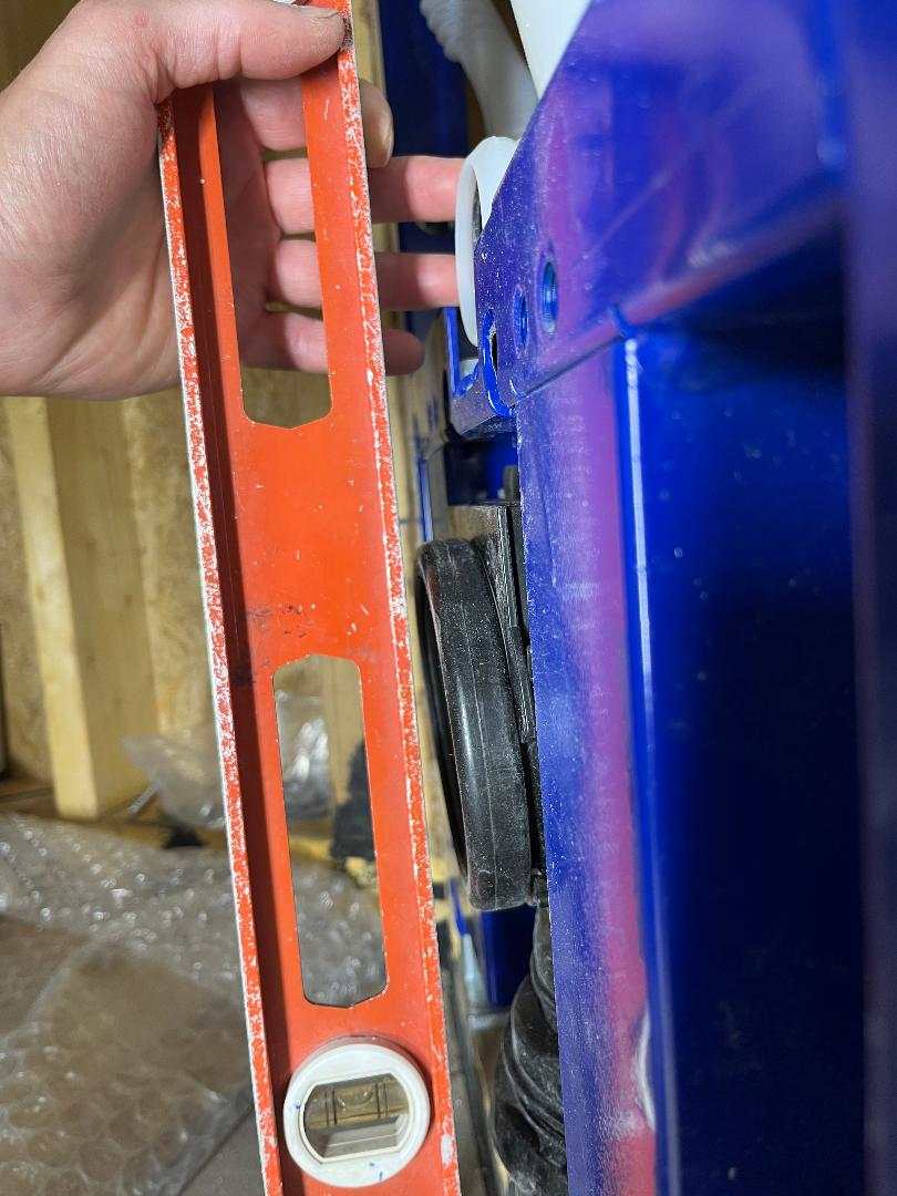

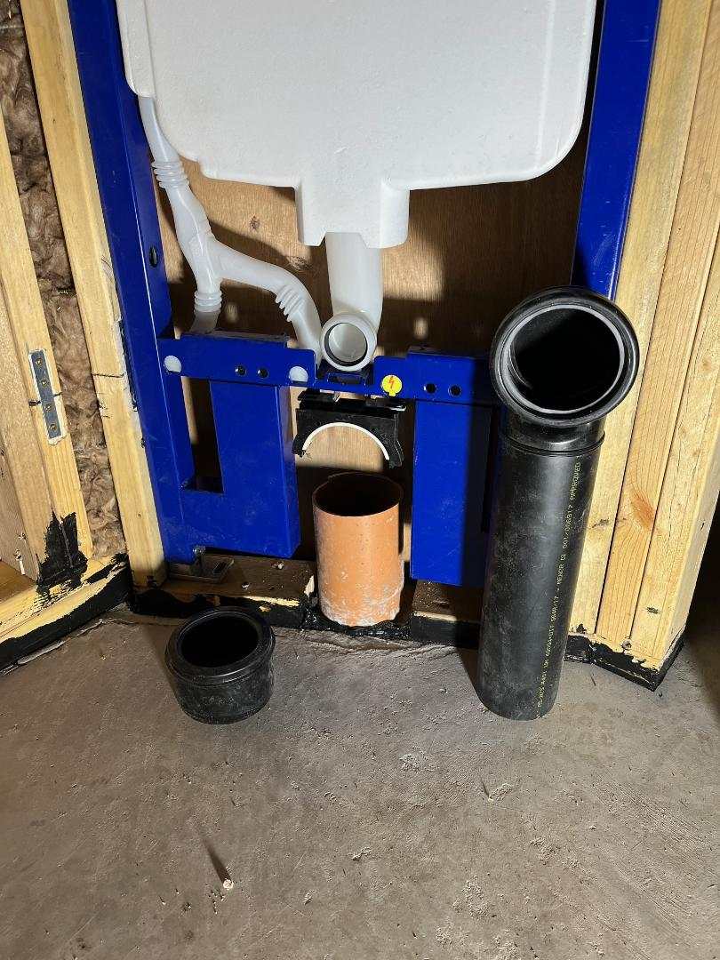

@Nickfromwales thats brilliant thanks that's just what I need. One reason I had thought against the double push fit was because there may be insufficient clearance between the brown waste and the plywood behind that you can see in the photo. But of course the solution is to do a cut out from the ply to increase any clearance needed as it will be boarded on the other side anyway. Excellent now just need to read up on fitting the Alba shower pan and fancy electronic flush plate and we will be good to go. M

I am about to have a go at fitting this frame. The kit comes with the black Geberit 90mm 90 degree bend section and a 110 - 90mm reducer. However annoyingly the reducer 110 end is too thick to slide inside the brown 110 waste pipe. So clearly I need to buy a 110 - 110 straight connector. I am looking for advice on the best part to buy. There are a couple of issues..... 1 Not much height - I will cut the brown waste lower in line with the wooden sole plate but even then I need space for the straight connector then the reducer then the final bend section 2 The brown soil pipe is slightly off perpendicular. Not by much but a bit. So ideally I am looking for a straight 110 - 110 then is low in height but has some flex? Would this Mcalpine part be a good solution? https://www.screwfix.com/p/mcalpine-push-fit-single-socket-drain-connector-black-110mm/4255V?gclsrc=aw.ds&gad_source=1&gclid=CjwKCAiAiaC-BhBEEiwAjY99qPfuSVvVOwOsuArr-2ZoG7XpOUrOIn_Cq0cUdHHYCpGmS8WOWeDXsxoC3OsQAvD_BwE&gclsrc=aw.ds I think this query has @Nickfromwales written all over it!!
Good to have your approval Nick!
