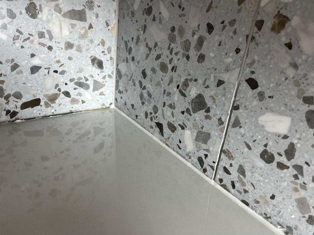

Shower enclosure leak - likely source?
markharro replied to markharro's topic in Bathrooms, Ensuites & Wetrooms
Actually one thing I have been wondering about. Before the tiles were put on the tiler recommended that we apply tile sealant solution as his view was that it was easier to do this before the tiles were on the wall. So that means that the sealer was on the tiles before the grouting was done and before the silicone was applied. Could that mean that the silicone would achieve a reduced "grip" on the tile edge against an unsealed tile? -

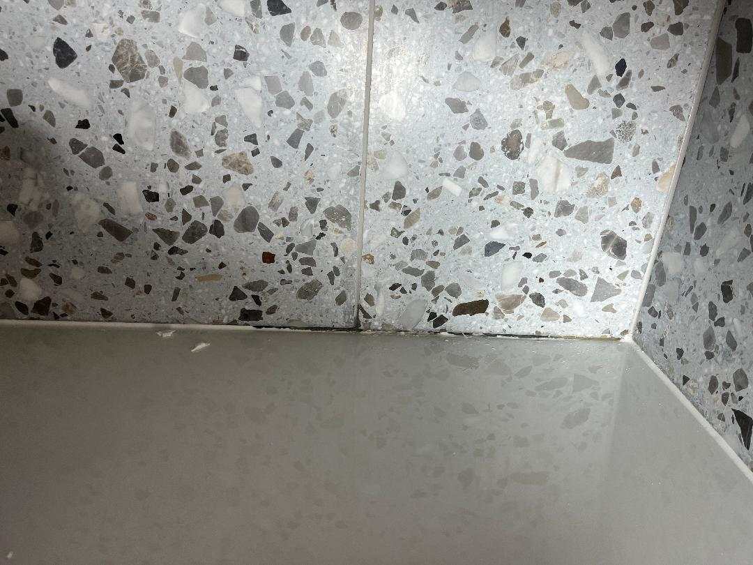

Thanks @Nickfromwales that it is really good advice as always. I don't think that we are going to have enough space to put in any CT1 but other than that we can follow your instructions. What is puzzling us is how this could have happened literally only a number of weeks after we finished the work. It is difficult to see the scale from the photo but the width of the shower is 900 mm to give some idea. You can see that my partner has applied really quite a narrow bead . Would you reckon that we are better with a much thicker bead at the bottom where the tiles meet the shower tray? Also, any tips on making sure that you get the optimum adhesion of the silicon to the tile and enamelled steel tray? -
Jeez some days you really do lose the will to live. After literally months getting this shower operational my partner noticed that about one inch of grout where one vertical grout line hits the shower tray was appearing permanently wet. We suspected that the silicone around the try was the culprit. She has now scrapped off the silicone to find the back of it is wet over quite a length!! would even a small breach in the silicone allow this to happen? She did the siliconing herself and I thought at the time that she had used a very narrow bead around the shower tray. Should we take it all out right around the tray and apply a thicker bead? @Nickfromwales what do you recommend to get the silicone out and to clean up before reapplying thanks
